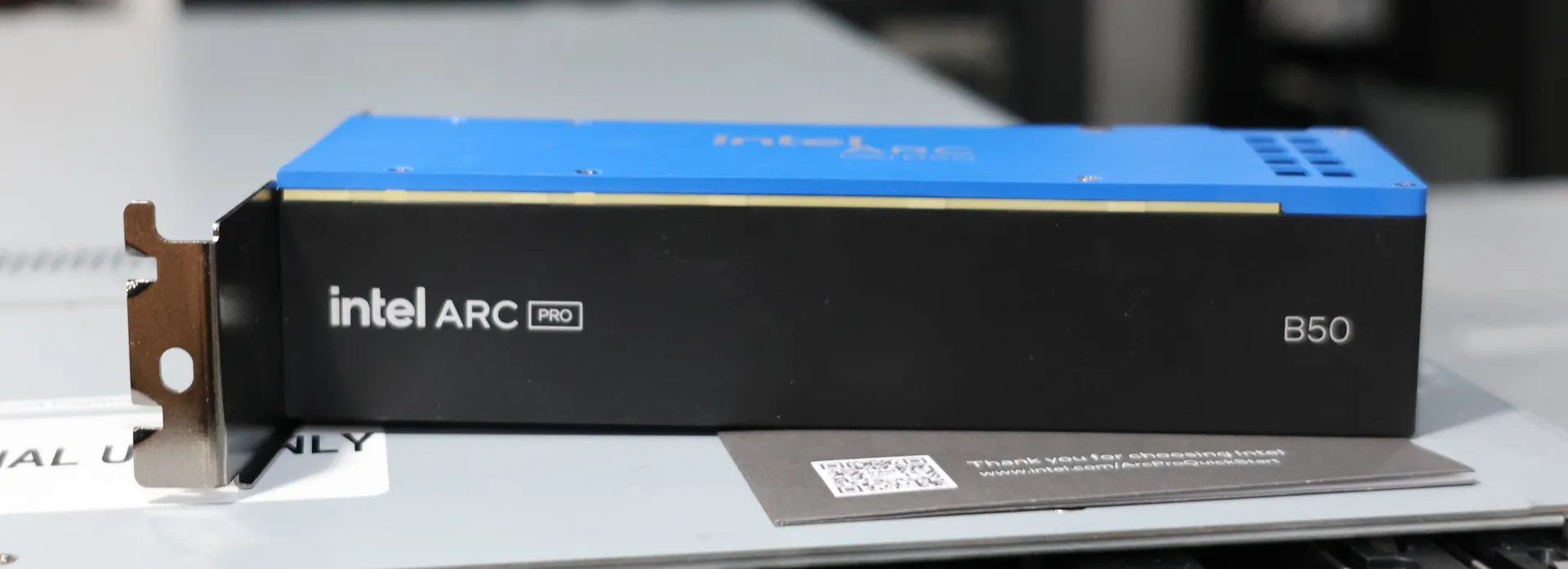

Proxmox 9.0 + Intel B50 SR-IOV -- finally its almost here! Early Adopter's Guide

I got a B50 and followed the guide. However I don’t have a windows machine to do that firmware update with. So I tried using a vfio pass-through. Unfortunately that seems to have bricked my B50 :frowning: as I cannot post anymore. Perhaps I did something wrong, but I bound the B50 to the vfio-pcie driver as you normally would.
I have a second B50, but I would really like to avoid to brick that one too. What should I do?
So the whole system doesn’t post anymore? Is that with the B50 as the only GPU, the main GPU, or as a secondary GPU? Perhaps you could still post if another GPU is present and the primary one… That could give you a chance to unbrick later on.
How exactly did you do the update (as a warning to others)? Any error messages or crashes? Does event viewer show anything (if you can get into the windows VM with a different GPU or the QEMU one)?
Some (including me) did the upgrade on the passed through GPU and it worked fine, but it obviously it’s the riskier option…
Probably I’d try to get my hands on a windows system to flash the other one, either quickly install windows on a spare SSD or see if you can borrow a system somewhere?
Well I just passed through the card as you would any other. The driver seemed to install fine and it worked in the windows VM until I rebooted the proxmox host, to try and setup SR-IOV with the new firmware.
I have verified that it is the B50 that causes the system to not post anymore no matter what GPU is inserted alongside the B50. Removing it fixes the issue. I have tried every available PCI-e slot too, so that is also not the reason. I think the card genuinely bricked itself in some odd way.
I don’t really know anyone with a desktop windows machine, as they either have a laptop or aren’t using Windows as their OS. I guess I can’t install the firmware without windows then.
I wish they would allow us to just flash the firmware separately man. I bricked one of my cards because of this crap, I am a little irritated by that I have to admit.
Any tips on how I can make minimise the risk when flashing it with a pass-through? Like perhaps I passed through the card incorrectly?
