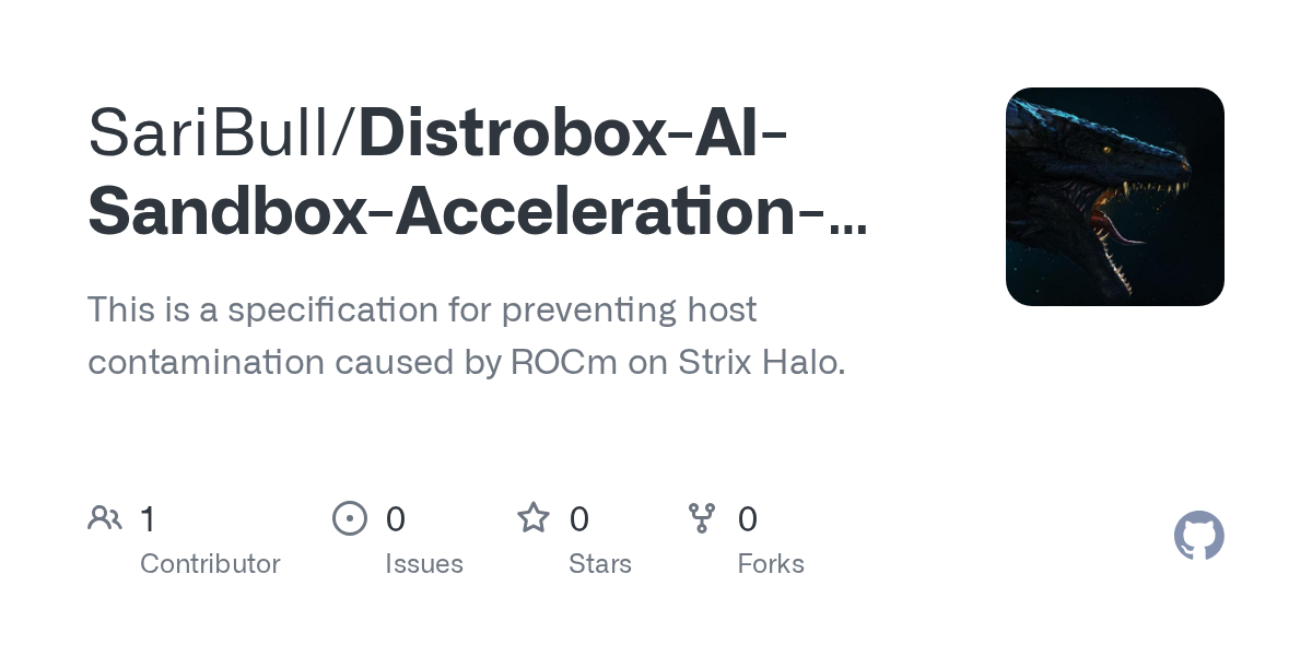

Hi all,
Got tired of seeing local LLM toolchains, agent dependencies, and scattered Python/Node environments pollute the host OS. Also wanted an architecture that doesn’t rely on cloud API black boxes or vendor-locked SaaS.
I put together a provisioning specification focused on a strict “Zero-Pollution” workflow for running local LLMs, Open WebUI, and dev agents inside isolated rootless containers while maintaining direct GPU acceleration.
Core Architecture & Hardening:
  • Host Integrity: Host OS remains strictly clean. All runtimes, toolchains, and agents are encapsulated within dedicated container volumes.
  • Hardware Passthrough: Direct mapping of /dev/kfd and /dev/dri for bare-metal AMD/ROCm acceleration without host-level driver breakage.
  • Rootless & Daemonized: Managed via rootless Podman compose / systemd user services (loginctl enable-linger) for persistent, automated multi-container orchestration.
  • Isolated Storage: Ephemeral runtimes mapped to dedicated named volumes with explicit SELinux (:Z) boundaries.
Initial prototype started around Distrobox, but has evolved toward fully locked-down native OCI/Podman specifications for air-gapped and headless appliance setups.
Published the initial specification and compose templates to GitHub:
Curious to hear thoughts from anyone running isolated bare-metal AI workflows or hardening rootless container pipelines on Fedora/RHEL.
