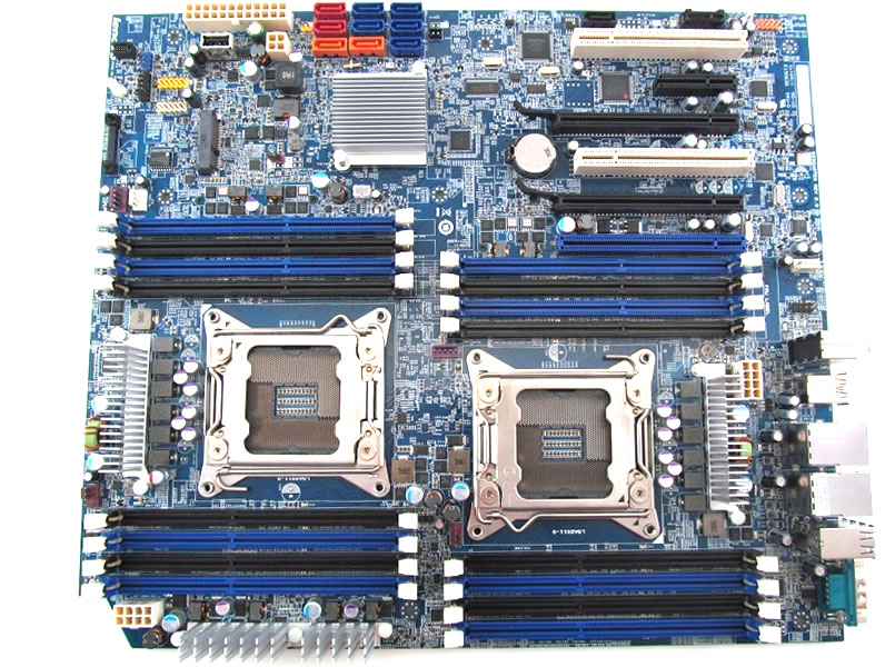

I’ve got a couple of decommissioned Lenovo C30s from work, and they’re surprisingly awesome machines. Dual socket Xeons, up to 256GB ECC DDR3, like 8 SATA ports, mSATA, dual GPU support, USB3, pretty good workstations for being free dumpster scores.
The issue is the cases suck. They are bad quality, bad design, bad in pretty much every way cause Lenovo tried to make them too compact to do anything with. Since I’m just gonna use one for personal stuff and I don’t really care about warranty, I was thinking of doing like Wendell did with that SuperMicro server board and cramming it into a normal ATX style case.
I am comfortable drilling/tapping holes, and I’m pretty sure I’ll have to do at least a few from what I’ve seen of the motherboard, but I would prefer not to do anything too crazy (looking to avoid “oh no, the motherboard is too long, time to angle grind off the hard drive cages”)
Can anyone recommend a case for this? The motherboard is about 14 inches long, but it is normal ATX height all the way across. The standoffs towards the IO shield seem to mostly line up, it’s the ones towards the front of the case that I will probably have to drill myself.

I don’t know. I wouldn’t be surprised if they are slightly proprietary. The little notch out of the corner makes me wonder, but I’m no expert and this is the only EATX machine I own (only other server type box I have is a Dell CS24, and I’ve never even considered the motherboard standard in that crazy thing)
Update: Looks like it is not totally standard EATX. It is “based” on the EATX standard, which is probably code for “it’s about the same size give or take an inch, and a couple standoffs will line up.” Thanks Lenovo lol
https://thinkstation-specs.com/thinkstation-c30/

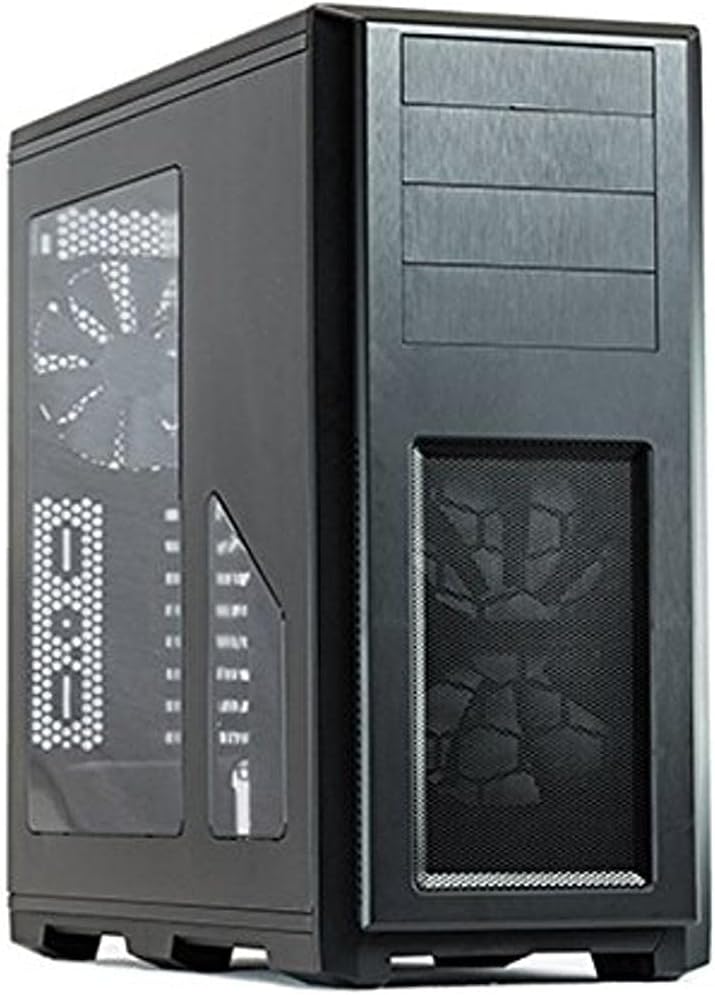

The answer is simple: Phanteks Enthoo Pro

The 780t would be a much better case, though the enthoo pro is perhaps more easily acquired.

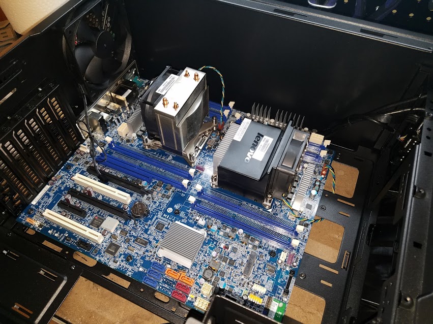

Hey guys, thank you for all the help! I went to Gigaparts (local PC store) today and they were nice enough to let me bring in the motherboard and mock it up in several cases to see which one I liked best. I ended up settling on the MasterBox 5 because even though I liked the Corsair case, they had the MasterBox in stock for $69. It just so happened that all but the top 3 standoffs lined up on the motherboard, and one of those ended up being over a cutout in the mobo tray so I only ended up having to drill/tap two holes.

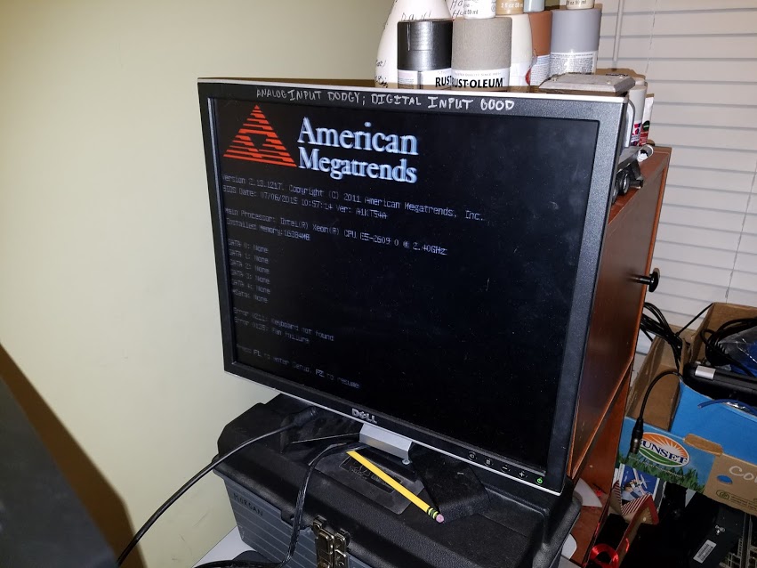

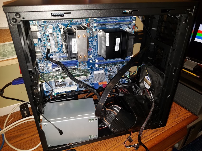

The system is mostly functional now with 16GB of RAM and a total 8 Xeon cores (2.7Ghz I think? Idk). I kept the stock CPU coolers since they are quiet and seem to work well. I am going to have to find another PSU because the stock PSU is a proprietary shape, so it won’t fit in an ATX PSU slot at all. I am looking at the Corsair HX750 (the limiting factor is the 12v rail; the stock has 5 12v rails that add up to 85 amps total 12v output) but if anyone has any other suggestions I am open to ideas.

Secure that power supply son.
It is not only too narrow, it is too tall. If it was only too narrow I’d just fabricobble a sheet metal bracket thing to make it work…but of course it’s wrong in multiple ways…I swear Lenovo was on some serious acid designing these workstations.
