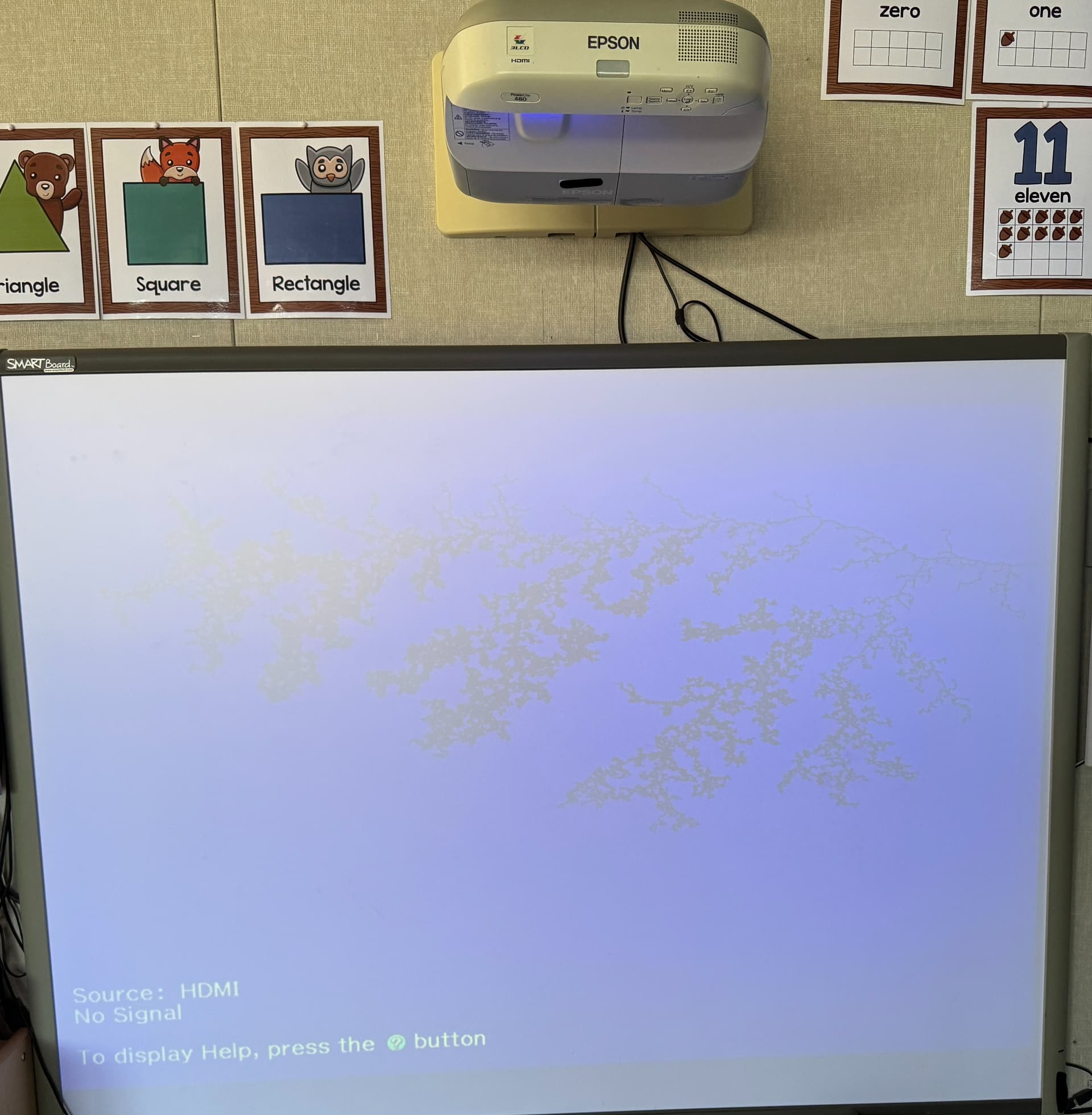

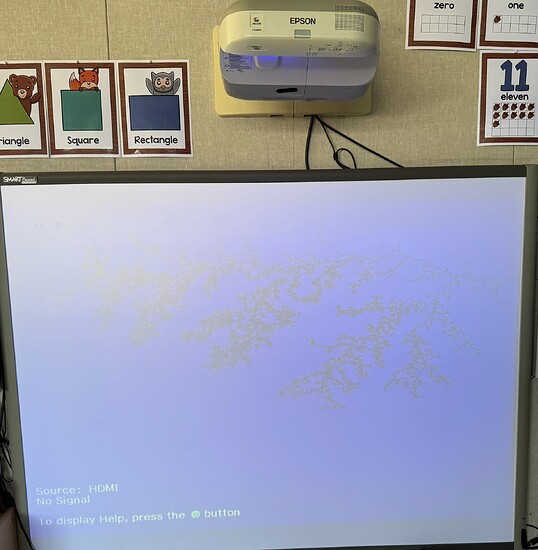

Just curious if anyone has seen this. It kinda reminds me of lens fungus on a camera lens.
I’ve had two projectors (both Epson PowerLite 480) do this in the last couple years. We don’t do repairs on projectors beyond replacing bulbs and filters. The first one was replaced and this one will be as well. So it’s not an urgent thing. I’m just curious what causes it. If you have a white background, the pattern becomes yellow.

Yes, this is a common thing for example when looking at older used photography lenses. Depending on the coating on the lens elements (some can be eaten, some not) and the grown fungus it can be “easily” cleaned by a professional photography shop. Cause is changing relative humidity in the environment, similar to molds in buildings.
DIY-cleaning optical elements can be a bit of a gamble without experience, taking them apart is relatively easy but putting them back together precisely can be difficult depending on the lens element complexity.

And it’s definitely something that’s inside, on one of the mirrors or lenses or something. It’s not on the bulb. I don’t even know if anything could survive with how hot those things get.
