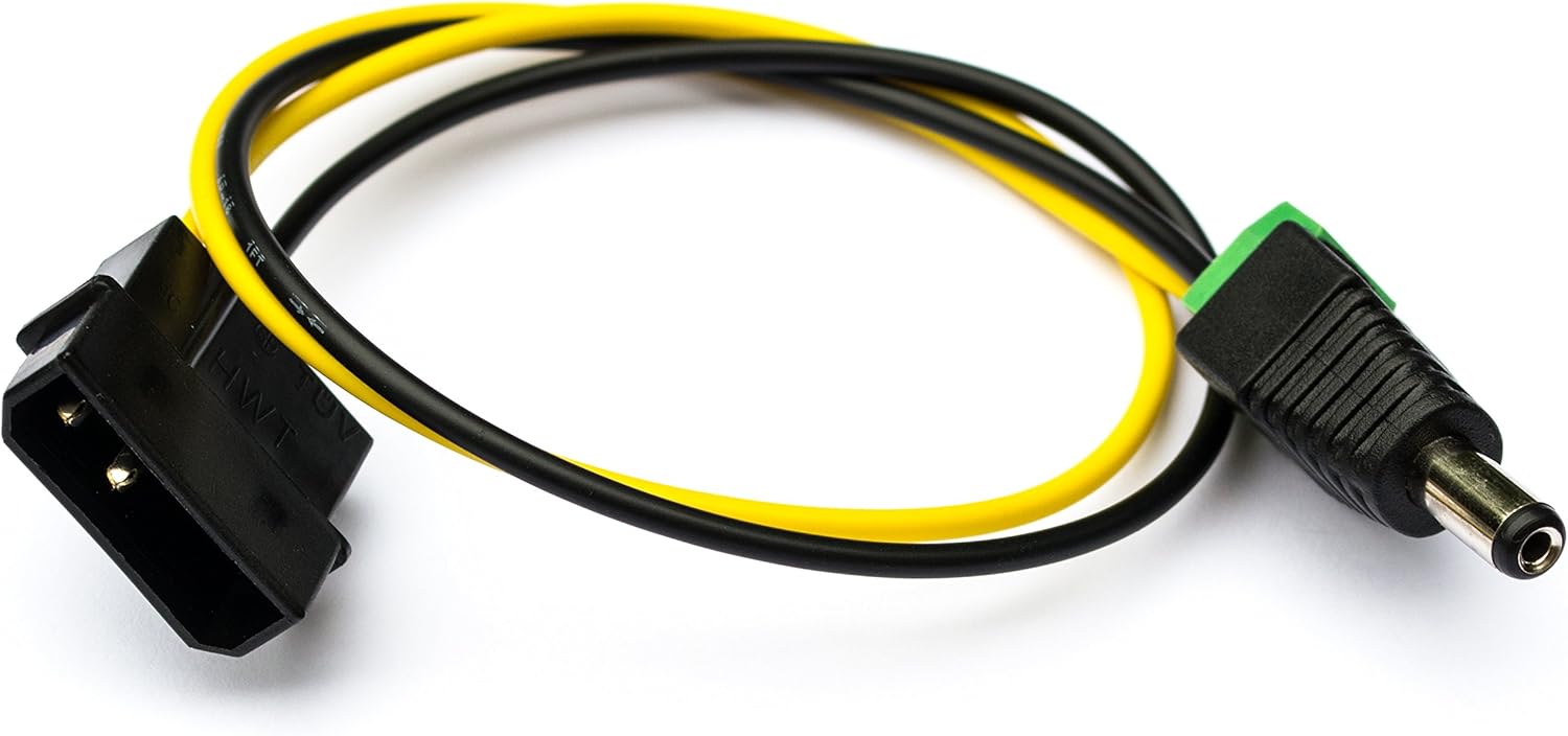

Combine it with this and you wont have to do anything weird with wires at all.
