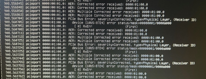

I recently rebuilt my TrueNAS Scale server to get away from an old power-hungry Xeon. I finally decided to get a proper HBA, and I got an LSI 9300-16i from eBay.
After I spent a few hours doing the build and install, I noticed I could not get past grub. I started taking things out of the system, and luckily, I started with the HBA. As soon as I took it out, it went straight to the TrueNas installation. After I finished, I put the HBA back in, and logs immediately flooded the console (see picture). The errors happen with or without drives plugged into the HBA. If I ignore the error, I can see each drive from the GUI or within the shell.

Im not expert, but I see physical layer errors so I would make sure it is seated right in the pcie slot. It could also be that the used HBA you got has hardware problems and just isnt working right.
Stab in the dark… power draw? I think the card is 27W nominal.
Two things to try:
  1. That card is two 8-port SAS3008 chips glued together with high power requirements (27W] and consequently high heat dissipation. Notice the huge heatsink with no fan? It’s designed for server cases with high front-to-back airflow. Try putting a spare 80-120mm fan pointed towards the card to see if it makes a difference with the errors.
  2. In your BIOS, manually reduce the cards PCIe link speed to Gen 2 and even Gen 1 if needed. Does that stop or reduce the errors?
Otherwise, you may have a faulty card on your hands.
You hopefully connected that additional power connector (6 Pin) to a PCIE power cable at your PSU?
I see a 6-pin out that looks like it can take extra power from the PSU, but I wasn’t sure if I should try that. I am confused about the power requirements here. Doesn’t a consumer MOB give 75wats to a 16x slot? Shouldn’t that be enough?
Yes, but it’s a x8 card, and an x8 slot is only guaranteed to provide 25W. In other words, they had to engineer the power delivery circuitry under the assumption that it wouldn’t be able to draw the full 27W from the slot.
ah. that makes sense. thank you!
