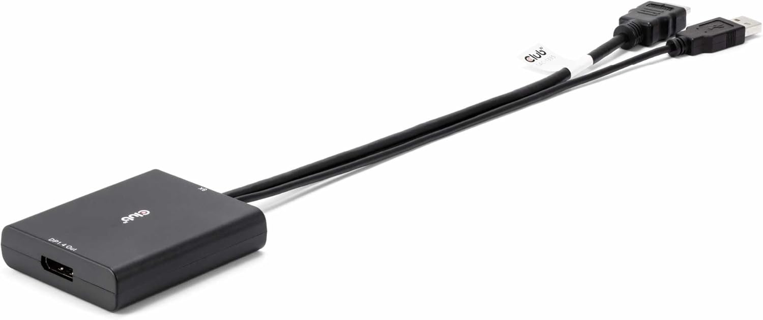

Do you recommend that this cable (for example) would work (Club 3D CAC-1335)?
Club 3D CAC-1335 HDMI+ Micro USB to DisplayPort 4K120Hz or 8K30Hz M/B Active Adapter: Amazon.de: Computer & Accessories

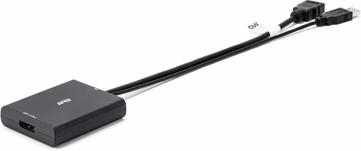

You’re correct the cable in question you listed in a DisplayPort → HDMI cable, this cannot be flipped around to be HDMI → DisplayPort.
We usually recommend this cable:
Yup new cable you should be fine!
