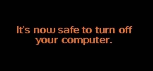

These questions were answered by the Advanced Configuration and Power Interface (ACPI) standard, which new computers have used for more than a decade. When you press the power button on your computer’s case, it doesn’t suddenly cut power — it sends a signal to the operating system and tells it to shut down. The operating system can also understand multiple types of ACPI signals, which is how some laptops are able to have separate power and sleep buttons. And, when you click Shut Down in Windows, it uses ACPI to send a signal to your computer’s hardware, telling it to cut the power so you don’t have to press the power button by hand.
That’s what happens when you press the power button.
A power outage on the other hand, sens no such signal. This is a sudden and ungraceful shutdown.
