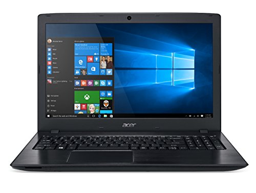

I recently got an Acer E5-575G laptop with Windows 10 installed.
I want to install Windows 7 on this laptop but when I tried there was an issue with drive partitions not being in the correct order but the install continued anyway, but then during one of the required reboots during installation I received error 0xc000000f - "The application or operating system couldn't be loaded because a required file is missing or contains errors." I don't see how this possible considering I downloaded my copy of Windows 7 straight from Microsoft's website.
