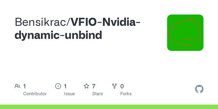

Yes, it’s possible, I do this on an AMD system with a 7950X + RTX 3060 on Fedora. My setup is very similar to this:
Not all the steps are necessary if you just want compute.
The trickiest part has been to make sure the DE or WM grabs the dGPU, since then you can’t unbind so easily any more.
