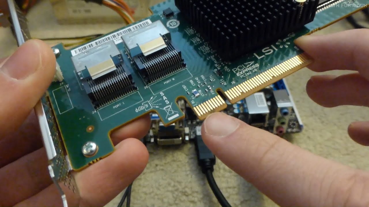

I had a similar issue with a 9300-8i and ended up taping the traces shown in this video, and it solved the problem
May be worth a go
(Video is to fix an unrelated issue)
I used Kapton tape
