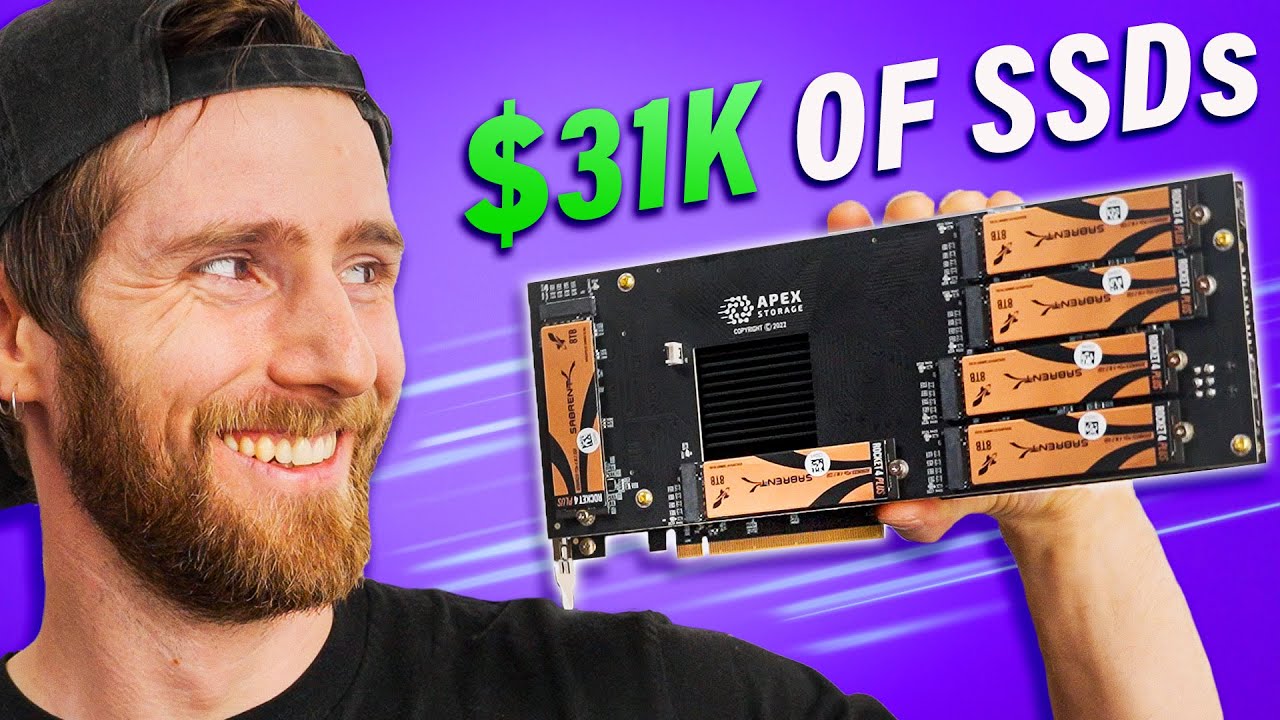

I am getting to this a bit late, But you can get whatever commodity motherboard you want, and just install 2 of these:
https://www.apexstoragedesign.com/apexstoragex21
I think it is by far the cheapest and most compact option.
You can see a review here:

The goal is 240TB of solid state storage. It is hard to reach that on a single computer without running out of PCIe lanes. Did you read about the apex?
Apex Storage X21
Going by the picture, the Apex takes up quite a bit of space (948,301 mm²). And with the M.2 SSDs topping out at 8 TB, 168 TB is about as far as you can go for that footprint (5,645 mm²/TB). The highest density M.2 SSDs are also unreasonably expensive with thrice the $/TB of the next lowest density.
Assuming 16 lanes, bifurcation, and that the 64 TB-class U.2 drive will be released soon, it might be worth waiting for the densest option that can reach 240 TB. There are those PCIe adapter cards that’ll turn a PCIe slot into four OCuLink ports, and Mini ITX cases with a 5.25″ drive bay for 4 U.2 SSDs. The ICY DOCK ToughArmor MB699VP-B V2 come in at around 903,867 mm², yielding footprint of 3,531 mm²/TB (⅝ of the Apex Storage X21).
256 TB could fit in this soon.
The ICY DOCK ToughArmor MB516SP-B takes 16—super expensive—SATA drives, and those could be populated with 16 TB SATA SSDs to reach 256 TB in a footprint of two 5.25″ drive bays (1,931,580 mm² for 7,545 mm²/TB). The problem is that chassis with more than one drive bays are scarce these days.
256 TB could fit in this now.
If you need the highest storage density today, and money is no object, then the Apex Storage X21 is the densest one-slot solution, although that would not get you to 240 TB used as-is. You’d populate 17 M.2 slots with 8 TB SSDs, getting you to 136 TB. Then use an M.2-to-OCuLink adapter in the remaining four slots and run it to four internal drive bays (or the ICY DOCK ToughArmor MB699VP-B V2), with four 32 TB U.2 SSDs, getting you to 264 TB. (As an aside: 264 TB coincidentally happens to be 240.1066 TiB. :slightly_smiling_face:) That achieves your objective, and I’m willing to bet (with the right chassis) it also fits comfortably in carry-on luggage.

You can probably now understand why I recommended the apex cards. If you think the apex cards are bulky, this is the alternative.
