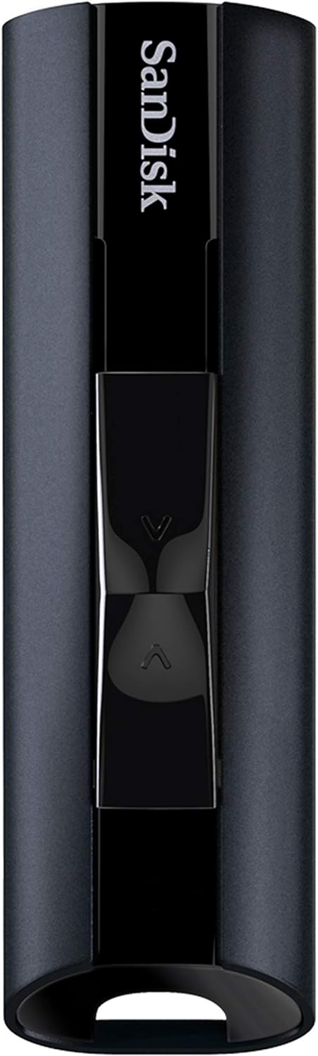

windows will update its bootloader from time to time and when it does… well now you get to learn how to reinstall grub because you didnt separate your installs with different drives.
I’ve never had grub mess up so bad it wouldnt boot windows but that doesnt mean when you inevitably get tired of a broken linux install taking up room on your drive, that you wont want to get rid of grub… and that process is less fun than recovering grub after windows wipes it.
Install linux to this and use the bios to choose when to boot it. Its faster than a mechanical drive by a good bit and will leave your windows install intact.
-OR-
https://www.virtualbox.org/
it wont be as fast as bare metal but you can at least try a distro to see if it really does meet your needs. The positive here is, no commitment.
I’m only telling you not to install on the same disk because I used to do that all the time. It does work and can be done… but you really should avoid it if you can.
bottom line, if you need windows, use windows. If you dont need windows, use linux. Since you dont know enough about linux to know if you can use it, dont install linux (at least not in a way that you must commit your windows drive to).
