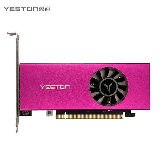

Unfortunately this is literally the only card I could find that fits this spec without modification.
Chat, let us know if you are aware of another single slot low profile no external power card
reference:
