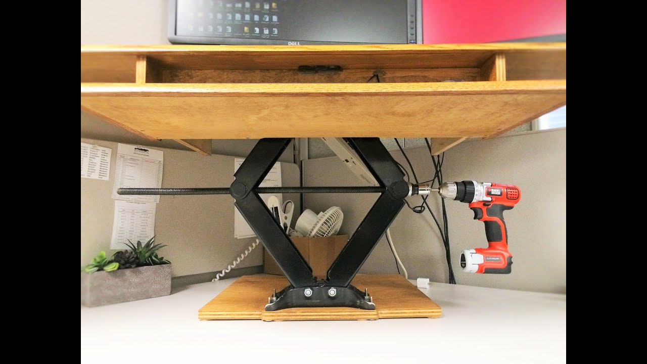

I wonder if there are any aesthetically pleasing scissor-jacks or similar jacks that can lift heavy weights, or if I can conceive a clever way to conceal such a device. I could lift it on some sort of guide, be that rails, posts, whatever, then secure it in place at the designated height with pins or blocks or similar. For what I want to build, I need a much larger workspace that i can use for drawing, note taking, and really laying things out (this is the only way I’m really going to use it).
