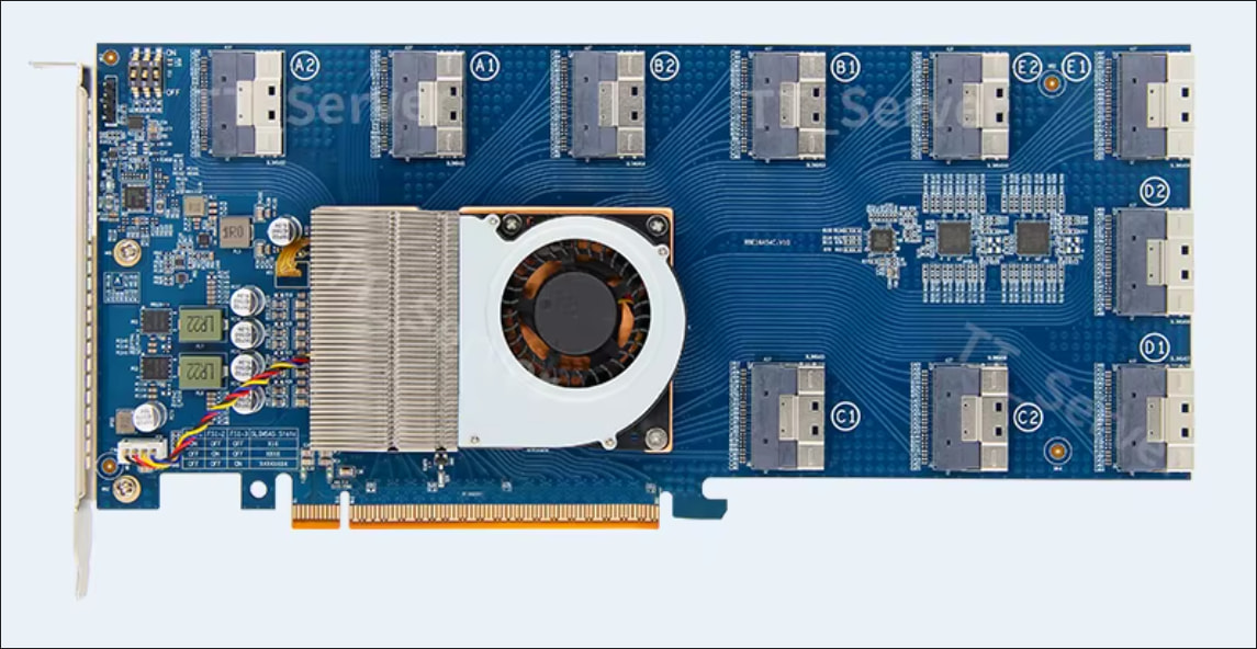

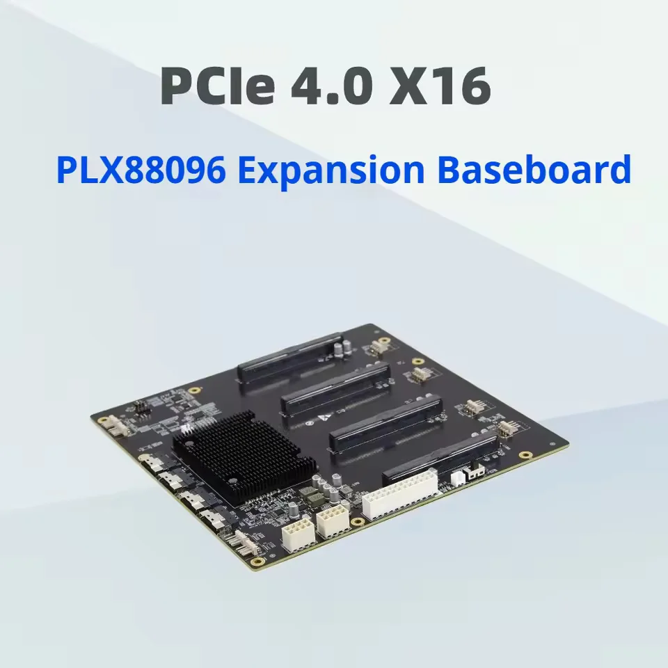

Future edition teaser - Switch board
@Panchovix already did a great job raising awareness around switch boards over at reddit:
Which serves as a good introduction for later.

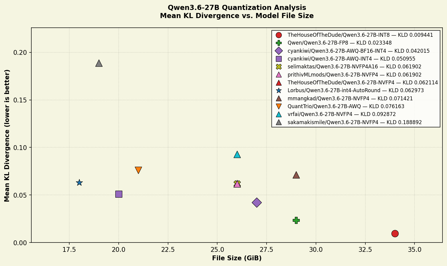

What the Quant
I realize for some I’m getting into religious territory with what I’m about to say, so I want to emphasize this is just my opinion. If you have a different approach that works for you, more power to you (and do share).
I prefer to use FP8 (or even FP16) over any kind of quant for coding.
At this point in time, none of (local) models are perfect and need to have their work reviewed. That’s why I aim for the highest quality responses I can get out of them. If you add it all up, the rework, the things missed that pop up later, the maintenance cost, it might otherwise have been cheaper to just write it all yourself.
Just wanted to get this out there seeing sales people and influencers alike pitching local AI in demos with 4-bit quants. In the end, I guess it all depends on your priorities.
Of course, for experimentation or if you’re just starting out and want to get your feet wet, sort of speak, then you don’t need vLLM with FP16, but that’s not what this thread is about.

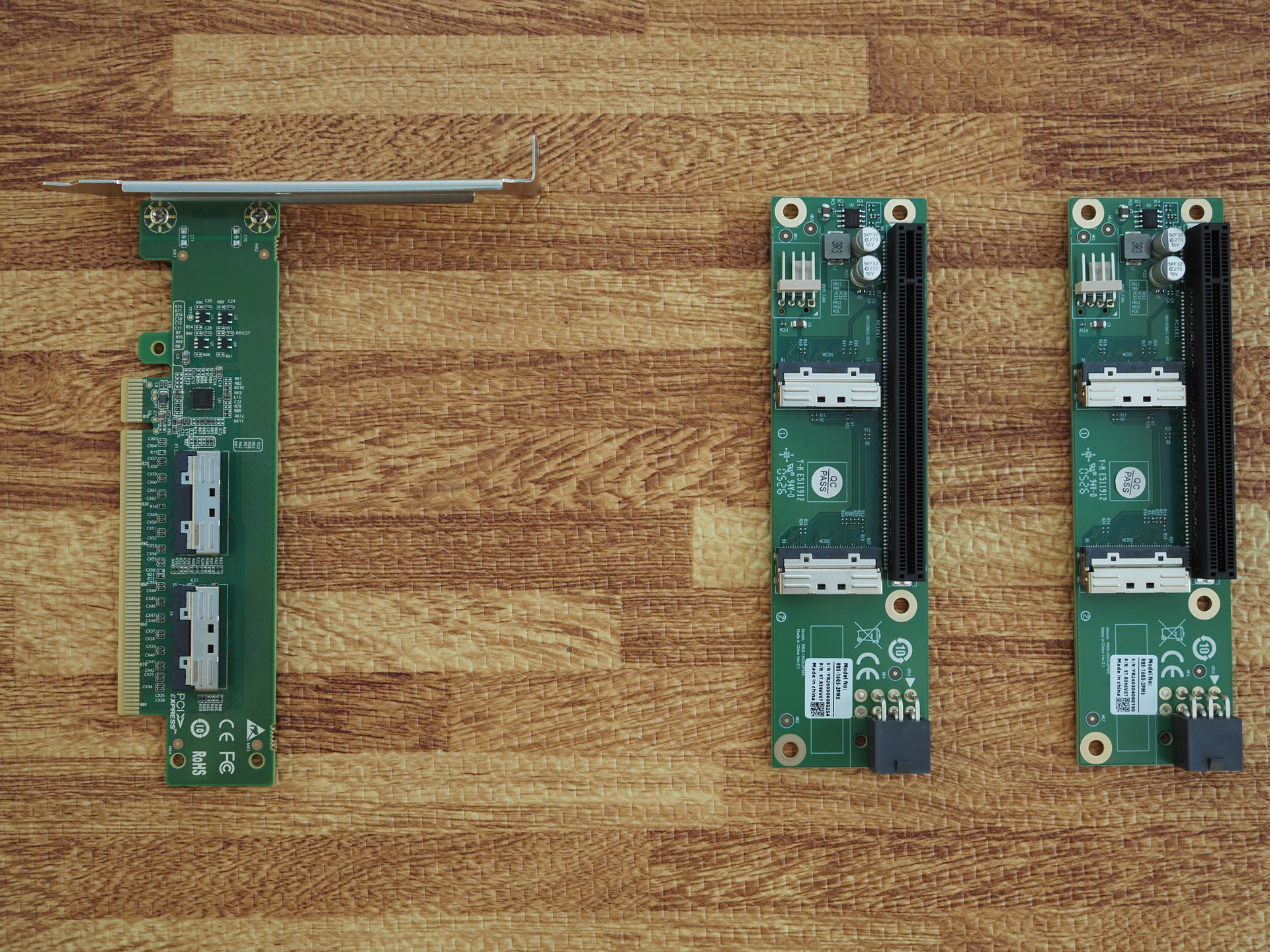

When it comes to the adapters we’ll be using, there are two main kinds:
  • Host adapters
  • PCIe adapters
The host adapter (on the left) connects to the motherboard and in turn uses cables to connect to one or more PCIe adapters. You’ll typically need bifurcation support from the motherboard to (be able to) attach two or more devices to a host adapter. This also means the total bandwidth of the x16 slot will need to be hard partitioned over multiple devices. On top of that, consumer boards have only so many lanes to begin with. For example, on higher end consumer boards you could get two slots for GPUs. However, these go into x8 mode when both are populated. This makes further bifurcation even more troublesome, quad GPUs running at x4?
This is the main attraction of the switch board, each slot gets full x16 bandwidth with the board doing the “switching”. With a switch board you can think of it as going from 16 PCIe lanes on the main board to 16 lanes on the switch board, using two cables. Depending on the host adapter, you might still need bifurcation support from the motherboard though. When I set the BIOS setting on the B550 to Auto (x16), the PCIe switch didn’t show up (in lspci) and neither did the GPUs.

For me, it all kinda came together. I’ve been dabling with Qwen3 30B Coder FP8 for a while now (on 2 3090’s). With the release of Qwen3 Coder Next, and the promise of software enabled P2P, I was anxious to see how it all stacks up together.
Worth pointing out that there is another tradeoff to be made here. The 3090’s are from the Ampere generation, which doesn’t have the hardware plumbing to handle FP8 directly. Per vLLM FP8 docs:
vLLM supports FP8 (8-bit floating point) weight and activation quantization using hardware acceleration on GPUs such as Nvidia H100 and AMD MI300x. Currently, only Hopper and Ada Lovelace GPUs are officially supported for W8A8. Ampere GPUs are supported for W8A16 (weight-only FP8) utilizing Marlin kernels. Quantization of models with FP8 allows for a 2x reduction in model memory requirements and up to a 1.6x improvement in throughput with minimal impact on accuracy.
With these Marlin kernels, even though it’s not emulation (sorta kinda), there’s a similar performance hit.

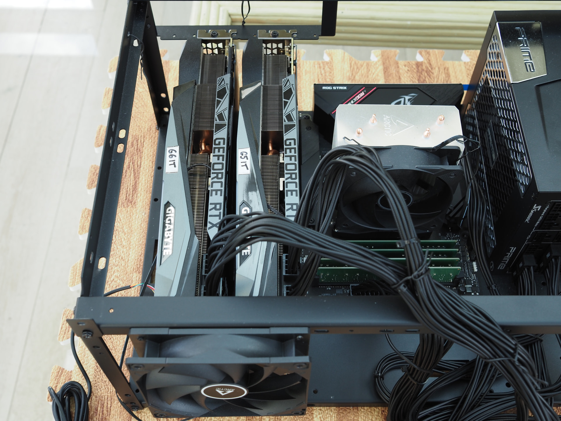

April Fools edition - Dual GPU setup
Obviously, we’re not aiming for models north of 70B (yet). For the dual GPU setup we’re looking at 30B parameter models at FP8.
AM4 test rigs:
  • Do: use with passive adapters
  • Don’t: expect P2P support (more on that later)
  • CPU: AMD Ryzen 5700X
  • RAM: 4x 16GB Crucial DDR4 2666MHz CL19

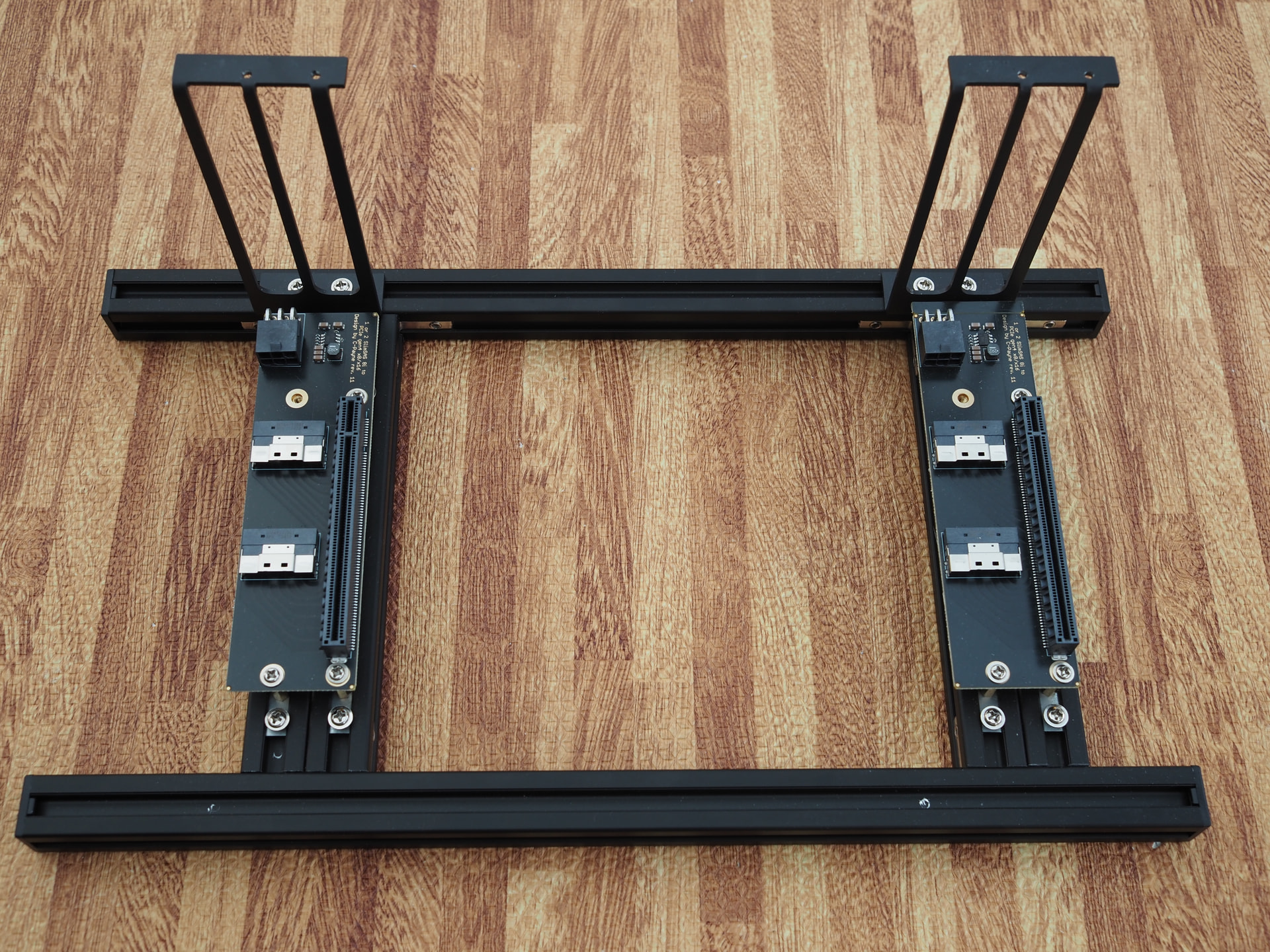

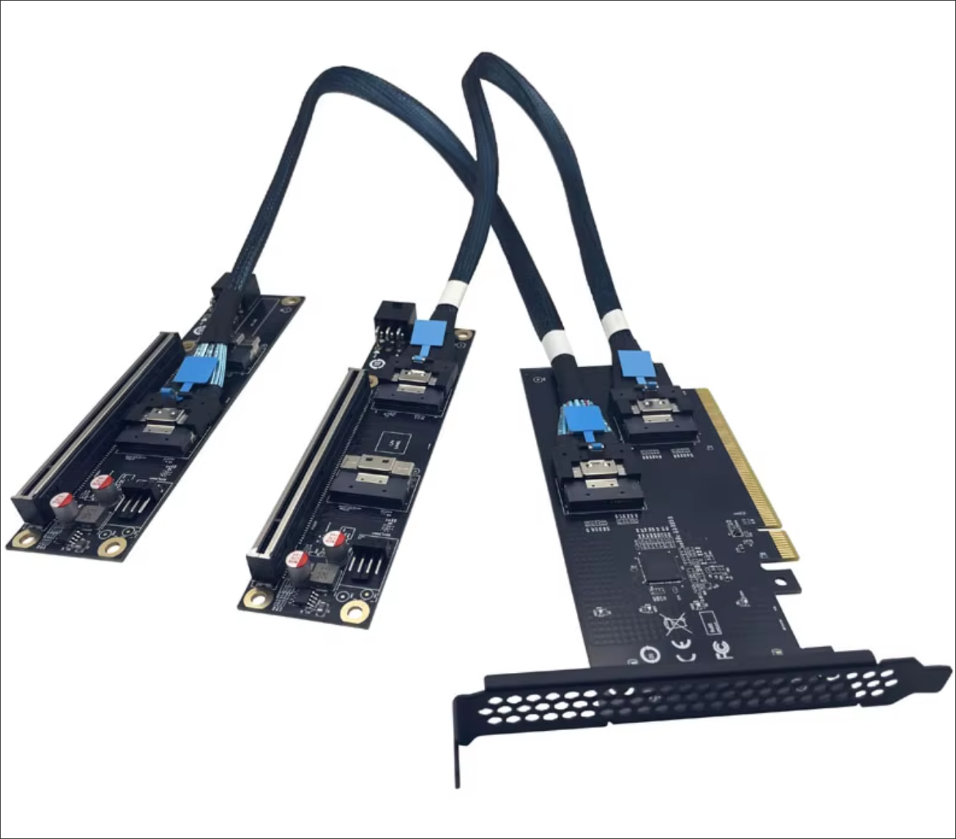

When it comes to MCIO adapters, this passive Shinreal host adapter in combination with these PCIe adapters maintains excellent signal integrity.
Props to @thr3e for bringing these to our attention (in the Neverending Story).
With 1 host adapter, you can hook up 1 PCIe adapter at full 16 lanes using 2 cables. Or you can hook up each PCIe adapter with 1 cable for 8 lanes of bandwidth.
Of course, you don’t really need PCIe adapters if you’re going to use a swith board that provides PCIe connections by itself. It all depends on how you hook everything up.
These days you can easily find MCIO to MCIO cables. 10Gtek provides quality ones.
In combination with the switch board I used (shown in future edition teaser), you will need two MCIO to SlimSAS cables.
There are good ones from Shinreal that are 1m long. 10Gtek also sells these, in varying lengths. I bought a set of 0.8m from them.

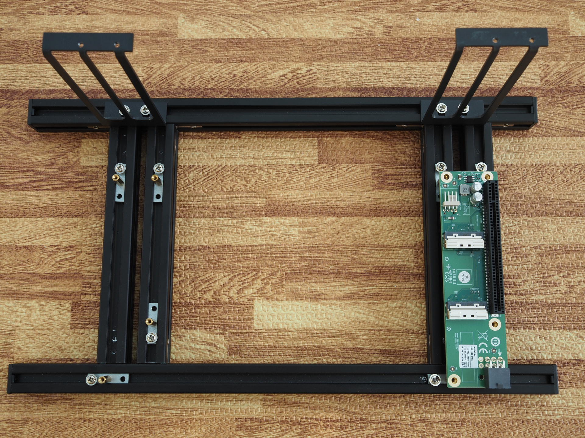

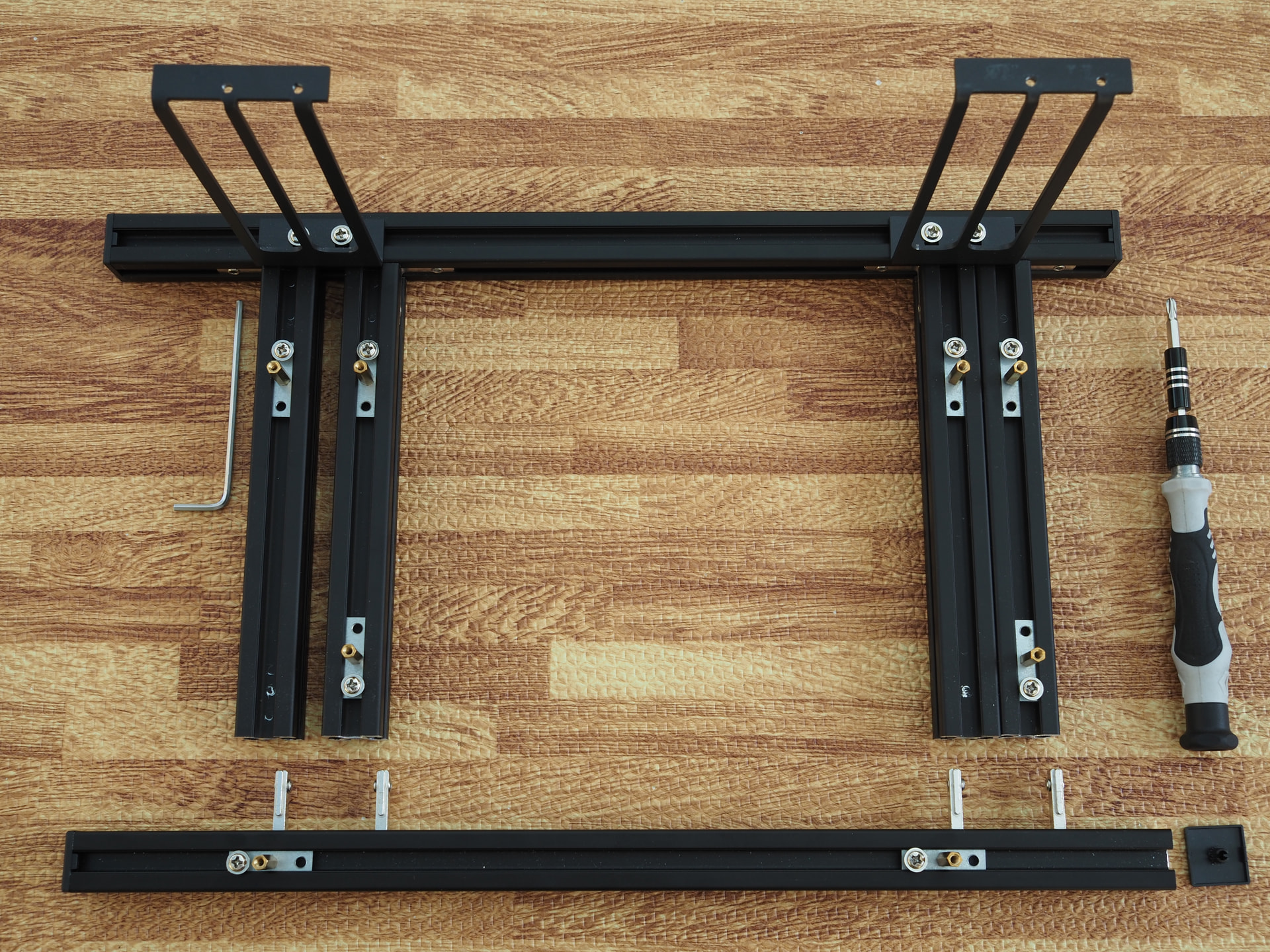

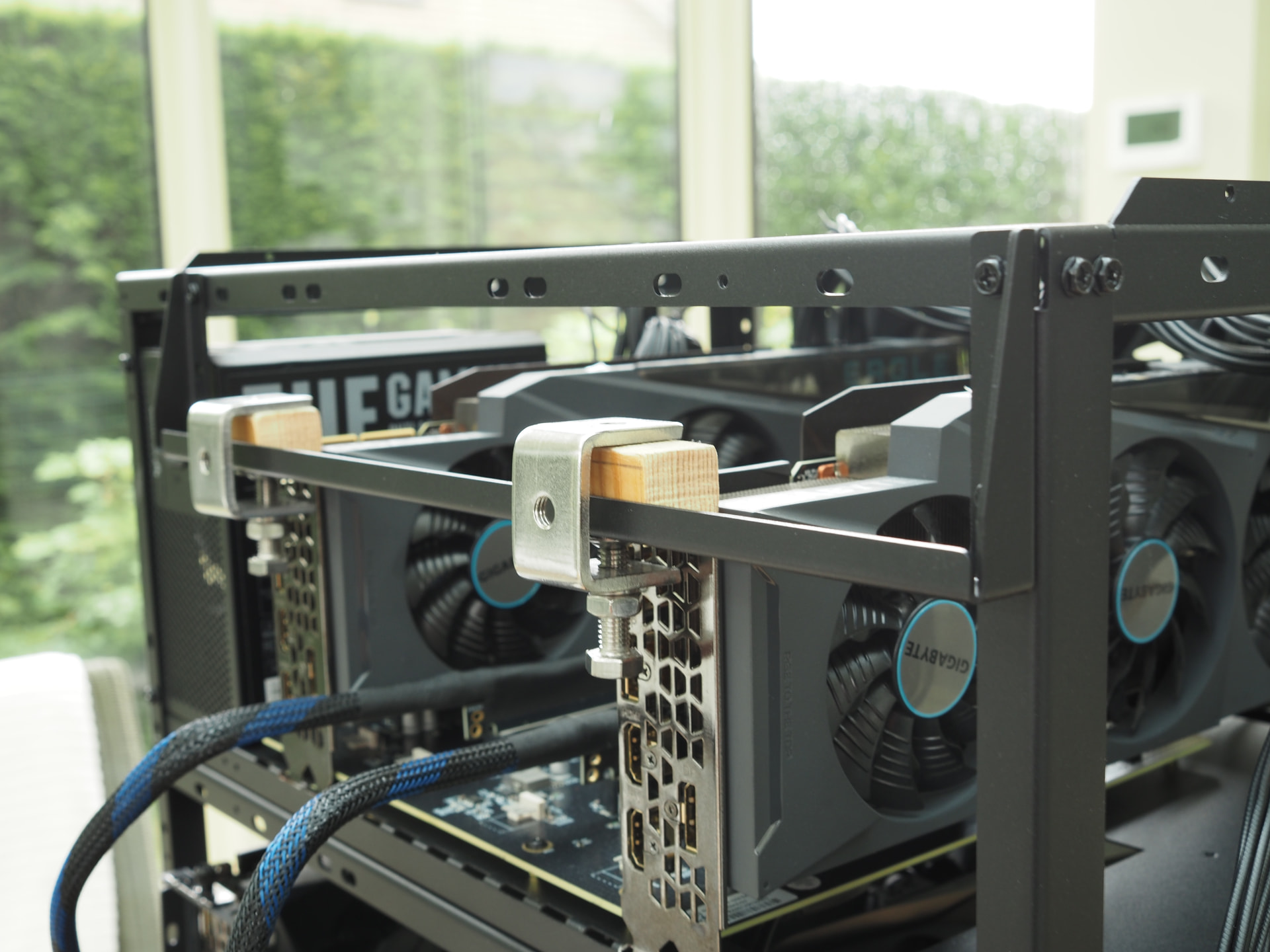

Choose your frame

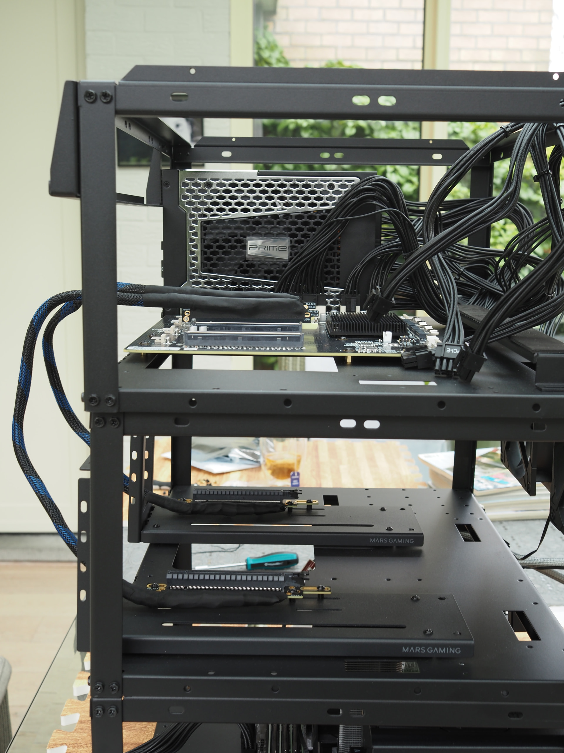

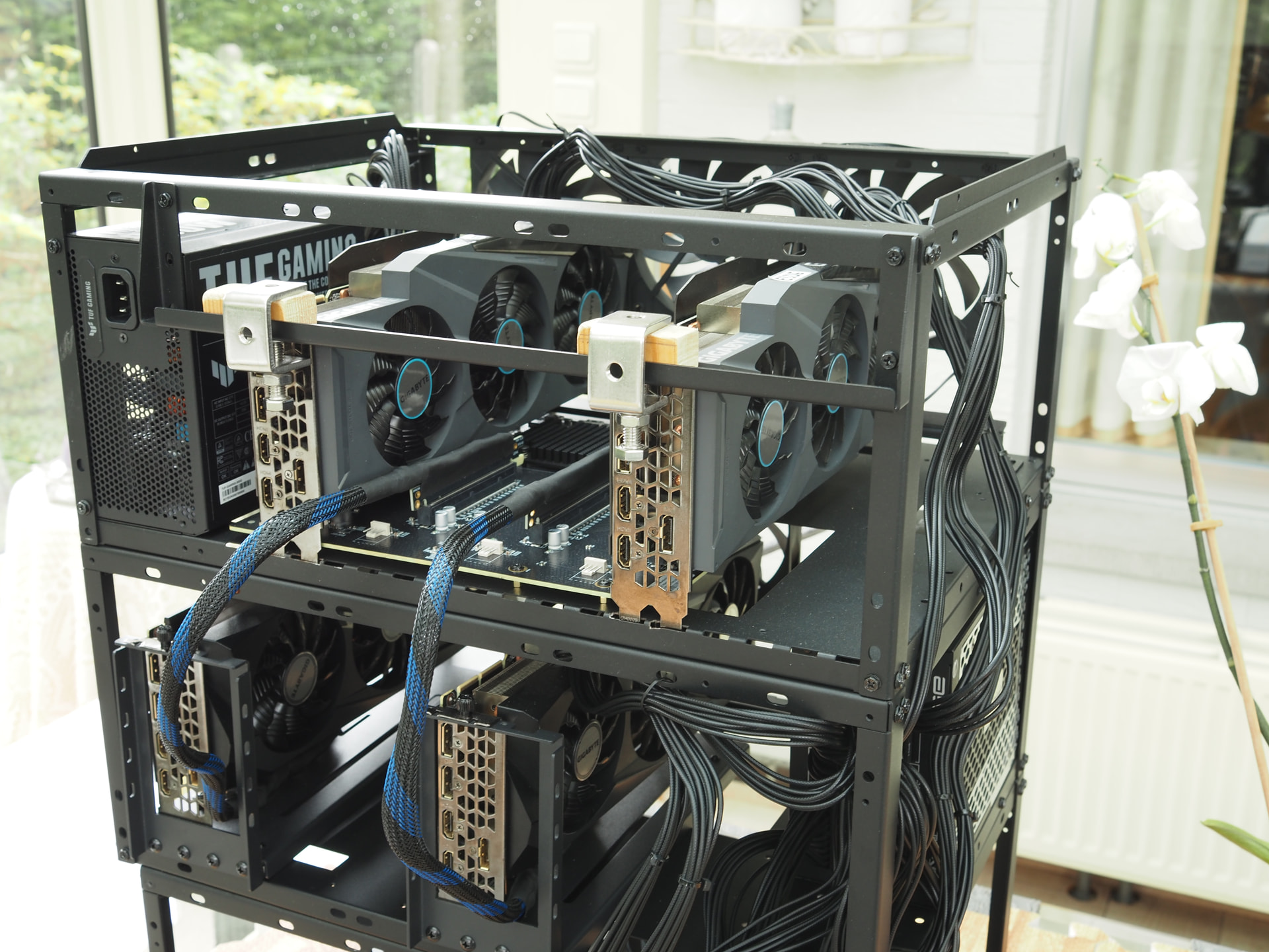

One of the more versatile frames I encountered were those constructed out of aluminium profiles. These can easily accommodate different styles and shapes of PCIe adapters. The ability to control the spacing between the vertical profiles also helps with the overall versatility.
The proposed MCIO adapters from above range quite far and require placing the bottom support on the horizontal profile.
The SlimSAS adapters below (I use C-Payne btw) are oriented differently, so I was able to place all supports on the vertical profiles.
Apart from not having anything to mount fans on, these work really well for a dual GPU setup. It gets out of your way. Takes up minimum space, while still providing ample spacing between both GPUs.

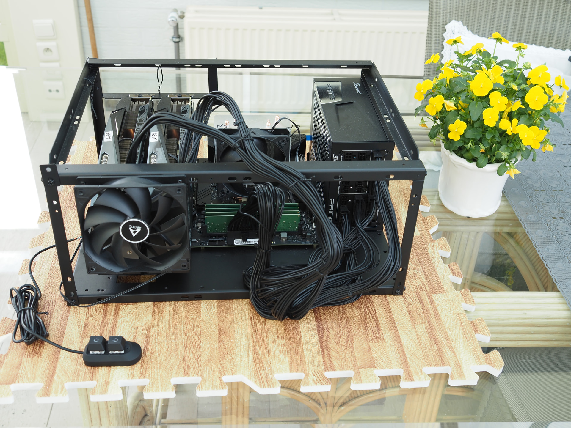

MCIO Adapters (x8x8)
My test lab (not the showroom used for the pics) is quite space constrained, so I chose to stack vertically. Eventually, everything will end up on shelves in the basement.
With signal integrity in mind, it pays to keep data cables separate from power cables. For that reason I turned the base frame 180 degrees compared to the frames that will stack on top of it. This way we can have the data cables to the left and the power cables to the right.
The gray cables coming from the host adapter are the Shinreal MCIO to SlimSAS cables of 1m. As mentioned, data cables don’t play well with tight bends. This is the curvature I settled with.
Moving along clockwise.

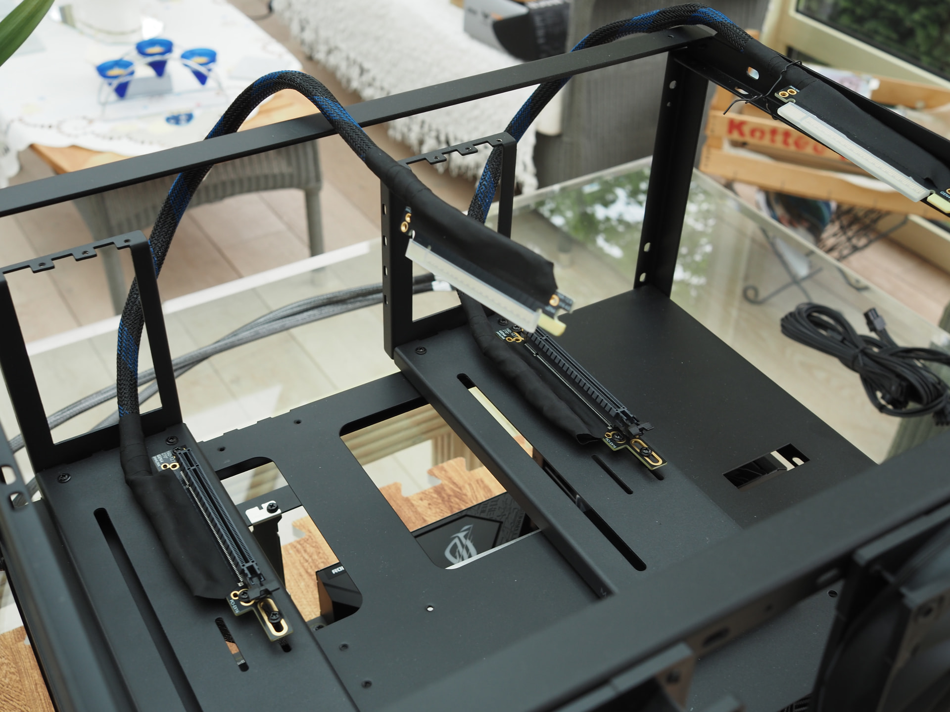

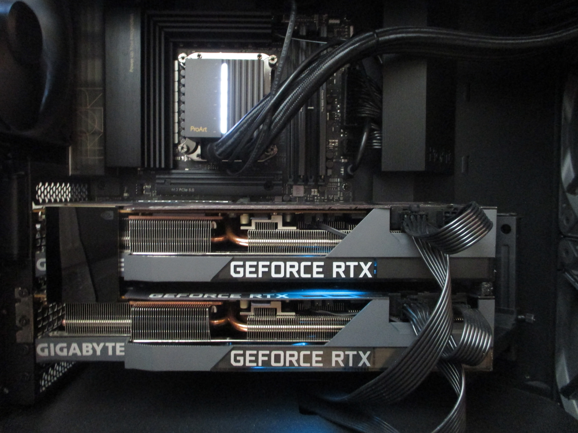

So you might think: “Why would I need to invest in additional boards for a dual GPU setup?”.
Well, apart from the highest end consumer boards, you usually get only 3 slot spacing for a dual GPU setup. You can make it work, I too resorted to, what I coined, cooking with Eagle eyes (pun on Gigabyte Eagles).
Motherboard slots (x8x4)
An already better implementation is to mount the GPUs next to each other. This way the chimney effect is less prevalent.
Still, the temperatures are way better with the first setup (with PCIe adapters). For my remaining builds, I will strive to put the GPUs further apart. Even if it requires additional riser cables (I saw a couple of interesting ones on AliExpress, more on that next).

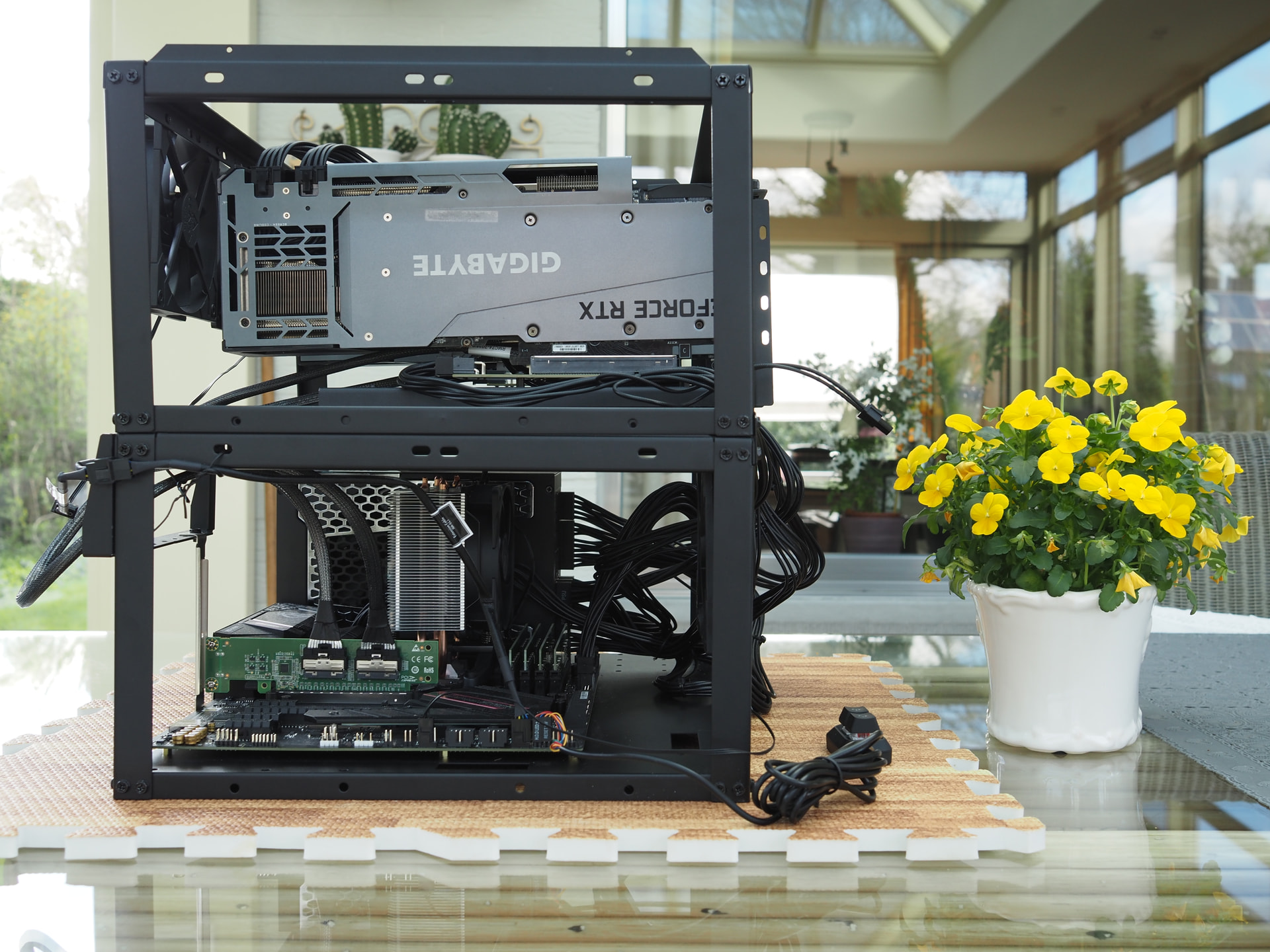

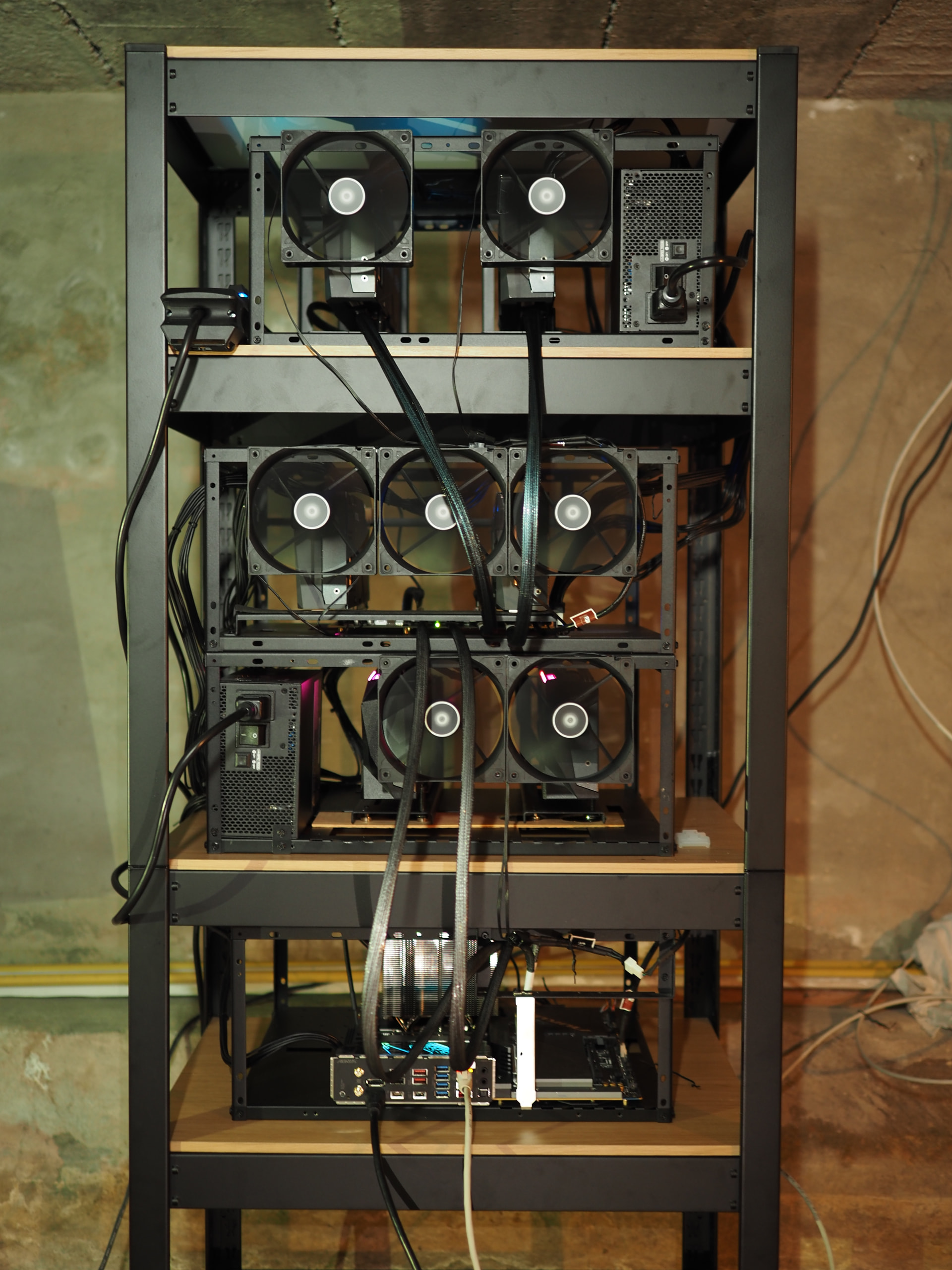

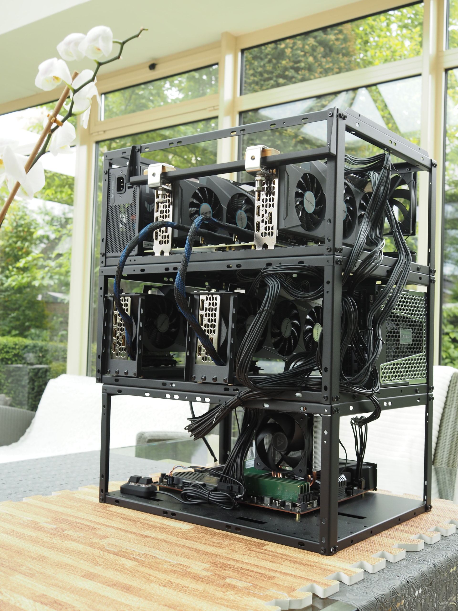

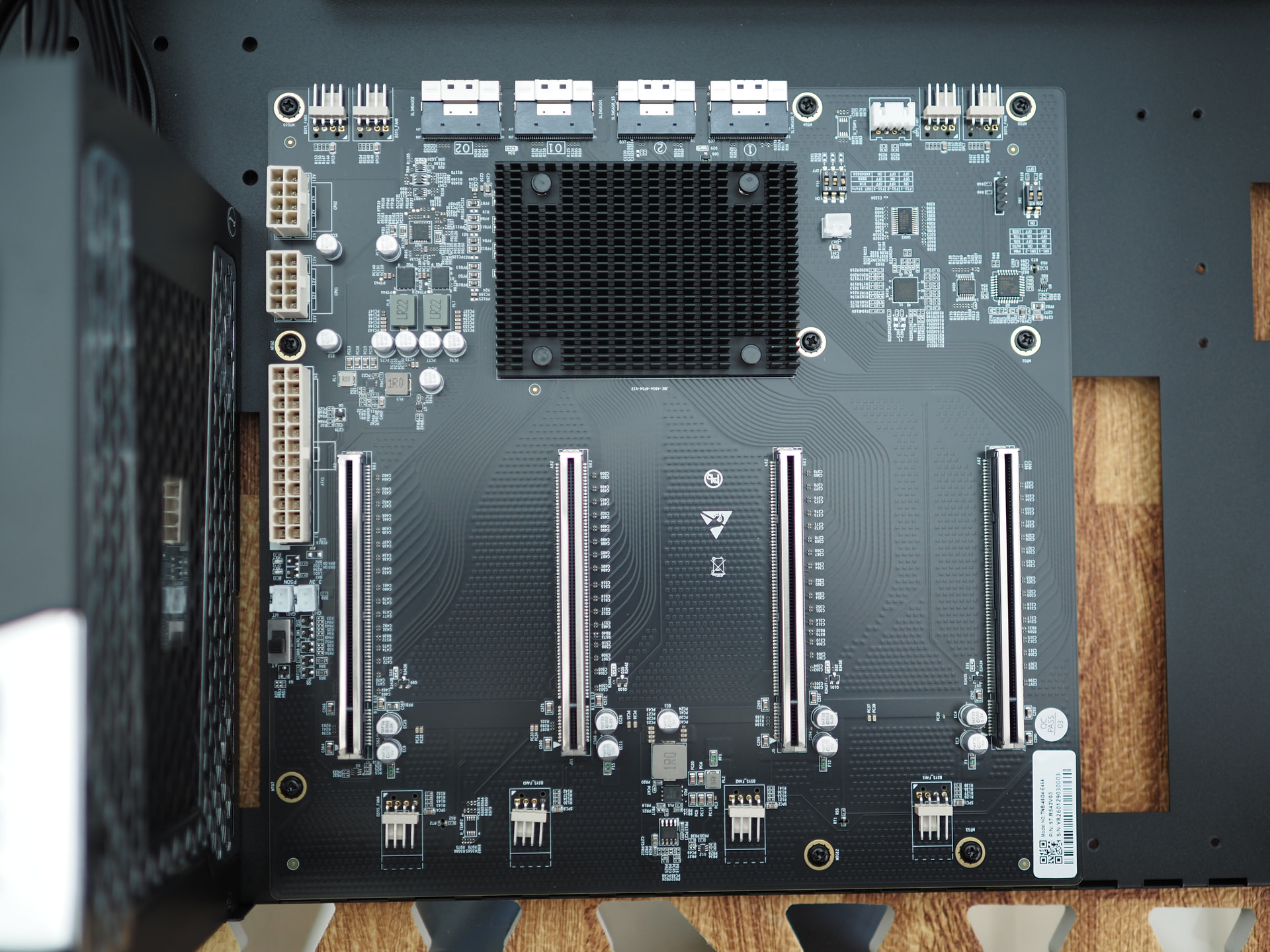

Easter Egg edition - Quad GPU setup (switch board time)
After my adventures on AM4, I decided to get off the less travelled path and bought the same motherboard Panchovix already got P2P working on.
AM5 test rig:
  • CPU: AMD Ryzen 9600X
  • RAM: 2x 16GB Crucial Pro DDR5 5600MHz
  • Motherboard:
    • Gigabyte Aorus Master X670E
    • 250-ish bucks on second hand market
    • Enables P2P
Pick it apart

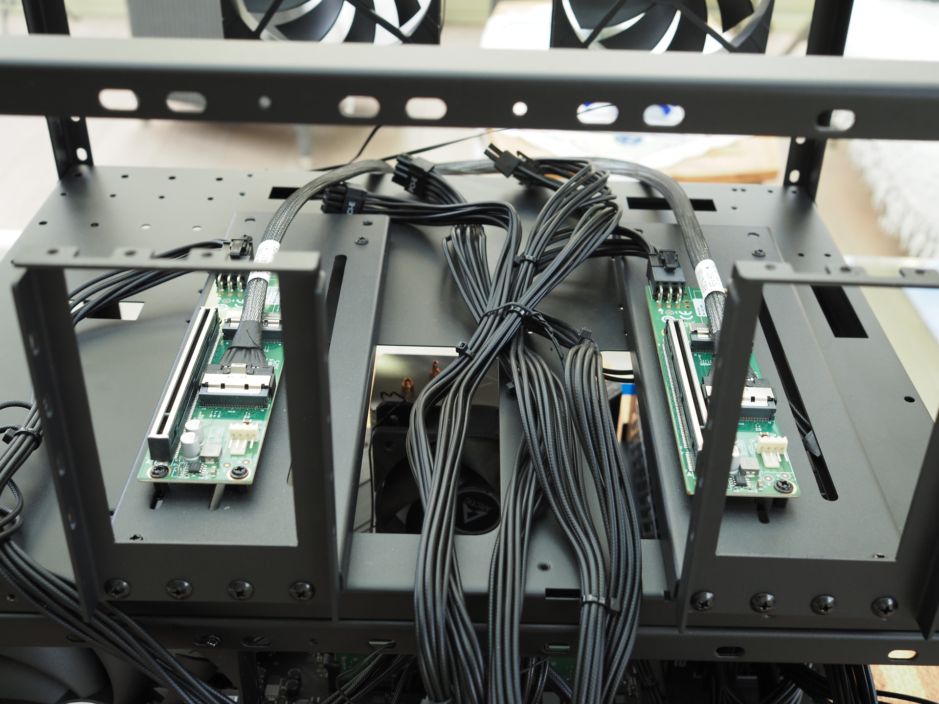

These risers from AliExpress were advertised as a server cables. They’re the less common 0.6m variant. Note they don’t just vary in length. There are left and right angled slots. The cable can also go either way, meaning to the front or back of the frame.
This is what I had in mind.

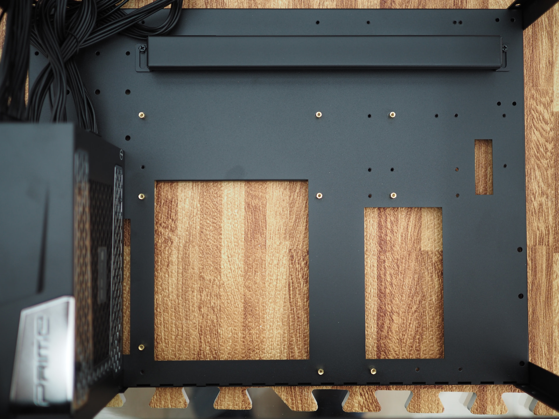

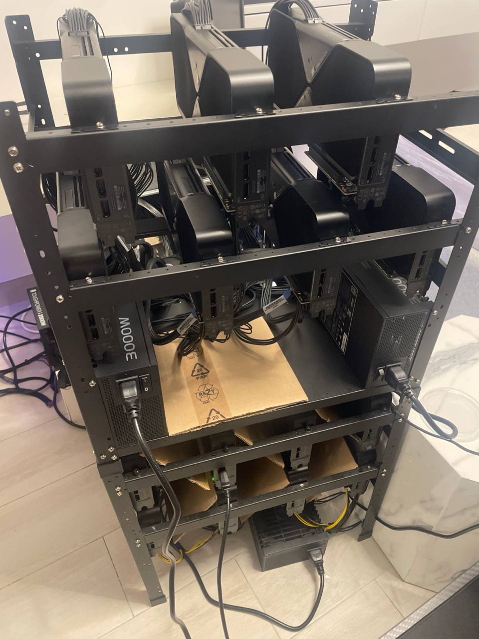

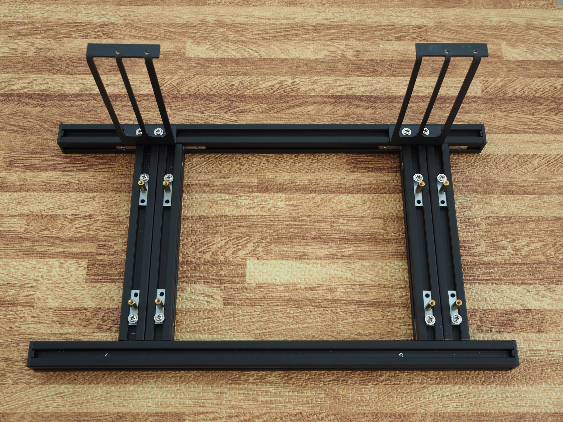

Choose your frame
Found these stackable frames on AliExpress.
They come in two variants:
  • One for mounting motherboards
  • One for mounting up to 6 GPUs, which we can use for our switch board.
They both have the same width, but the 6 GPU version is just a bit longer. The good news is you can still stack the one type on the other and fixate them with screws on one side.

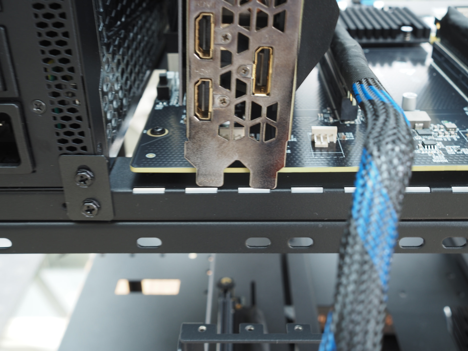

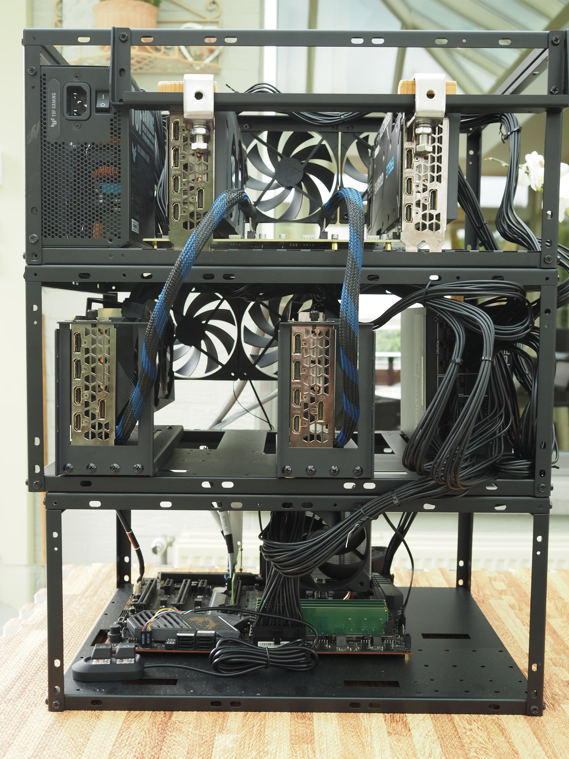

For the bad news, the devil is in the details and after installing the switch board.

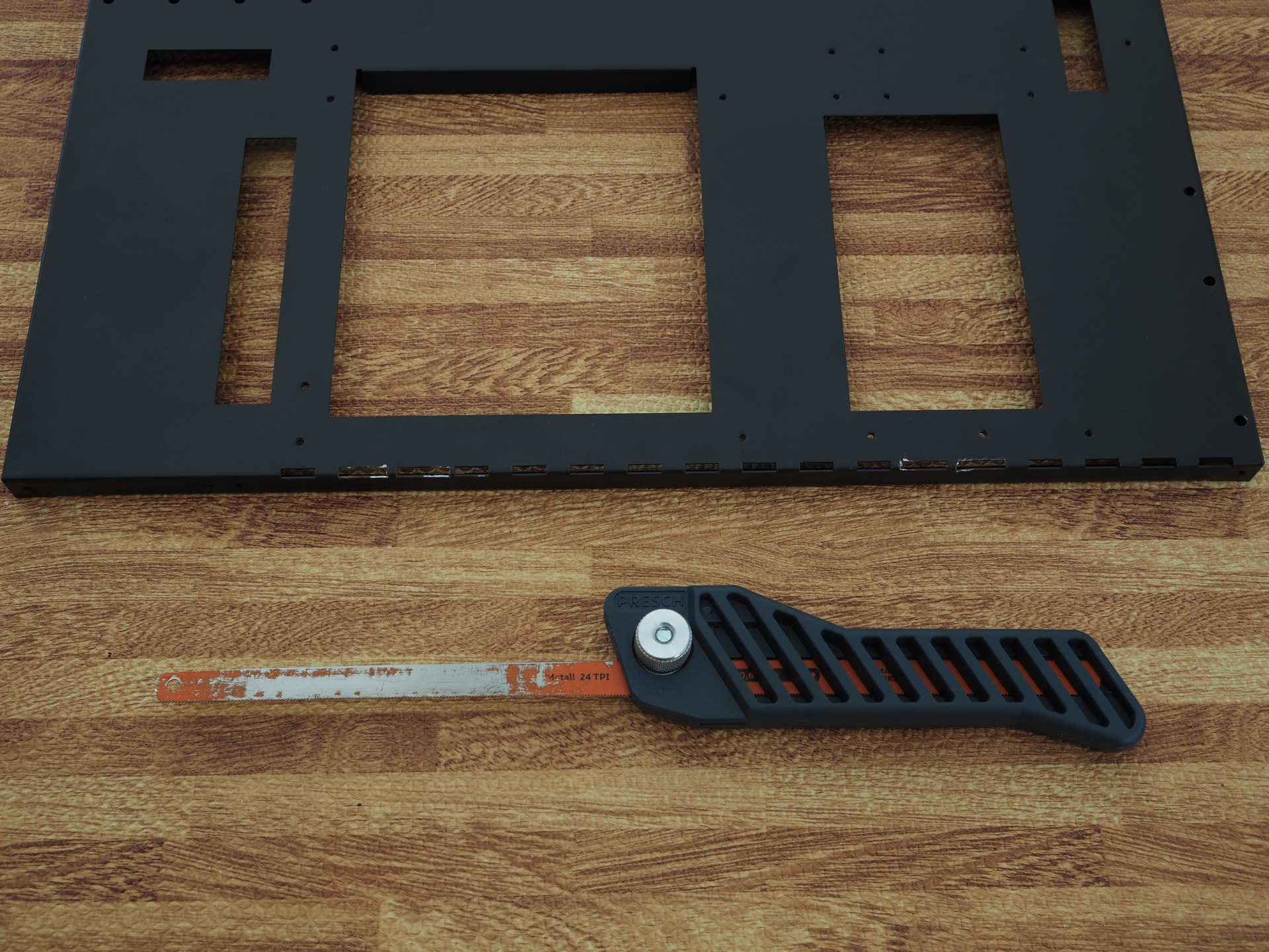

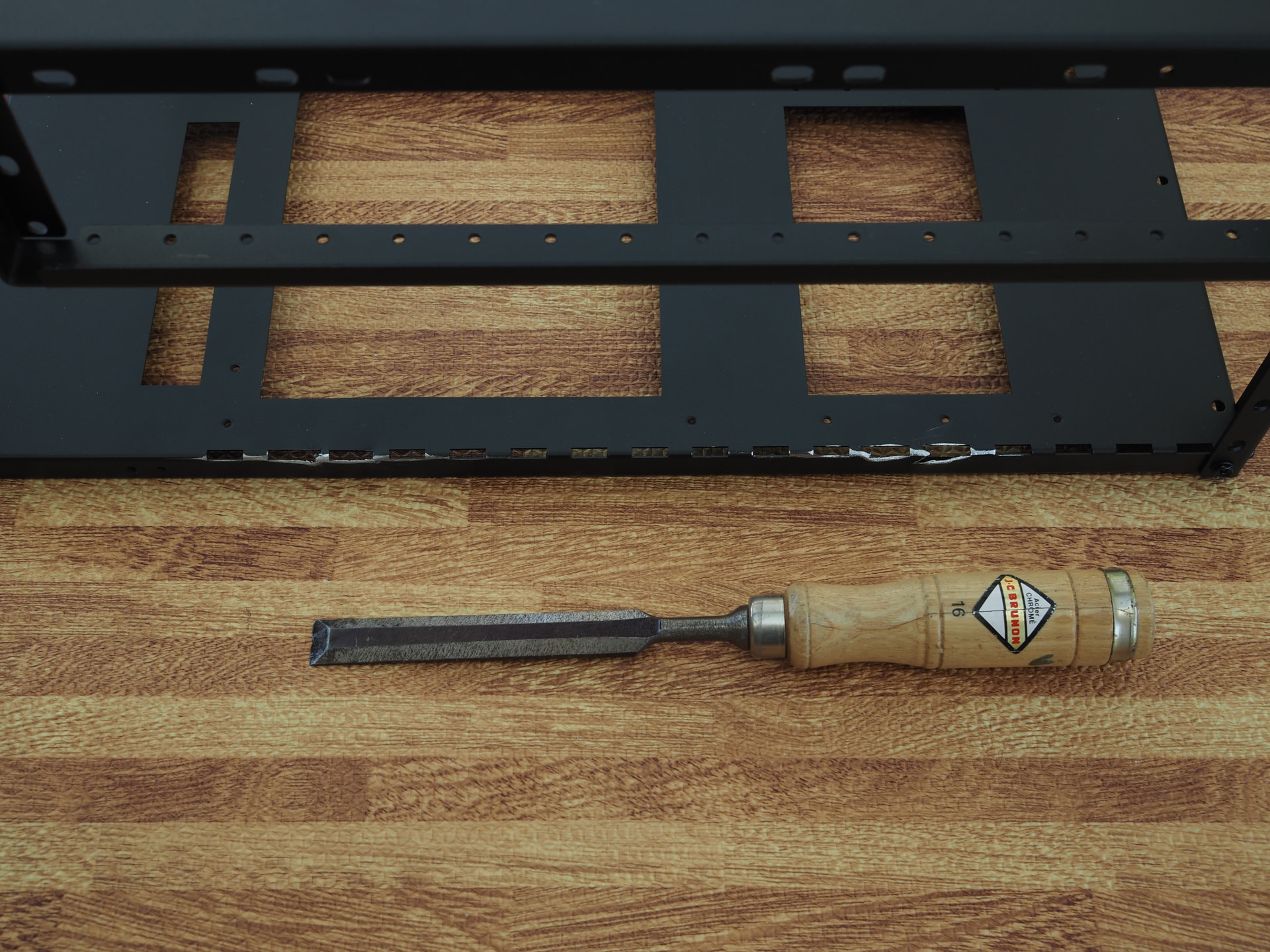

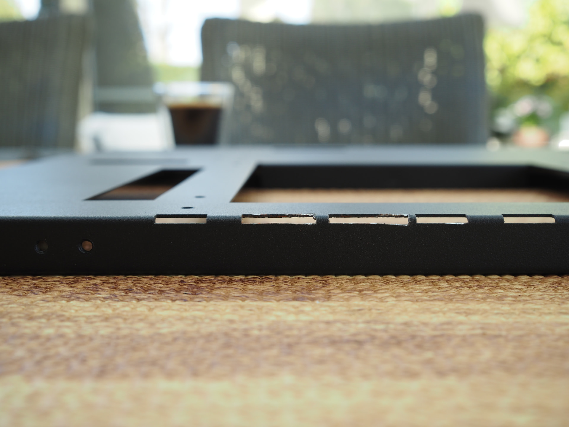

The cutouts didn’t align with the GPUs.
With my first attempt with a chisel, the thin sheet metal didn’t take the shock therapy all too well. The flat surface got all wobbly.
For my second attempt, I took a gentler approach with a small iron saw. Had to file the top of the blade to get it through the cutouts though.
At this point, I wanted to get back to testing the switch board, so instead of screwing with the holes on top, I just clamped the GPUs in place.
Make sure the GPUs are perpendicular to the board when you fixate them.
At the time, these frames seemed like a better idea than those mining frames. Bit of a hassle with the misalignment, but all in all, I’m happy with how it turned out.
We could definitely use some more good budget options in this space.

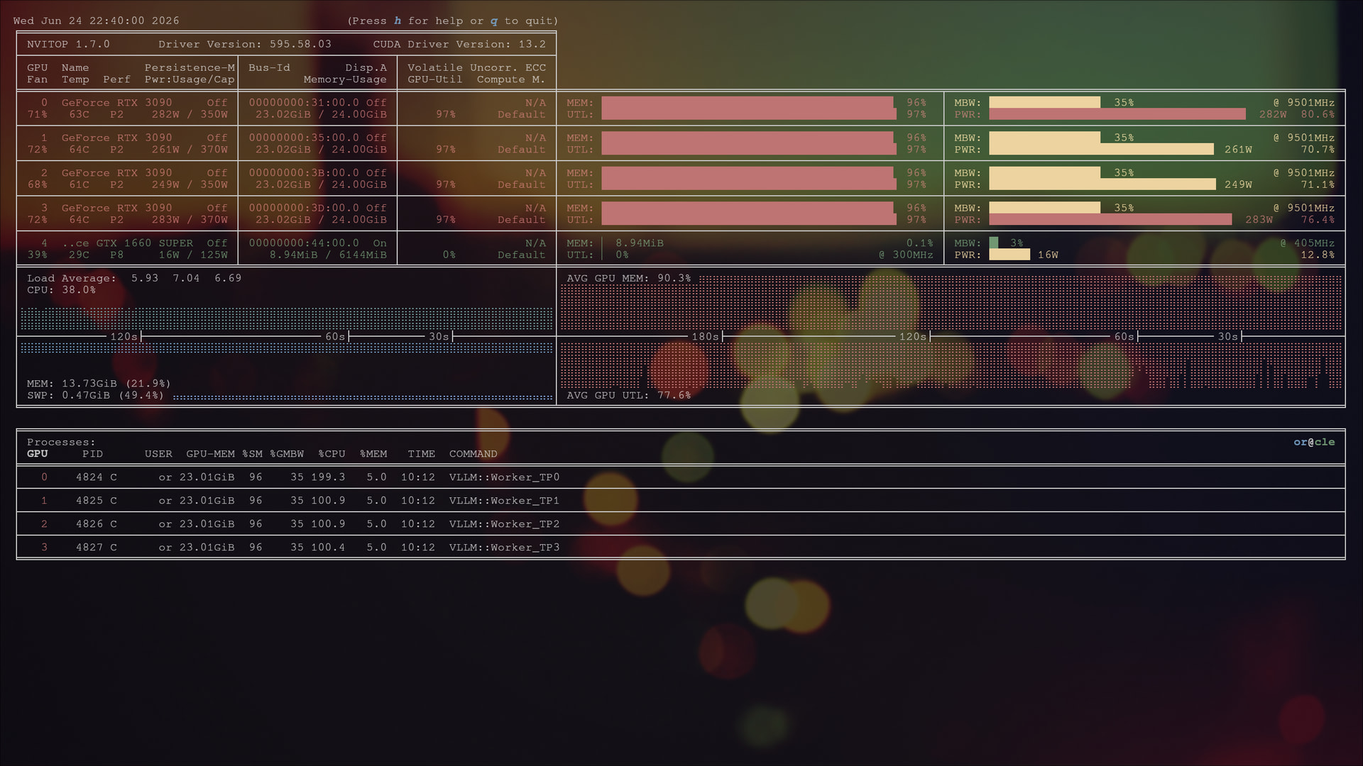

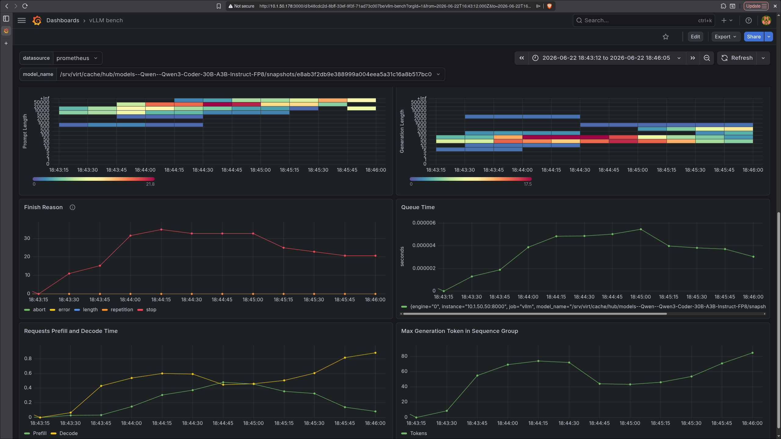

The 3 setups for which I benched all models:
  • AM4
  • AM5
  • AM5 with P2P

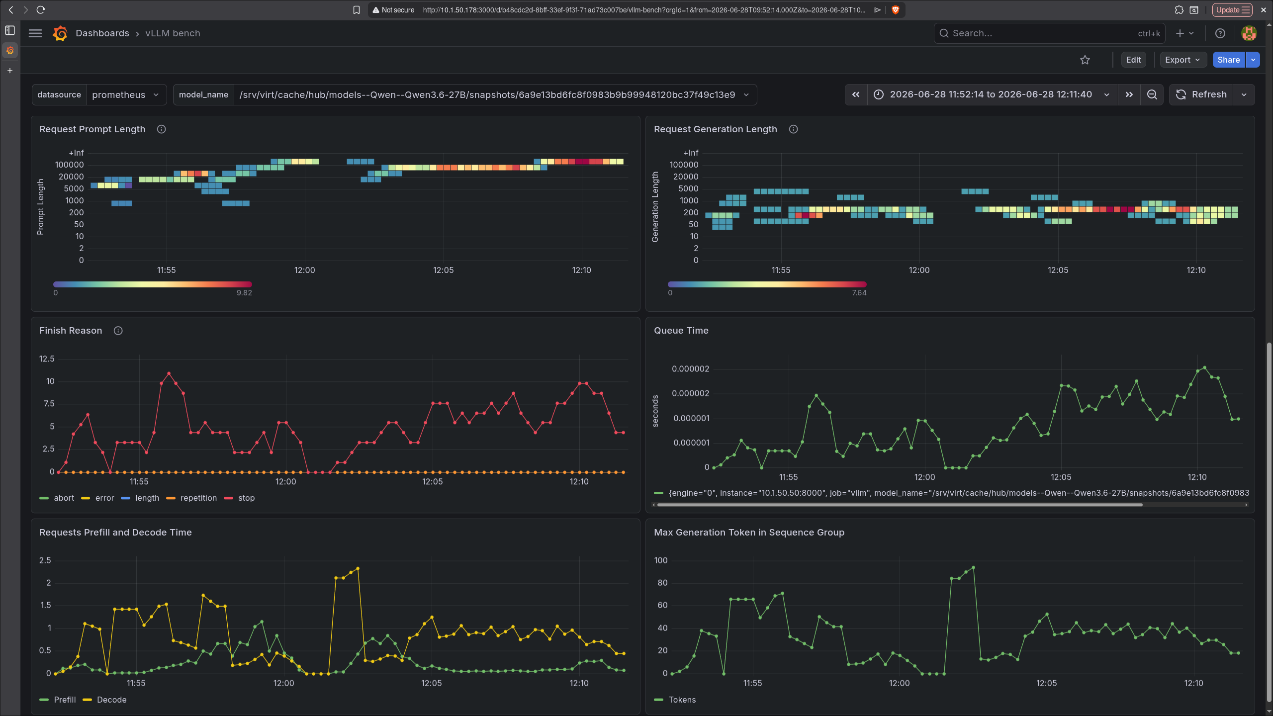

For each combination of setup and model, I ran a script with two coding assignments, fired one after the other. The first is more of a warm up, applying the Command pattern to a code base of a single source file. The second assignment is to implement a new feature in the OpenRA git repo. For comparison, I’ve hooked up vLLM telemetry to a Grafana dashboard. Combined with NVITOP screenshots, this should give us some insights in the characteristics of each build.

By the time, I already retired my AM4 components into a low power workstation. The use cases I had in mind for the MSI Ace board were development, all round number crunching and doing write ups, such as this one.

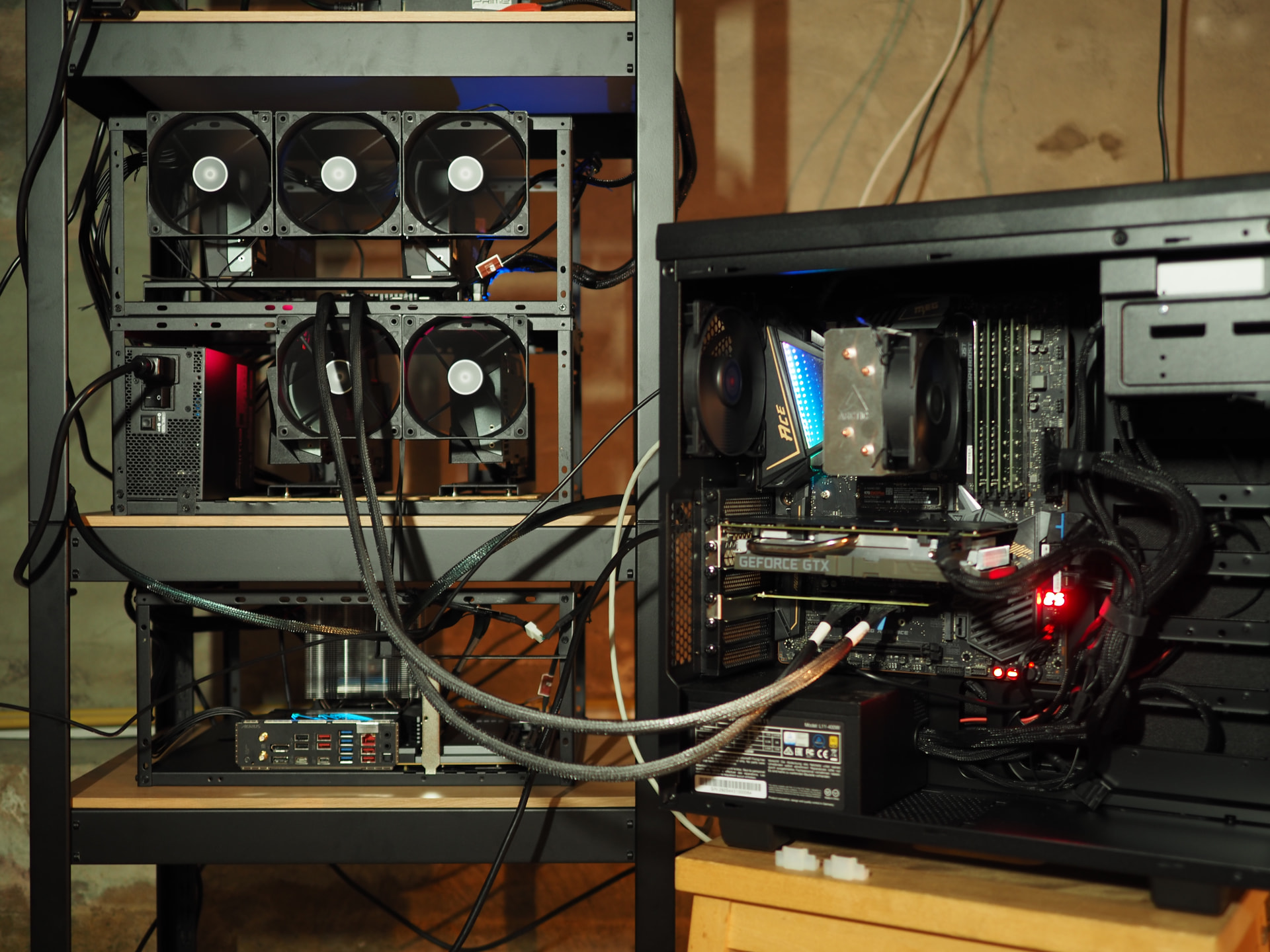

Instead of messing with both builds, I opted to switch data cables. You’ll see the workstation’s Geforce GTX 1660 Super pop up in the AM4 NVITOP screenshots.

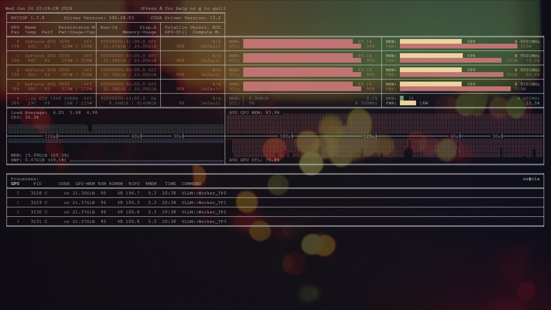

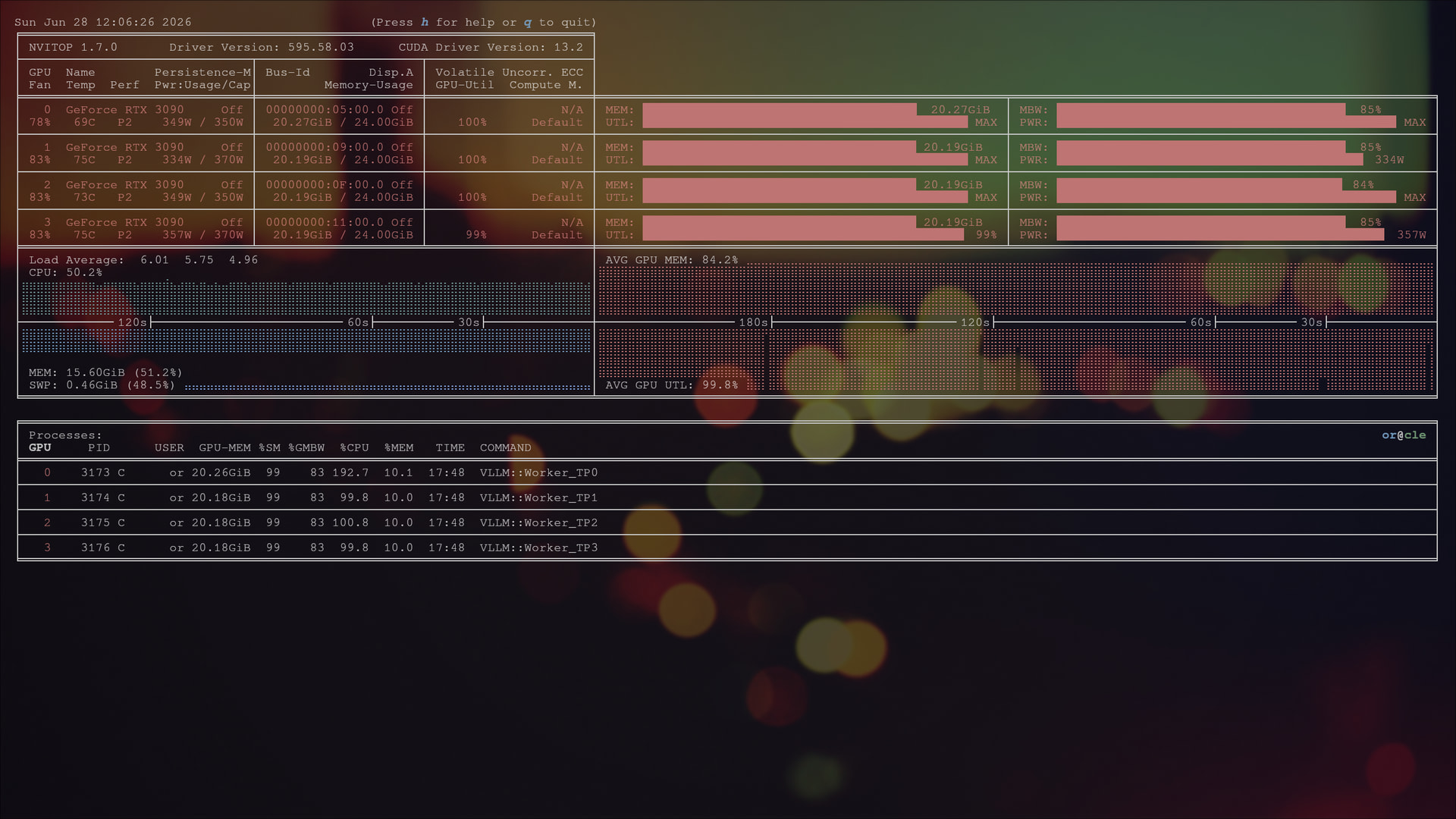

Say hello to my little Qwen
Who da thunk that all these goodies would be coming from the East? Big thanks to all those enabling us, the plebs.

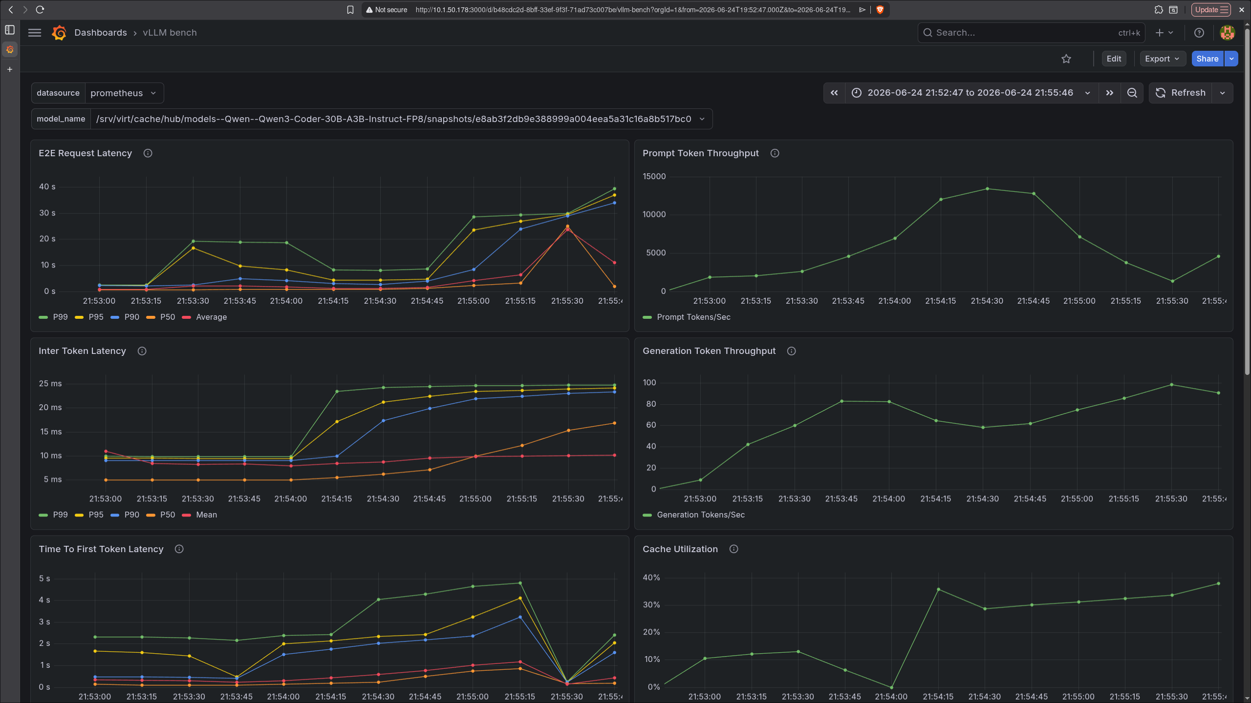

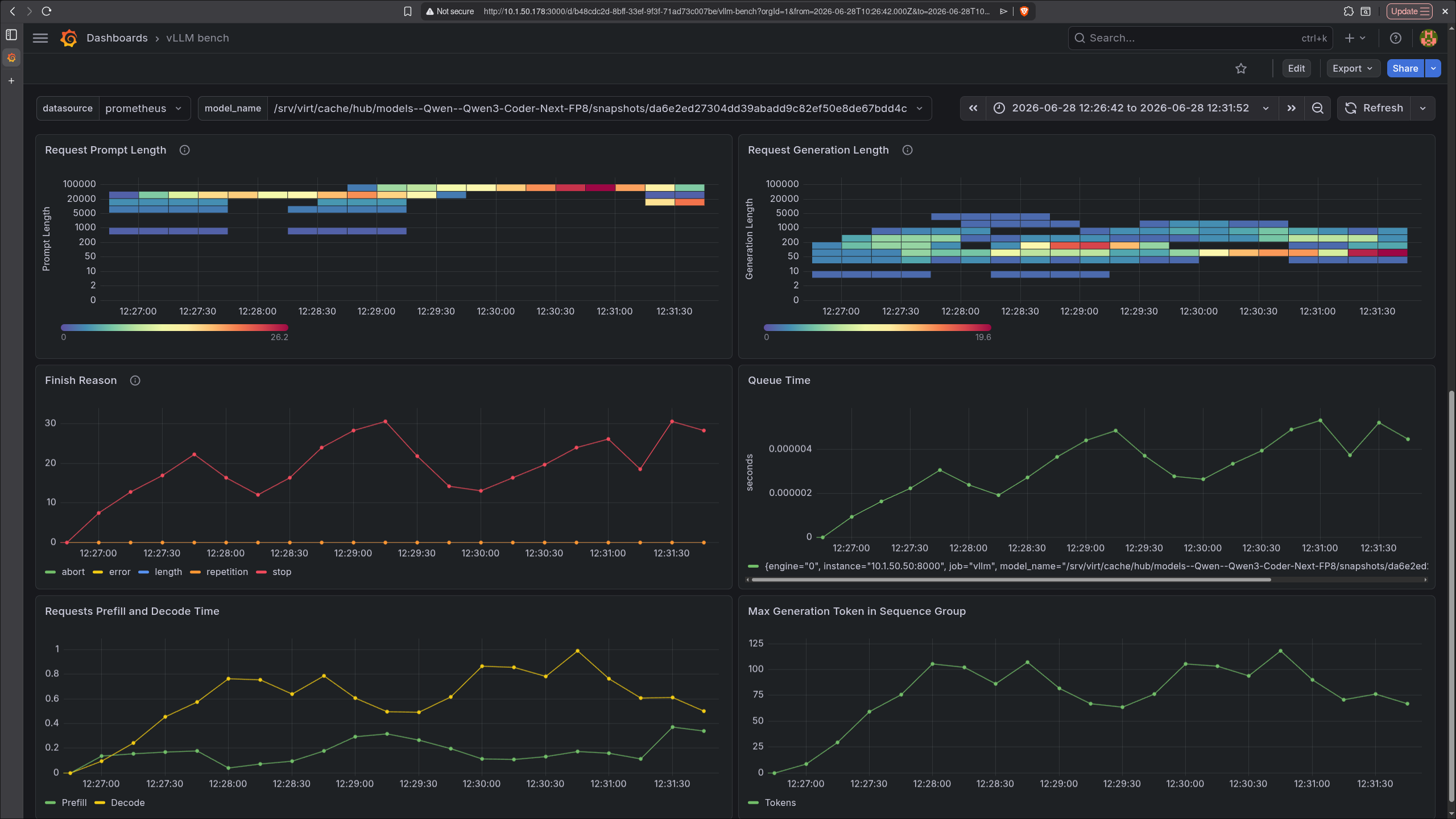

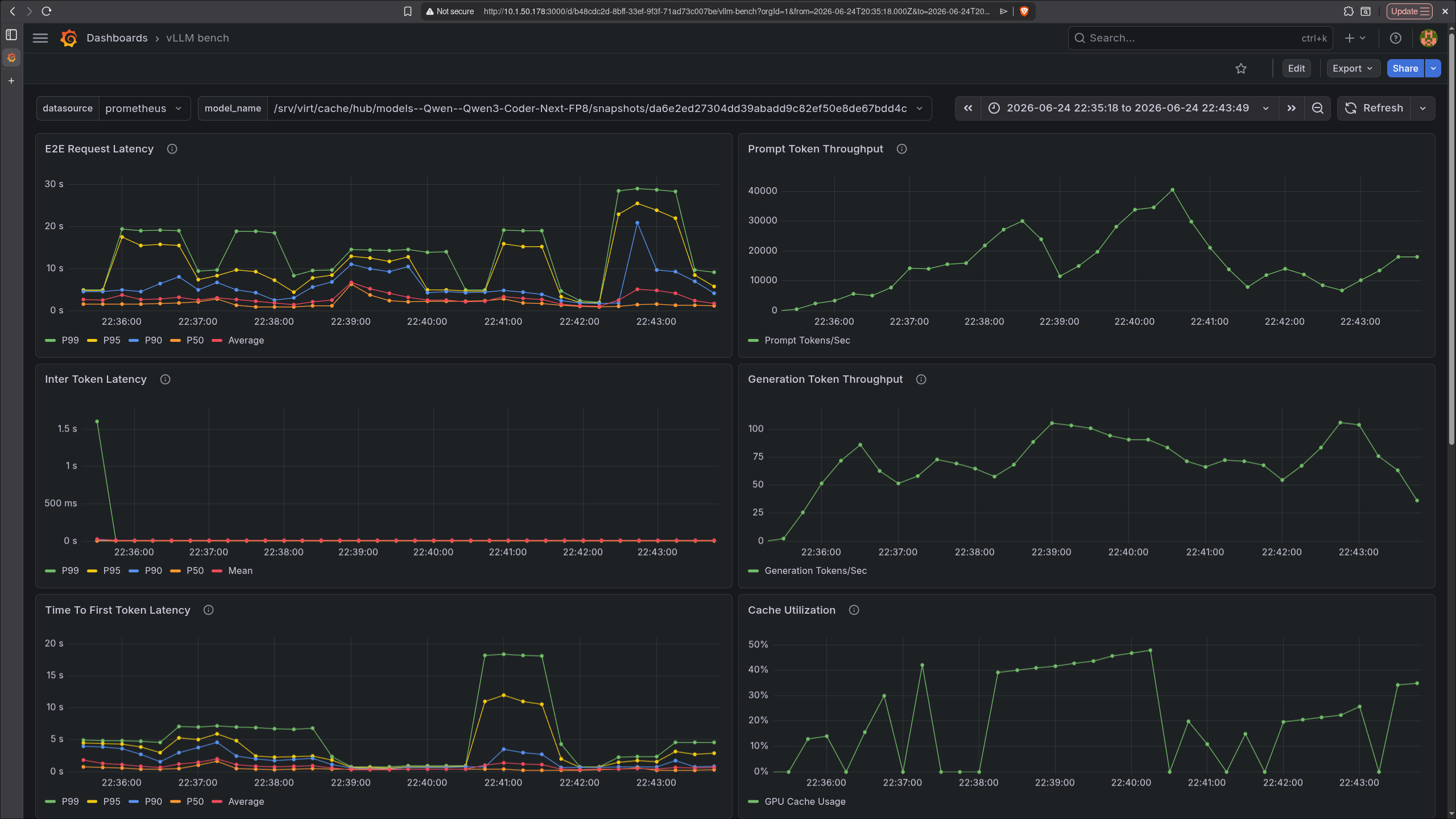

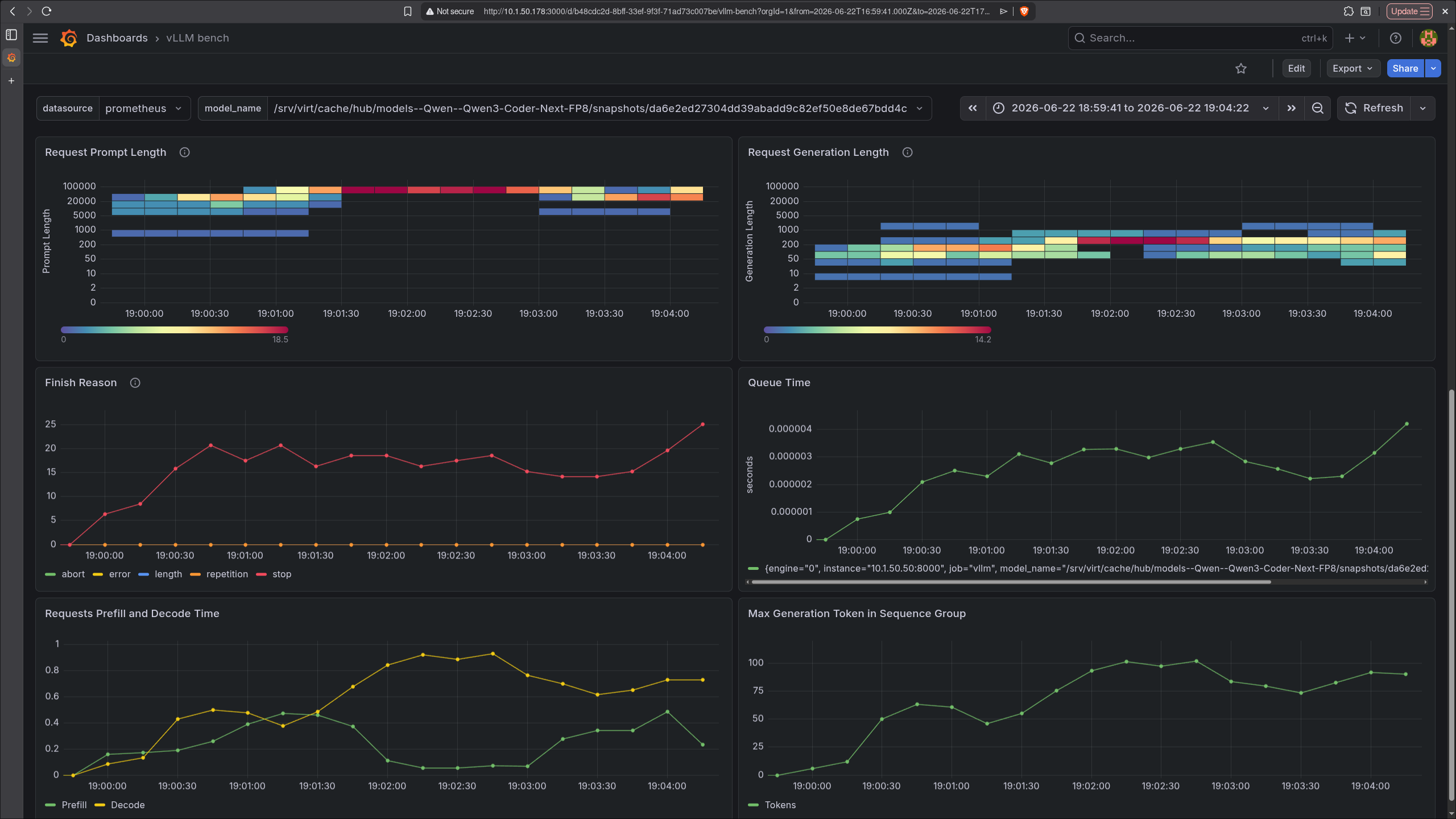

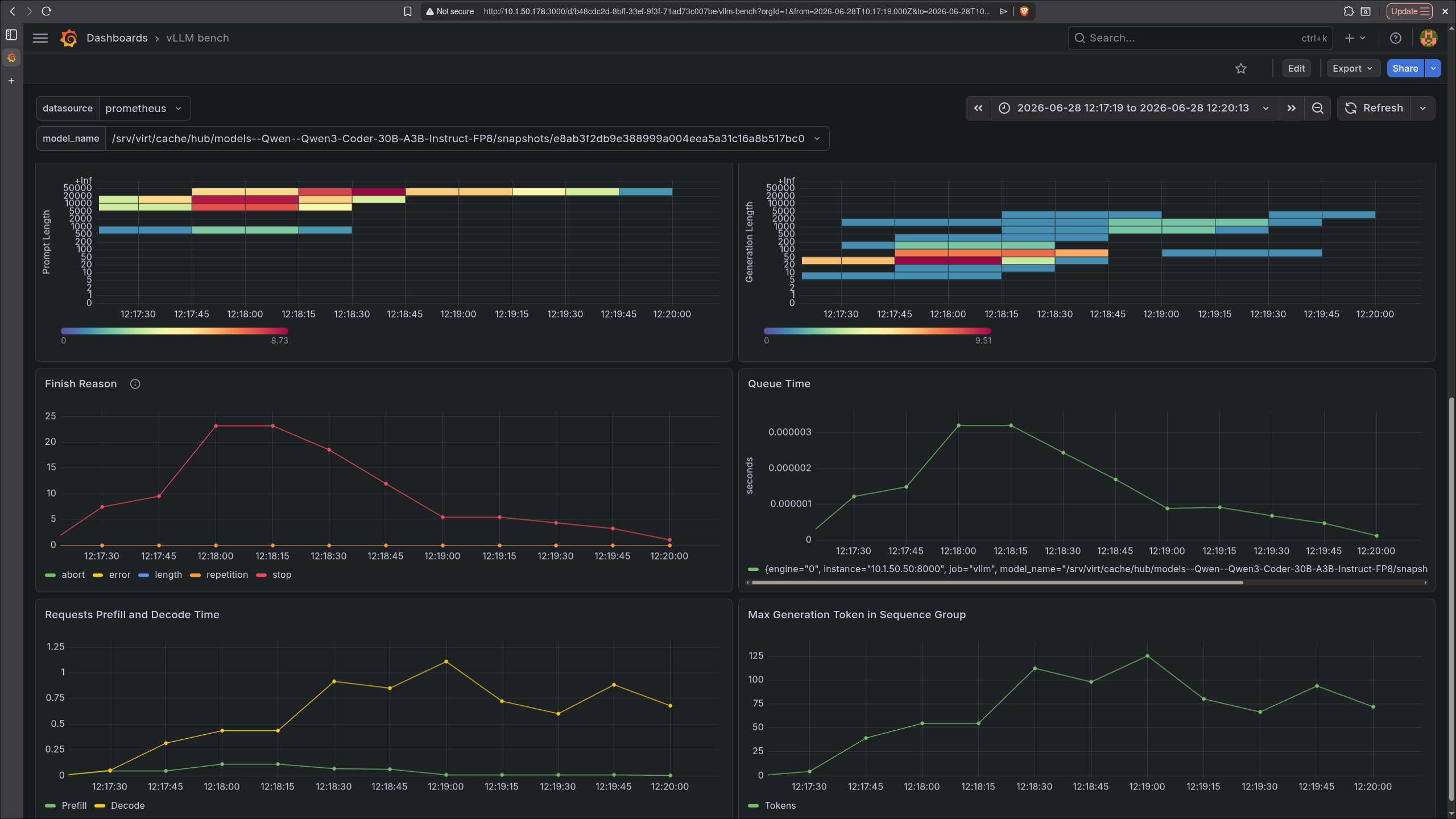

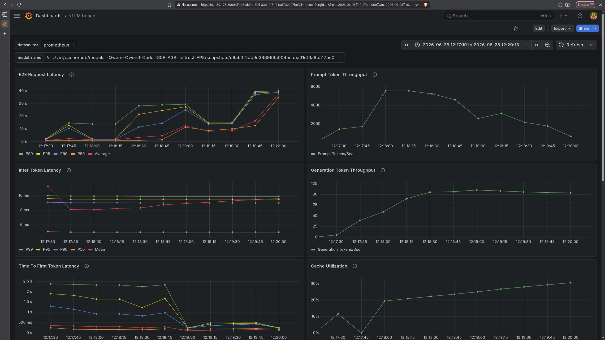

Qwen 3 Coder Next FP8
context length: 262144 natively
As mentioned, Coder Next is what motivated me to get started on this path. I’m still glad that it did, but I do want to share that there’s an element of luck involved in these kinds of learning opportunities.

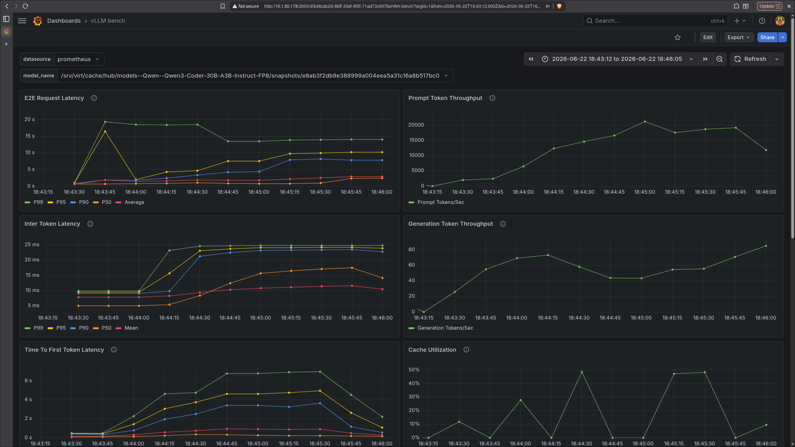

For example, with Coder Next at FP8 on vLLM and CUDA graph enabled (read: without --enforce-eager), I only had enough VRAM left for half the native context length: 131072.
Luckily, vLLM also supports FP8 for the KV cache, which can be enabled with the arg --kv-cache-dtype fp8. In combination with --gpu-memory-utilization 0.94 you can still get full native context length out of it. To be sure, you could definitely do this, there’s nothing wrong with aligning the types between model weights and KV cache.
UPDATE: In his first comment below thr3e pointed out it’s best to keep KV cache at FP16 unless you really know what you’re doing. See also the vLLM docs - point 3 [Recommended] Calibration with a dataset (via llm-compressor).
However, since it’s sufficient for testing and doing these kinds of benchmarks, I left it at FP16 for consistency. It also delivered some interesting graphs.

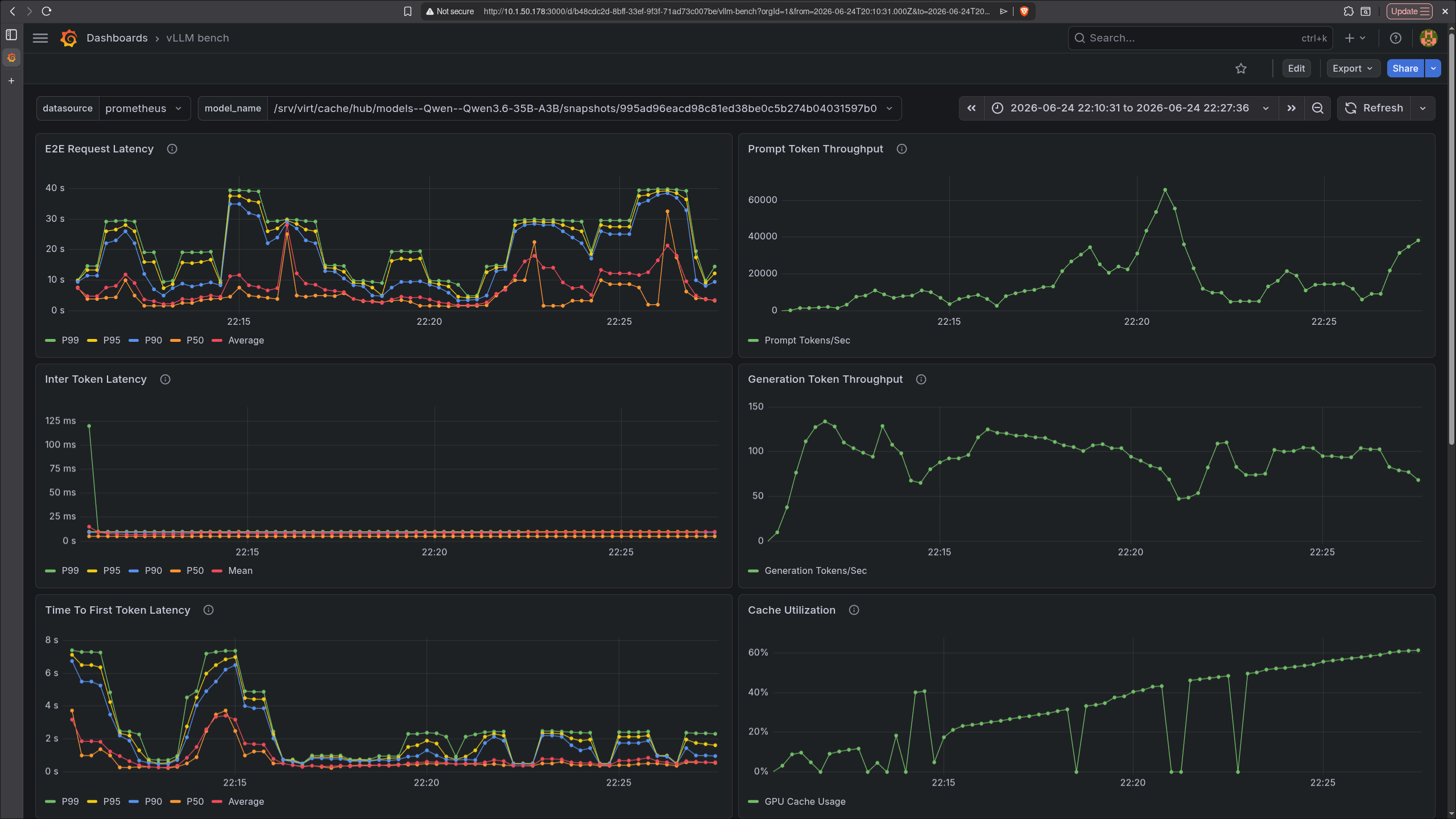

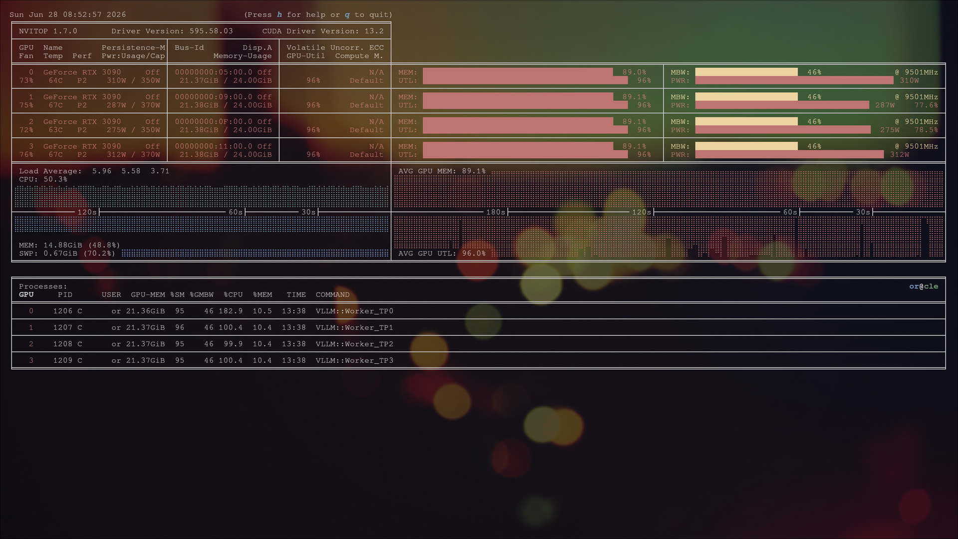

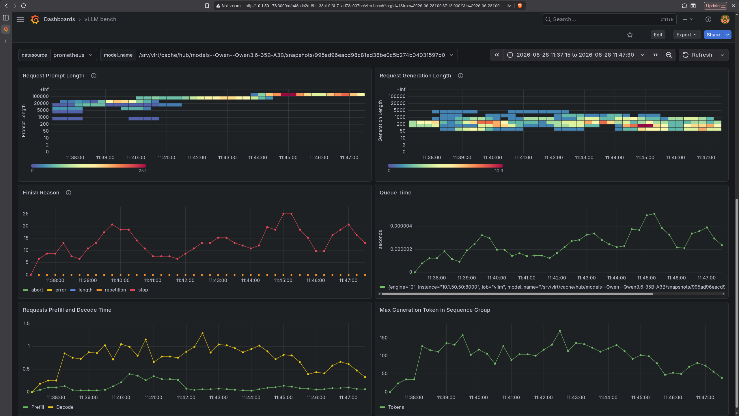

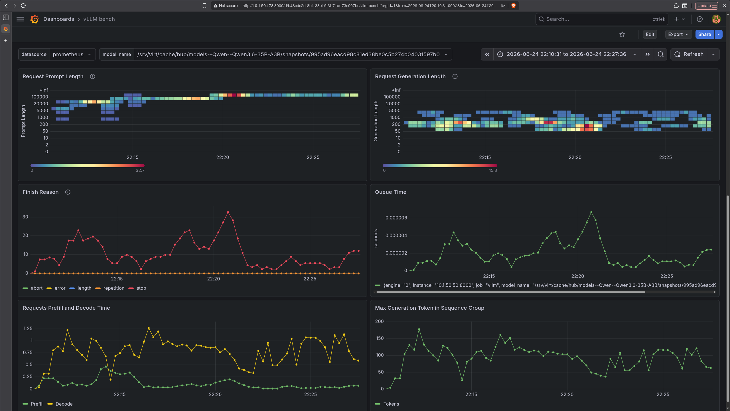

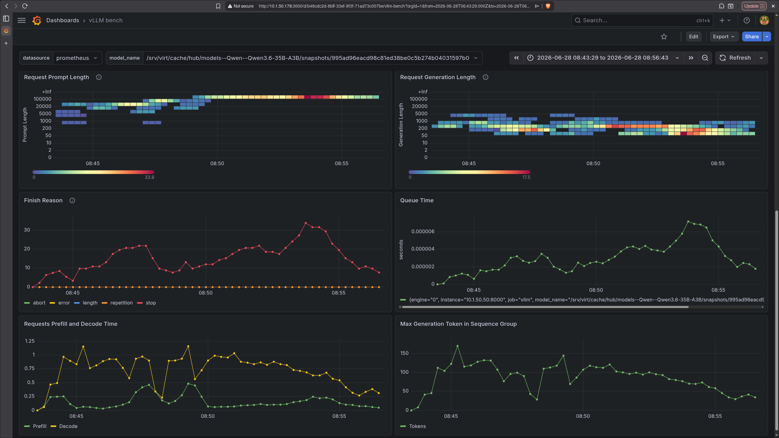

Qwen 3.6 35B-3AB FP16
A model with less than half the parameters, but with full native context at FP16.

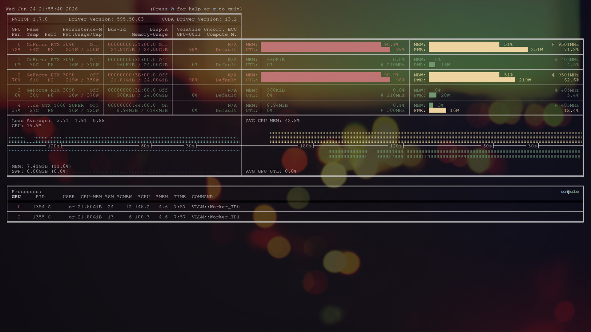

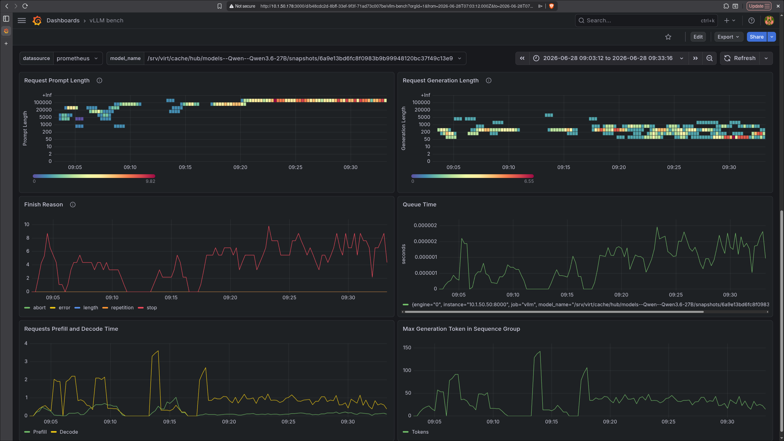

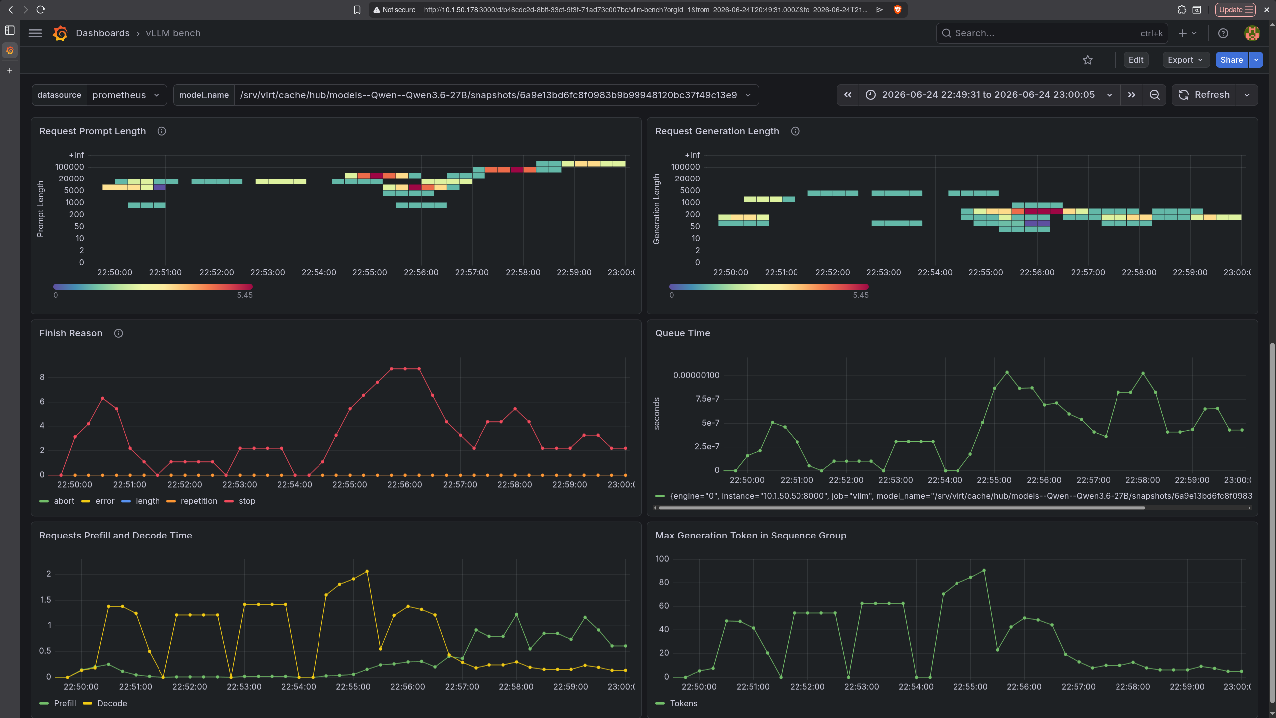

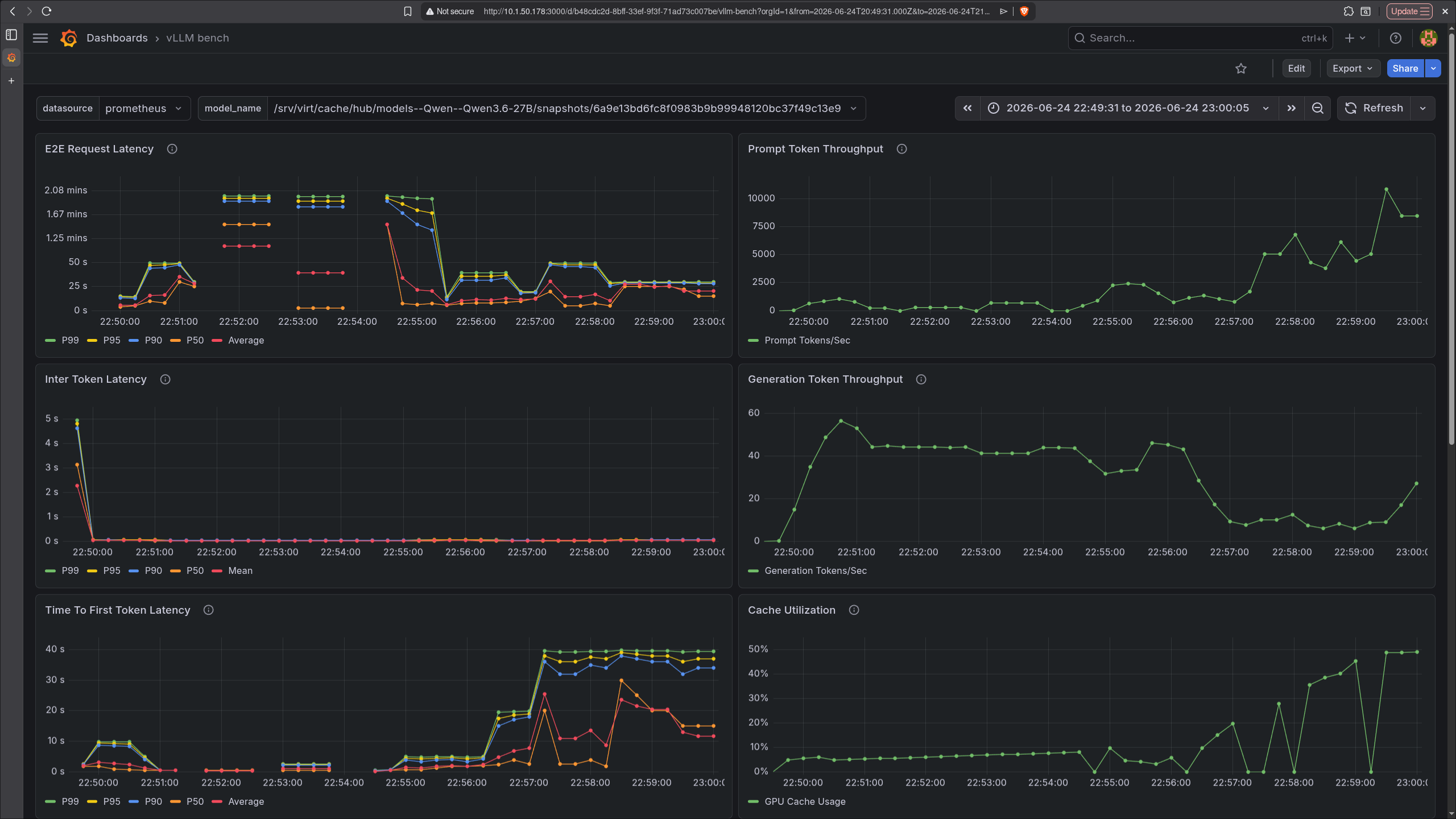

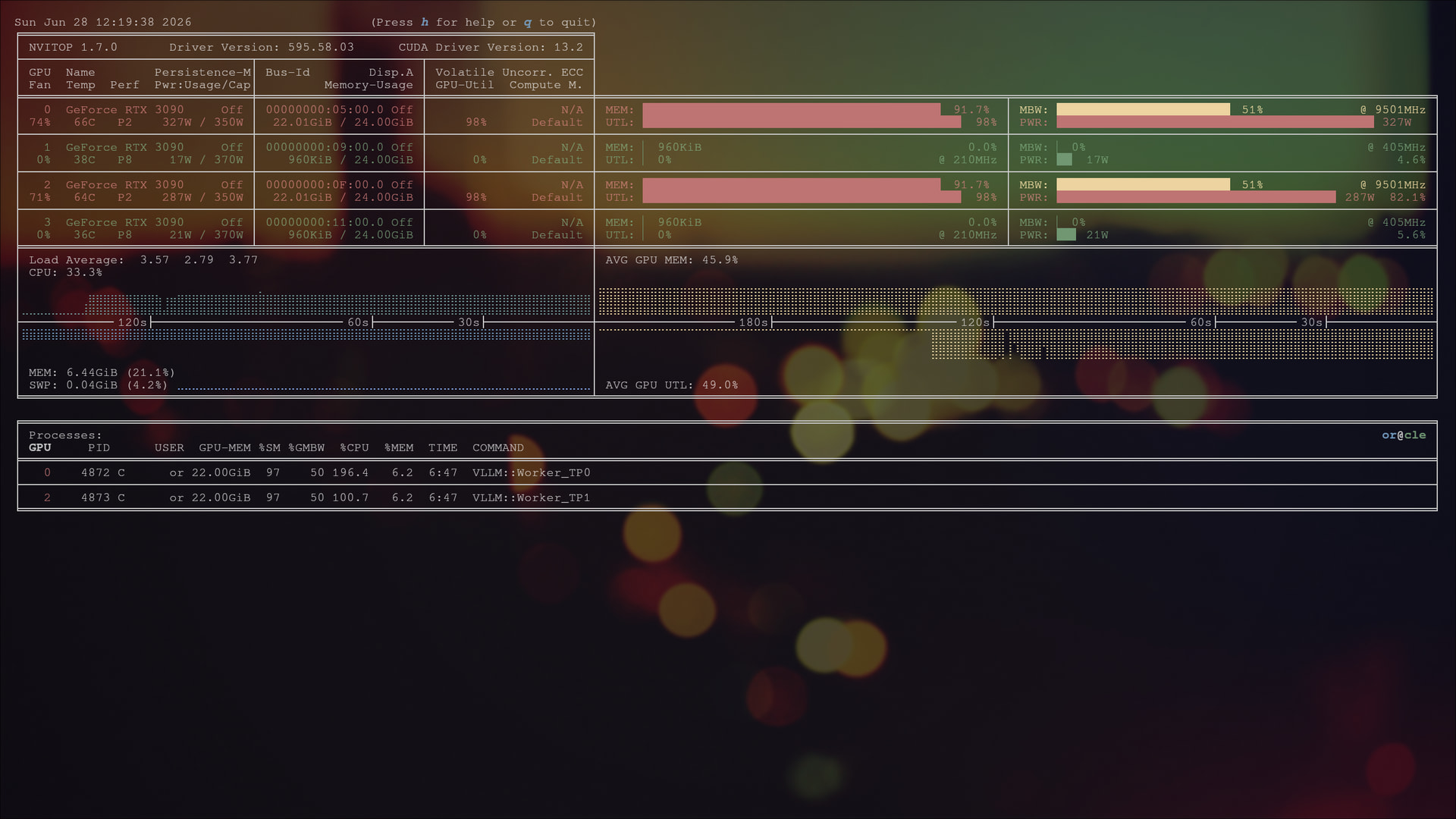

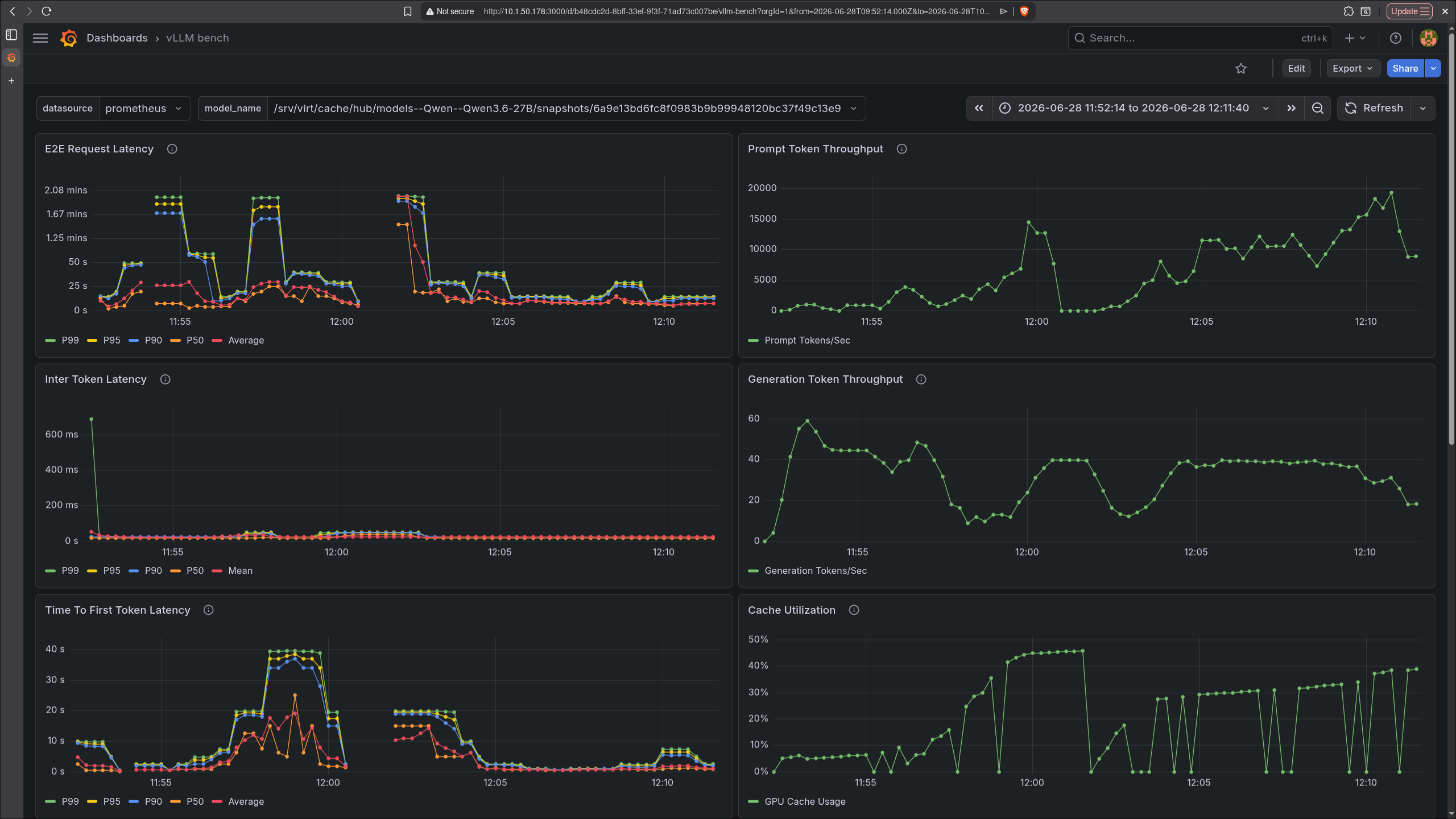

Qwen 3.6 27B FP16

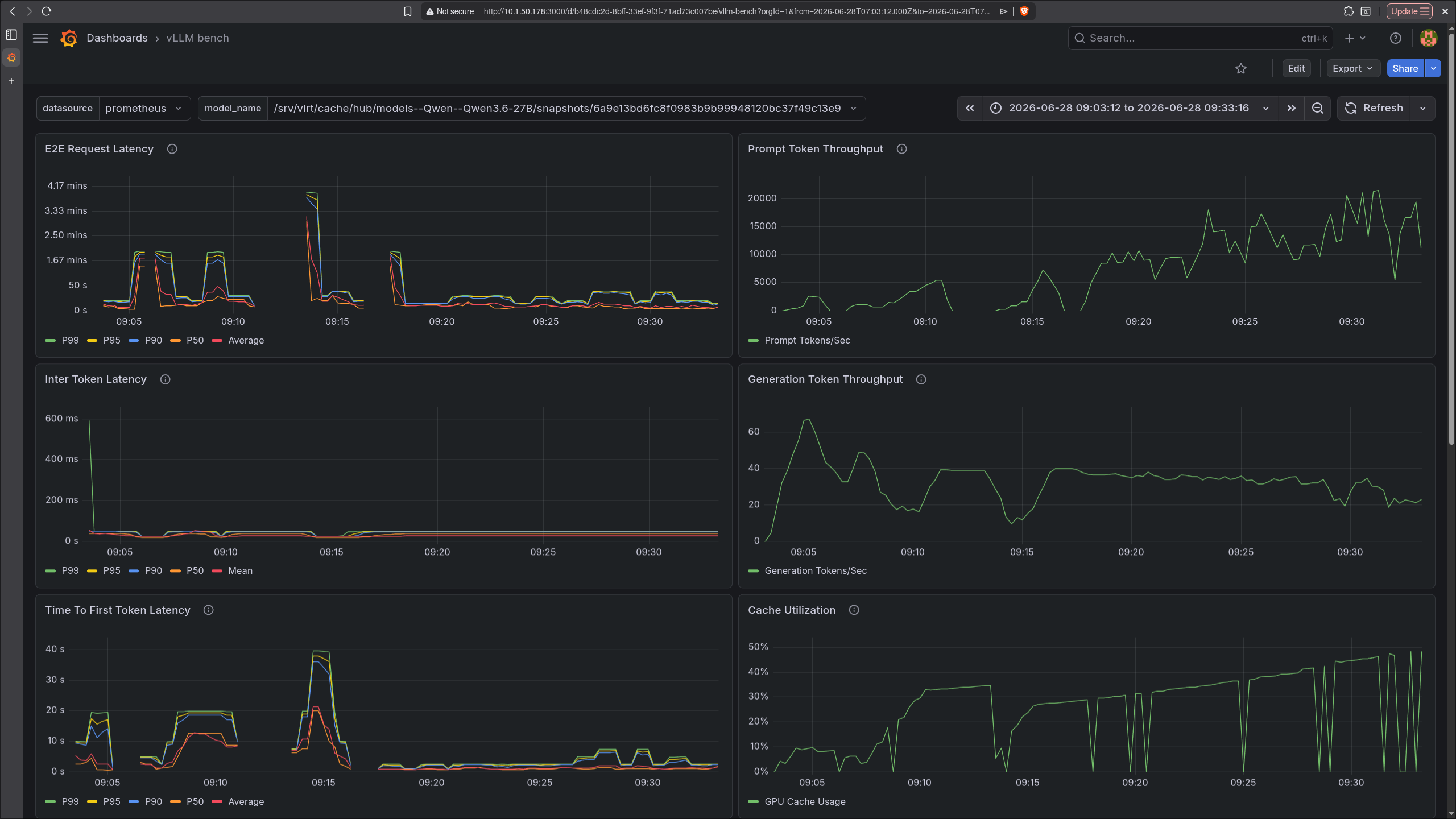

An absolute beast of a 27B parameter model. However, not only did it tax the GPUs harder leading to increased temps, I wasn’t able to get the token throughput up to anywhere near the MoE models’. This is why, at least for the first couple of months, I’m sticking with the other models for further testing.

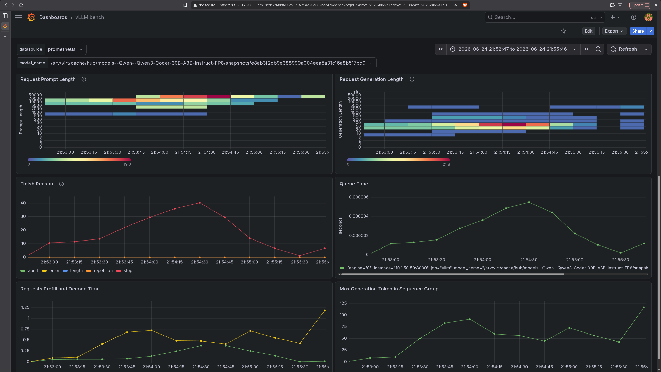

A sneak preview for comparison, on AM5 with P2P enabled:
Qwen 3.6 27B FP16
An interesting tidbit about the Grafana dashboard’s Cache Utilization graph is that it shows the percentage of the model’s native cache size, not the actual size after vLLM serve. For Coder Next the output logs generated by the script show:
This model’s maximum context length is 131072 tokens. However, you requested 32000 output tokens and your prompt contains at least 99073 input tokens, for a total of at least 131073 tokens. Please reduce the length of the input prompt or the number of requested output tokens. (parameter=input_tokens, value=99073)
In the dashboard we can see the corresponding compactation at 12:31:00.

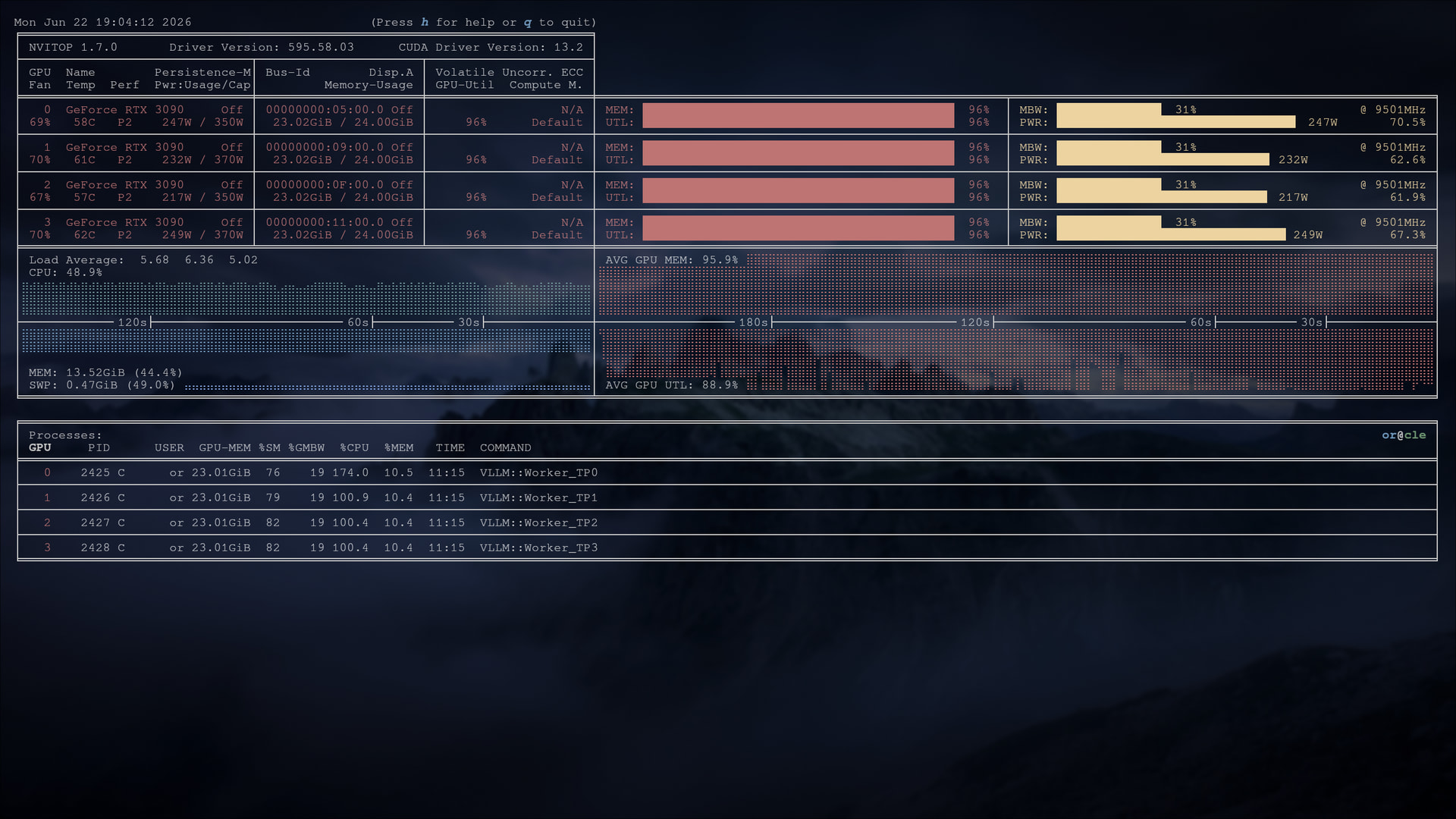

Can you dig it? On a 65 Watt Ryzen with only 6 cores and 32GB of RAM, we’re getting over 100 t/s for our 80B model at FP8 and even more for our 35B model at FP16.
As always, the provided stats and screenshots don’t tell the whole story. Different (generation) models feel and behave differently. If you’re just starting out, it’s a good idea to spend some time (and online tokens) with them before committing to anything.
Just to be clear, this is not intended to be a limited list. We could definitely use a couple more FP8 (MoE) models in the sub 80B range. Taking the context length considerations from the Qwen Next block into account, closer to 70B would probably be even better on a quad 3090 setup.
How about some context
I may have gone a little off script. You know the defining moment when you look into the abyss to find out how deep it really goes?
Just when I was about to move everything into the basement, I learned Jensen’s cake had 5 layers, so I had to up my game once more. Our switch board exposes 2 downstream ports (that even allow you to daisy chain multiple switch boards). I used those to level up to 6 3090’s, still without having to go through the root complex when P2P is enabled.
The idea was to increase the KV cache for Qwen3 Coder Next. Unfortunately TP6 is not a thing, Tensor Parallelism works with powers of two, so 2, 4, 8 GPUs.
You could technically use the extra GPUs to launch multiple vLLM instances on the same root complex, but that’s something I didn’t investigate further.
Full benchmarks
The indicated types are for the model weights only, the KV cache is kept at FP16 throughout all benchmarks.

Everything in this domain is moving fast, so don’t pin yourself too much on the physical manifestation of these switch boards. The ones with dedicated PCIe slots are becoming a thing of the past, reserved for PCIe gen 4. Newer models use MCIO exclusively. As mentioned before, the SlimSAS counterparts (like shown below) may not be easy mode and come with trial and error.
The difference with the switch board I’ve shown, cause that one uses up- and downstream SlimSAS connections as well, is both the connection with and distance to the GPUs:
  • The connections between the switch board and the GPUs are the physical PCIe slots on the switch board and do not use SlimSAS themselves.
  • Depending on how you hook everything up, you can eliminate the distance all together. The distance can often also be made shorter than when you’re still in proximity to the main motherboard.
Last but not least, it also got plenty of juice, as mentioned here.

There are 3 different places to quantize, with 3 different impacts. Weights, activations, and KV cache. Weights you can quantize down quite nicely to 8 bit, sometimes even mixed precision models where some layers are 4, some are 8, etc.
But do not quantize activations, or your kv cache. Those are the two biggest killers of precision. Measuring the impact of this is tricky and requires real datasets and benchmarking, but I have completely abandoned trying to quantize kv cache and activations as they often turn out to be far more detrimental in the long run.
