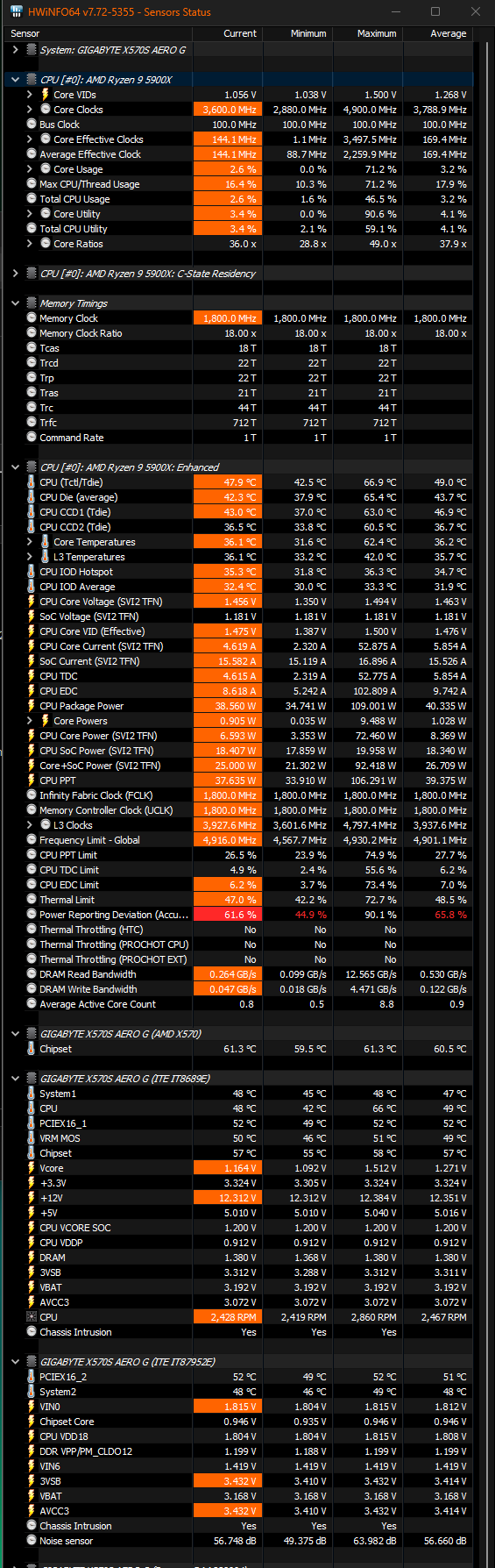

Having a look at things in W11. I noticed this in HWinfo…
I’d make sure you bump the voltage… I experienced crashes on an ASUS board with mostly stock settings when attempting to go from 64GB to 128GB ECC … it was only once I manually set the voltage on the memory slightly above spec (1.2V spec … set it to 1.25V)
I started with the lowest clocks… and just kept slowly bumping up until I hit the spec on the package… 3200 Mhz
if this doesn’t work I’d probably yes… look at getting sticks off the QVL like I did.
Bump the voltage on the memory itself? or the IMC? Sorry, a bit confused. Is that VDIMM or VSOC/SVI2?
Here is main screen from my BIOS area. I didn’t touch any voltage settings.
But some people are advising that I adjust some things like:
  • To enable Gear Down Mode also, which I did this morning but have not noticed much. I am not really stress testing or benchmarking either, just as an FYI. Just using system normally/casually.
  • Suggested to try VDDP to 0.950 and AddrCmdDrvStr to 24ohm.
    • I don’t know what VDDP is in my BIOS.
    • All the AddrCmd stuff is set to auto in the timings section.
  • Apparently my VSOC is too high? Assuming that is VCORE SOC in my BIOS, its on auto.
    • ZenTimings: 1.181v
    • HWInfo CPU: 1.181v
    • HWInfo MB: 1.2v
  • Suggested to increase VDIMM voltage to 1.4v. Is this safe?
    • ZenTimings: 1.35v
    • HWinfo MB: 1.38v
All this readings are in idle, more or less, just web browsing and trying to figure out this situation.
