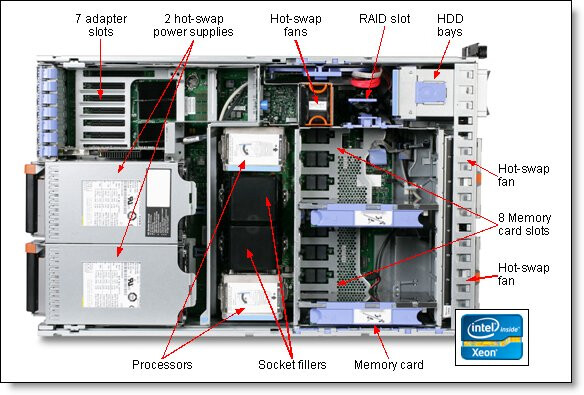

Hey, I am trying to pick an GPU for for my IBM X3850 X5 4U rack server. I can do full-heigth 1 or 2 slot GPU. But probably 2 slot would be preferable even though I do loose an PCIe-slot, but the one next to the X16-slot is wired as x4 in terms of PCIe, and I have plenty of space left for other stuff. The slot on the server is an PCIe 2.0 x16, and on the photo below, it is the top slot.
Source:
I am also thinking of buying an adapter cable (I think the source on the server side is ATX EPS12V), so I should be able to setup power for either 1-2 PCIe 8pin or 6 pin.

Maybe, maybe not. There is a pair of 80mm server fans not far from the Pcie-slots.
