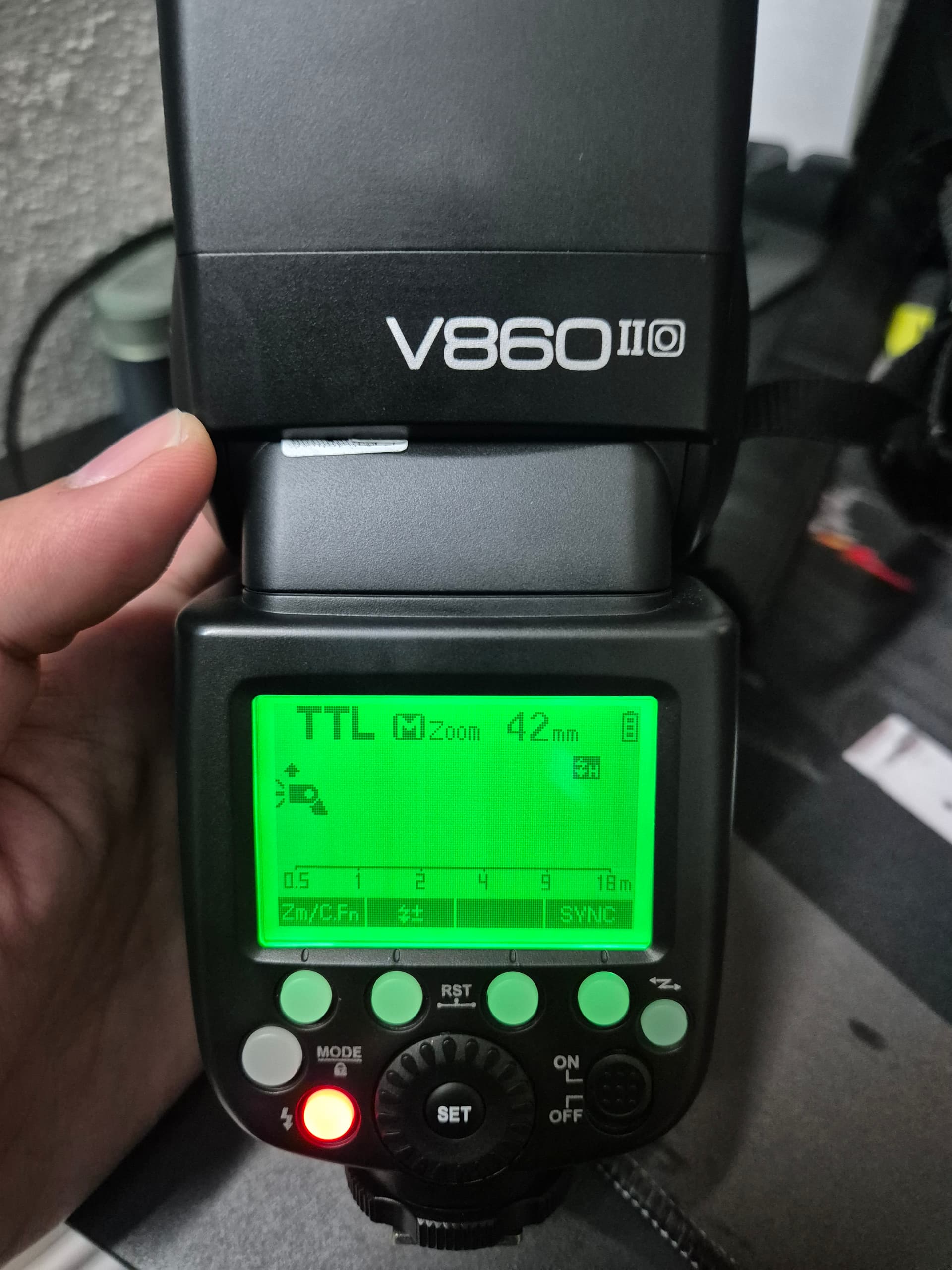

This is the Godox flash module I use. I recalled setting up the sync with my camera. All my shoots with this flash has been done using this configuration.

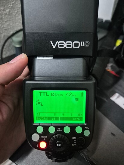

Oh I was just testing the shutter speed to confirm the correct figure. So this was done without any lens attached. The one below would be with a lens attached.

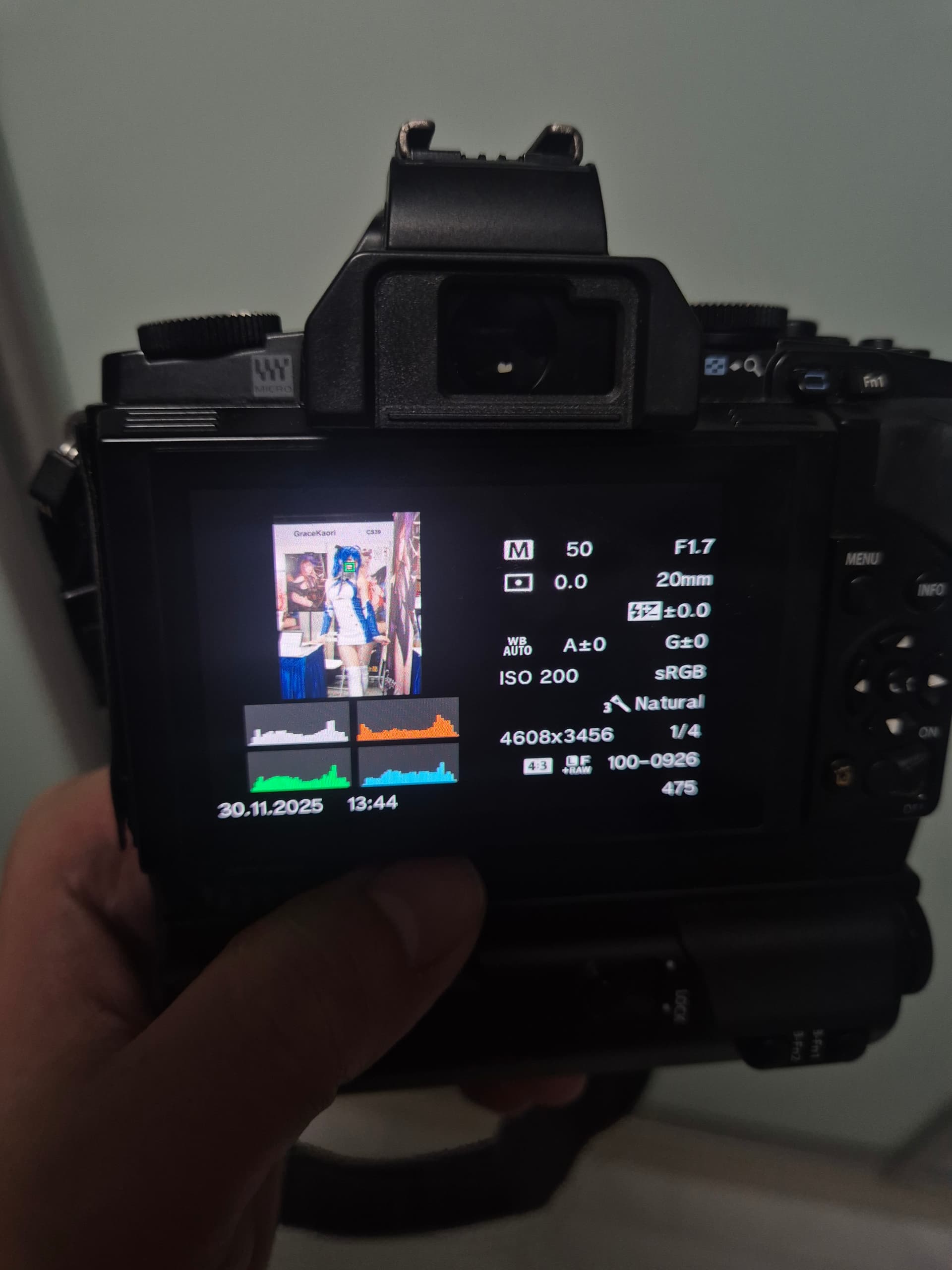

An example of a shot going out of focus. I remembered I did focused on the face before making the shot. This was not noticed on camera screen by us
Yeah, that’s just out of focus. Background is clearly sharp and the way her face is diffused is clearly done by the lens. I expect that to get fixed when you switch from AF-C to single point AF-S.
That photo looked to be focused on the background.
Focal point may have changed between when you saw the indicated focus point and the shutter release. The camera may have jumped focus onto one of the faces - or eyes - in the background.
Some cameras store where the focus point is in each picture’s EXIF data and/or in the raw image. You can find out what happened with that, if it is available.
This seems to suggest it’s focus on the face tho. Unless it was the face detection messing things up. I have since turned it off.

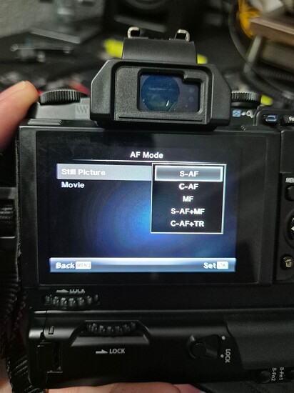

What other focus settings do you have available?

Doesn’t really matter. Issue is backfocus exceeds front DoF.
I’m not familiar enough with Olympus AF to say with any confidence but, given how moronic most AF algorithms are, face priority ignoring the focus point to pick a different face is certainly plausible.
S-AF with face priority off should be a good test towards reverse engineering the algorithm. @JWNoctis’s 100% suggestion’s a good check for evaluating whether focus can be correct in simpler conditions.
Of the four mid-2010s ILC bodies I’ve owned, they were all too stupid to manage basic stuff like this entirely reliably and were not uncommonly outperformed by point and shoots and phones’ greater DoF.
While @RazorLR1 at least hasn’t mentioned the EM-5 II crashing or locking up so hard as to require battery removal and lens changes to reset, technically it may not actually be a defect. Usually the default’s to allow (e-)shutter release without focus lock, so if the shutter button’s getting pressed before focus confirmation’s displayed then an out of focus image is expected. Or it could be wrong face confirmation.
Having only briefly used an EM-1 out of Olympus’ offerings I can’t really assess how likely this hypothesis might be. But it’s at least not wildly inconsistent with practical observations I’ve read from others on Olympus CDAF behavior in this era.

These are what I have available
Idk if this helps, but this sudden out of focus problem only occurred when I was using the prime lens. I never have this issue for the kit lens. I did suspect it might be because of the wider aperture (f/1.7 vs f/3.5+) I was operating at. The combo of 1/50 + f/3.5+ was my settings with kit lens.
I didn’t fine tune the settings or test it much till the con day itself.
