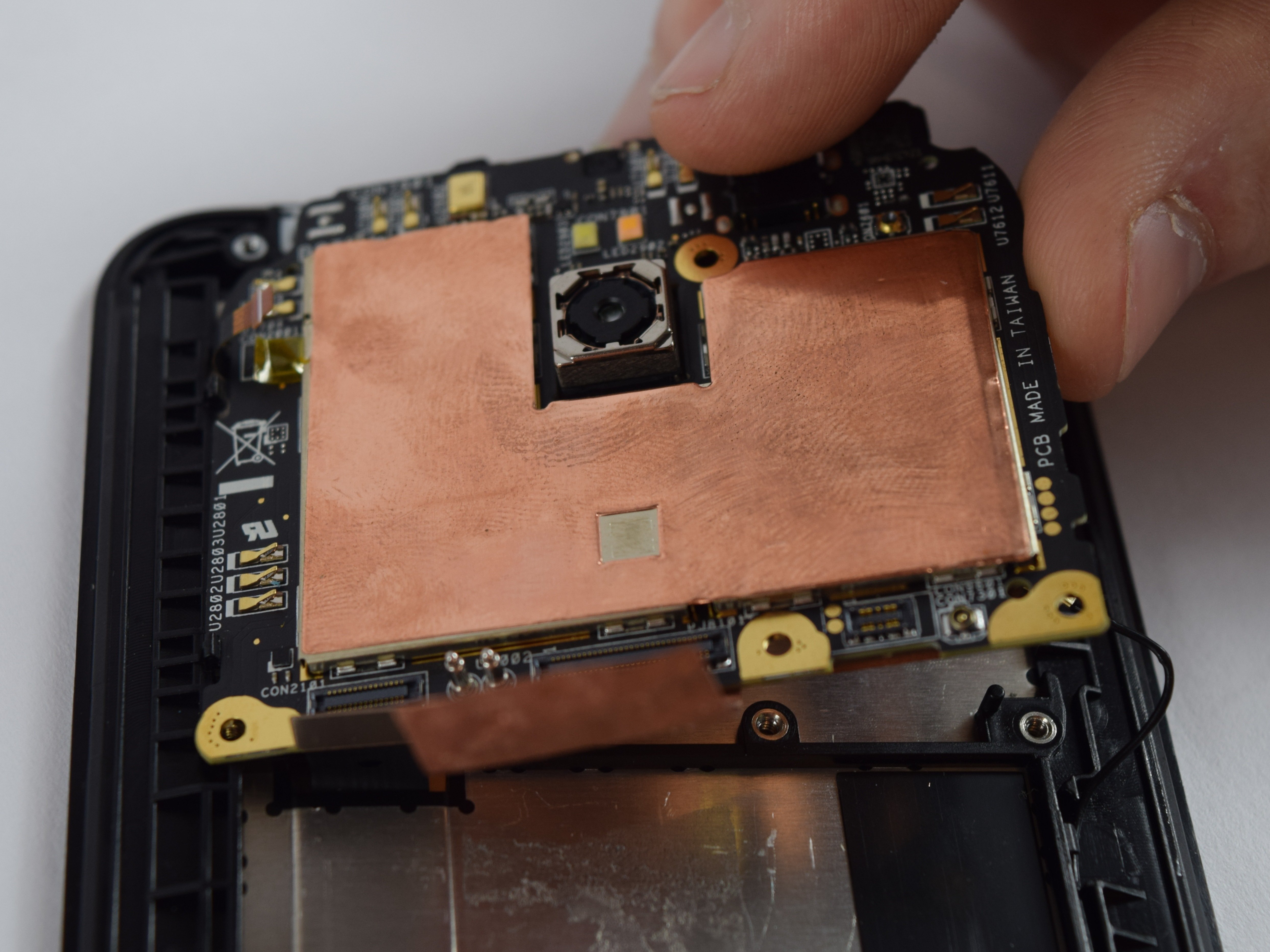

First I would make 100% sure that its not the cable/headphones before doing anything drastic. Barring that it looks like the headphone jack is mounted to the motherboard of the phone, rather than a separate board. So in order to fix the jack you would need to solder a new one on. You can also replace the entire motherboard, but googling some prices it seems that would be rather expensive.
This guide might help if you decide to open the phone up:
https://www.ifixit.com/Guide/Asus+ZenFone+2+Motherboard+Replacement/59913

Most headphone ports just use a ribbon cable and a connector to connect to the motherboard of the phone. Will not be hard to replace but tracking down a replacement will

The headphone port is soldered onto the mainboard and will require soldering on a new connector.
