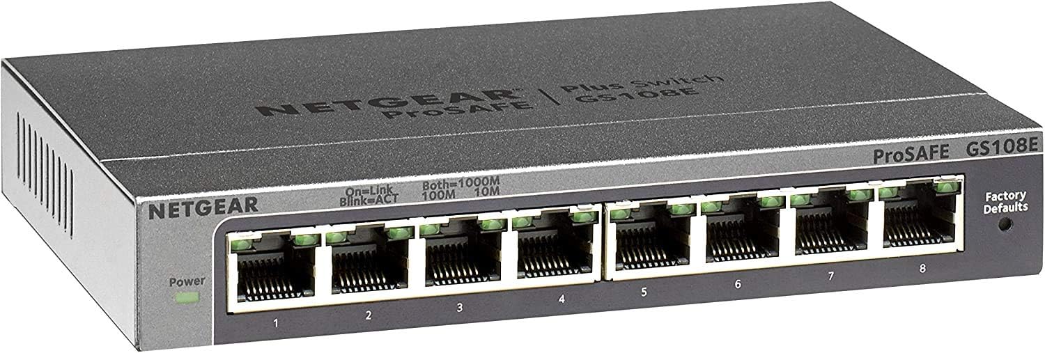

@01SAF If you do go this route and need a fairly cheap managed switch I use a 8 port NETGEAR ProSafe GS108E and it works great. You can also get a 5 port version that is a little cheaper.
