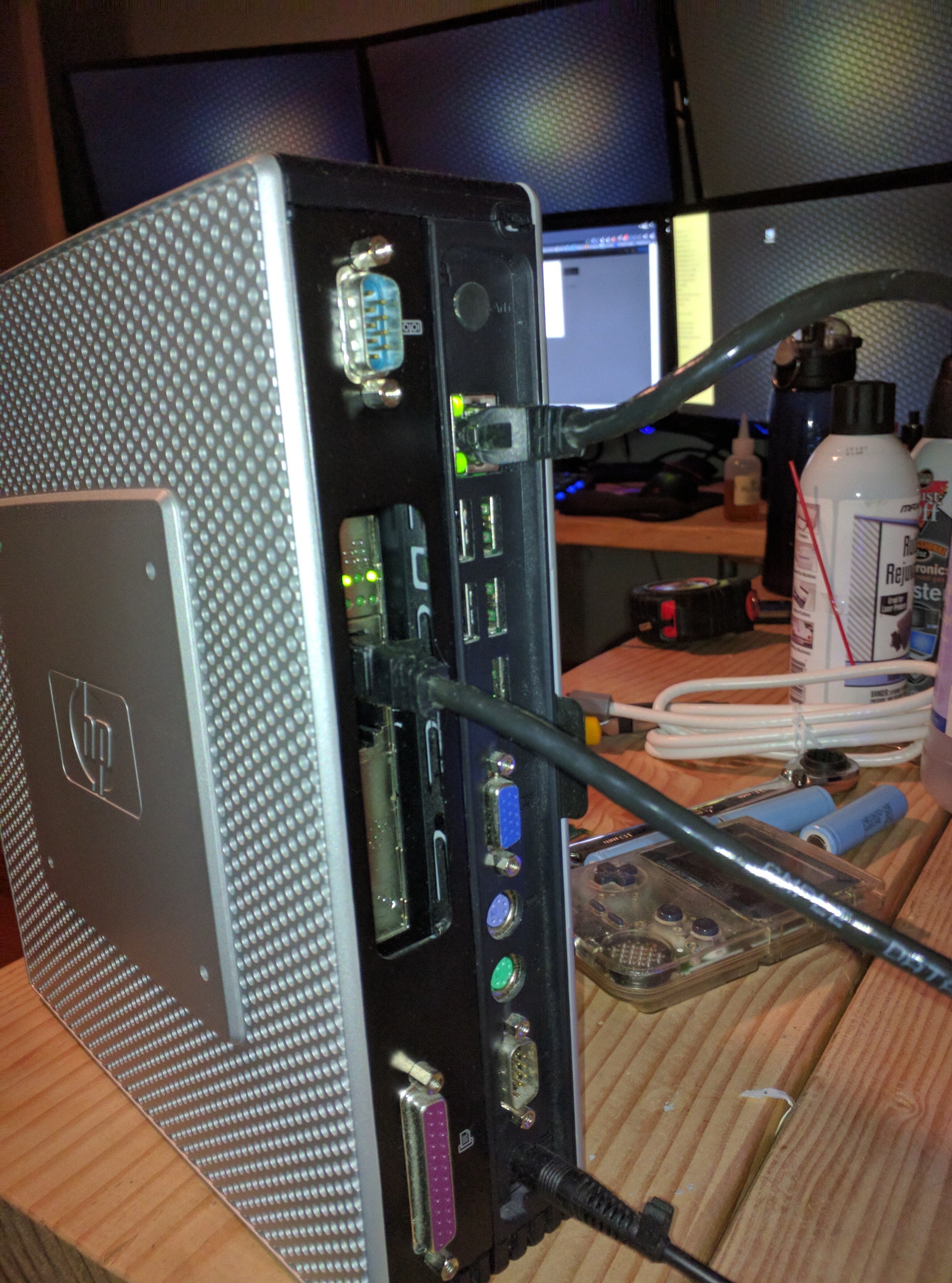

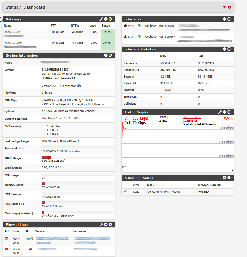

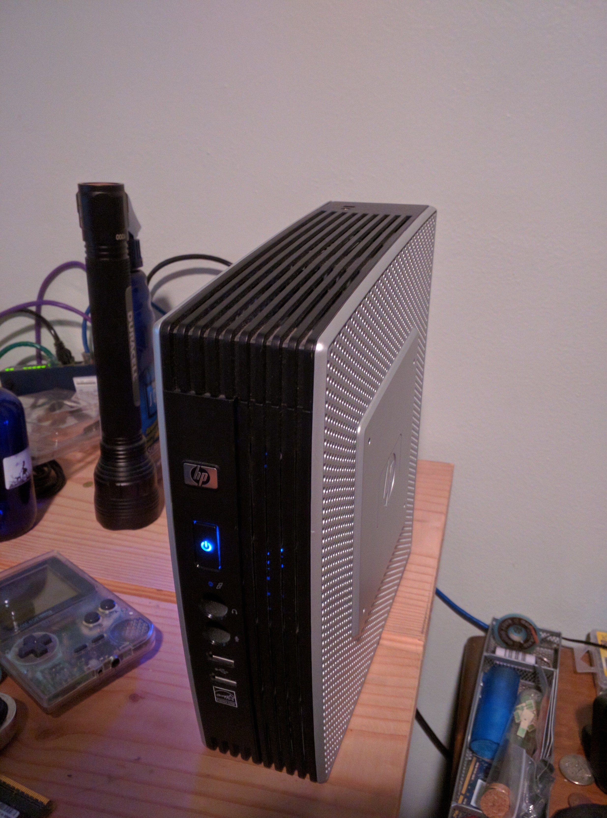

I use pfSense at my house and in the businesses I support. I use a setup which is relatively low cost and high performance for 10 - 50 users and 5-10 VPN users.
I use a HP or Wyse thin client with a pci-e expansion card for extra nic ports
Models include HP T5740, T610 Plus, and Wyse Z90DE7
Most units are $50 - $150 and can support 4gb of ram, and a sata SSD on ebay
Older units use a Intel Atom N280 32-bit and newer ones use a AMD Dual-Core T56N 64-bit
Units with 8gb or larger internal drives use a 1.8" SSD on chip and have the ability for larger drives.
Here is my home unit for now looking to upgrade to a 64-bit model
Feel free to ask any questions I think these thin clients are drastically overlooked for their potential.

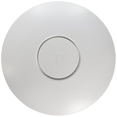

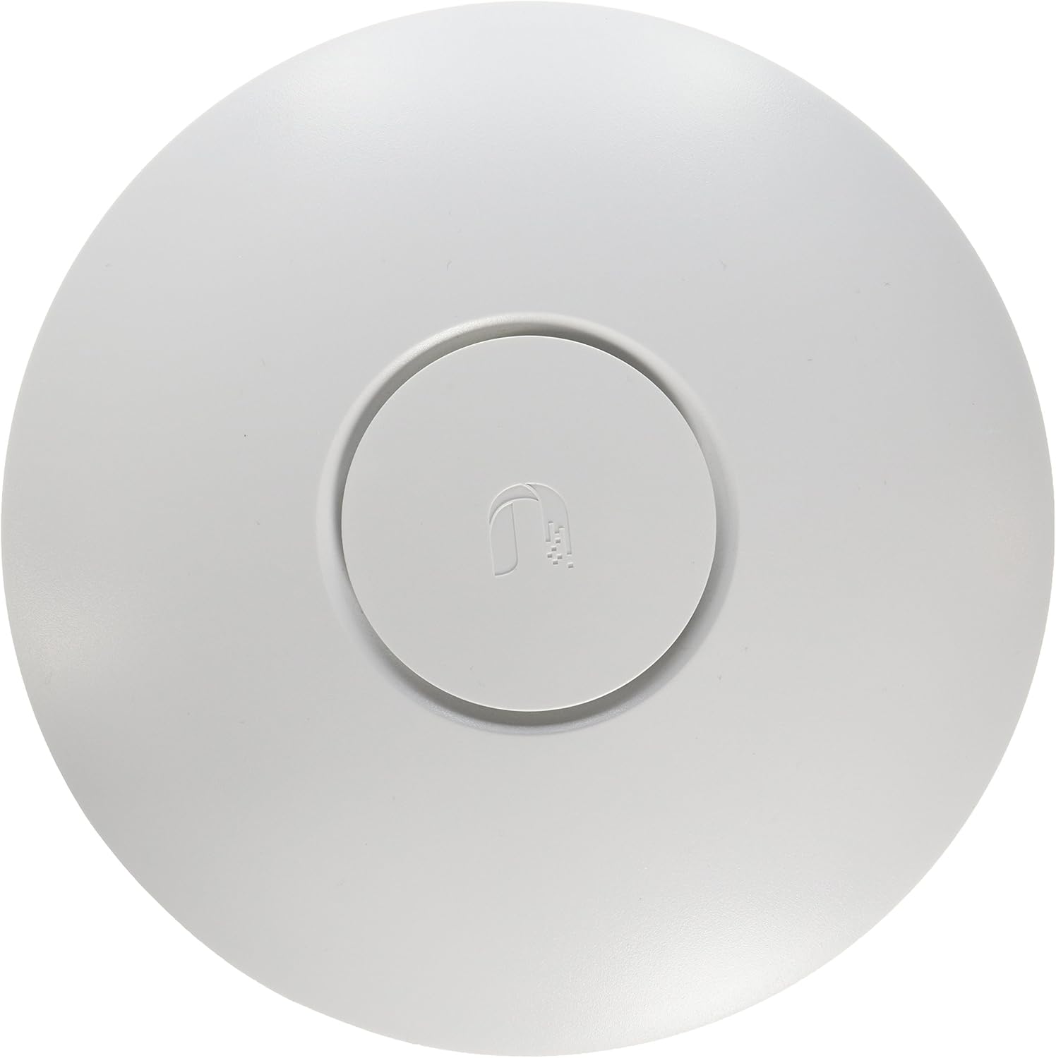

At work I run pfSense and 3 Ubuquiti Unifi b/g/n Access points. They work amazingly well. You can get a single b/g/n Unifi access point for $56 at Amazon. About $20 more for the AC model, but their AC models were flaky at one point (I haven't looked into them recently to see if they have improved).
I wouldn't run their router, just on principle of it not being pfSense. After using pfSense for the last 3+ years - it would take a very compelling product for me to change.
You could hang it on the wall with a push pin. They don't weigh much.
I have one of the AC models and haven't had any issues with it, works as intended and has had at least three firmware updates since I've owned it so they are still supporting it at least.
Sounds great to me then, so first will be buying an small device for pfSense and then buying myself probably the AC version since @MichaelLindman hasn't had an issue with his.
