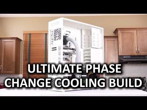

You can but it'll end up something like this.
It's pretty tricky and on top of that you have to be cautious about your temps on both sides. Gets too hot you risk heat damage, gets too cold you worry about condensation. IMO not really worth it, but if you have a spare system to screw around with might as well do it. FOR SCIENCE!

@Big_Al_Tech Peltier plate is different than a condensation cooler used for refrigerators and stuff.
Yes but peltier can drop temperatures enough to cause condensation. Just need proper insulation.

Yeah, but what you've shown is not a peltier cooler in my opinion because I can see a pump there. Anyway I hope you don't get wrong my attitude to being precise (:
Its both.
http://www.tomshardware.com/forum/282844-29-peltier-water-cooling
Oooh okay, couldn't tell that actually. Might be a better idea a peltier water cooling.
That's a water chiller, not a condenser. That setup uses two TECs cooling water blocks to chill the liquid which is stored in that reservoir.
@CantorNikolaos
Honestly this is the best way to incorporate TEC into PC cooling with modern requirements. Direct-contact TEC cooling requires 300W+ multi-stage TEC plates and by that point the amount of metal you need to strap to the other side of the TEC to keep it running cool is insane. Water chiller is easier and has better results.
