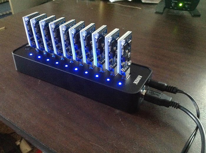

There is plausibility in this as we have to example of this working (kinda) first is as mentioned with the USB memory stick, the second is with the little ASIC bitcoin mining USB dongles.

However shifting all of the processing power to an Bitcoin mining ASIC has its saturation limits. Mainly the bus between it and the CPU of the computer. The reason Bitcoin mining works well on these, is because it is processing heavy rather than I/O heavy, so there is no risk of the connection bus being over saturated. But say your scanning a HDD for something, on USB 2.0 which has theoretical max bandwidth of 480Mb/s (60MB/s). You are not going to be able to read the HDD as the system could. This problem only gets worse with the speeds of Hybrid and SSD.

That is quite the USB hub. It seems my idea/ want is beyond my current capabilities.
