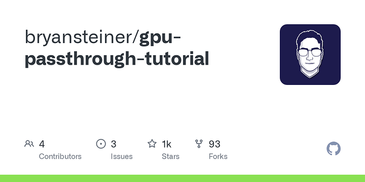

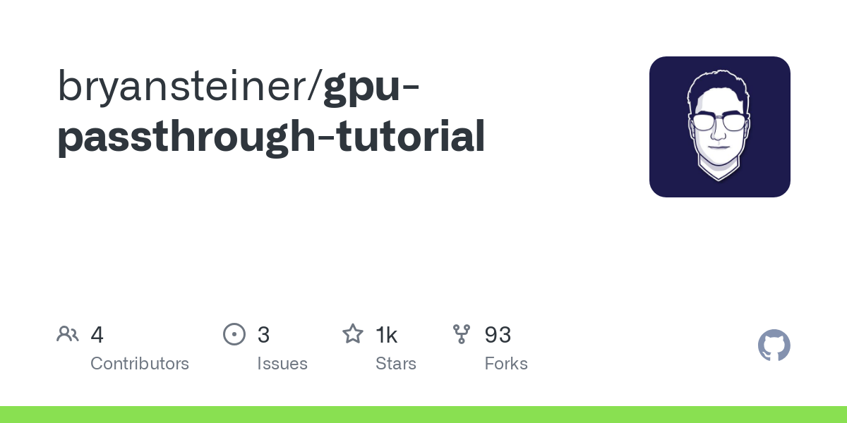

  1. Dynamically unbind the AMDGPU drivers and bind the vfio pci drivers right before the VM starts. You can find instructions here if you want to try that route.
Just do a search for “blacklist” on the page and that should take you to the relevant section.

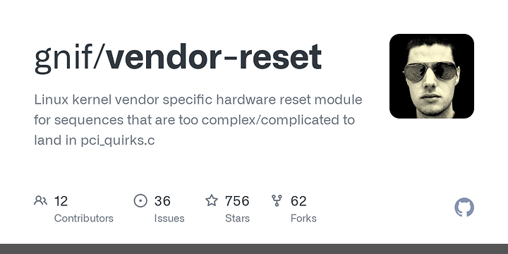

Oh one more thing, if you get past that issue and find that you can only start and shutdown the VM once before the GPU flakes out, search the forums for the AMD or Radeon reset bug for more info. Fortunately for your RX580, there is a fix. Unfortunately for me, there’s not a fix for my GPU (some 6700XTs work fine, others do not).
