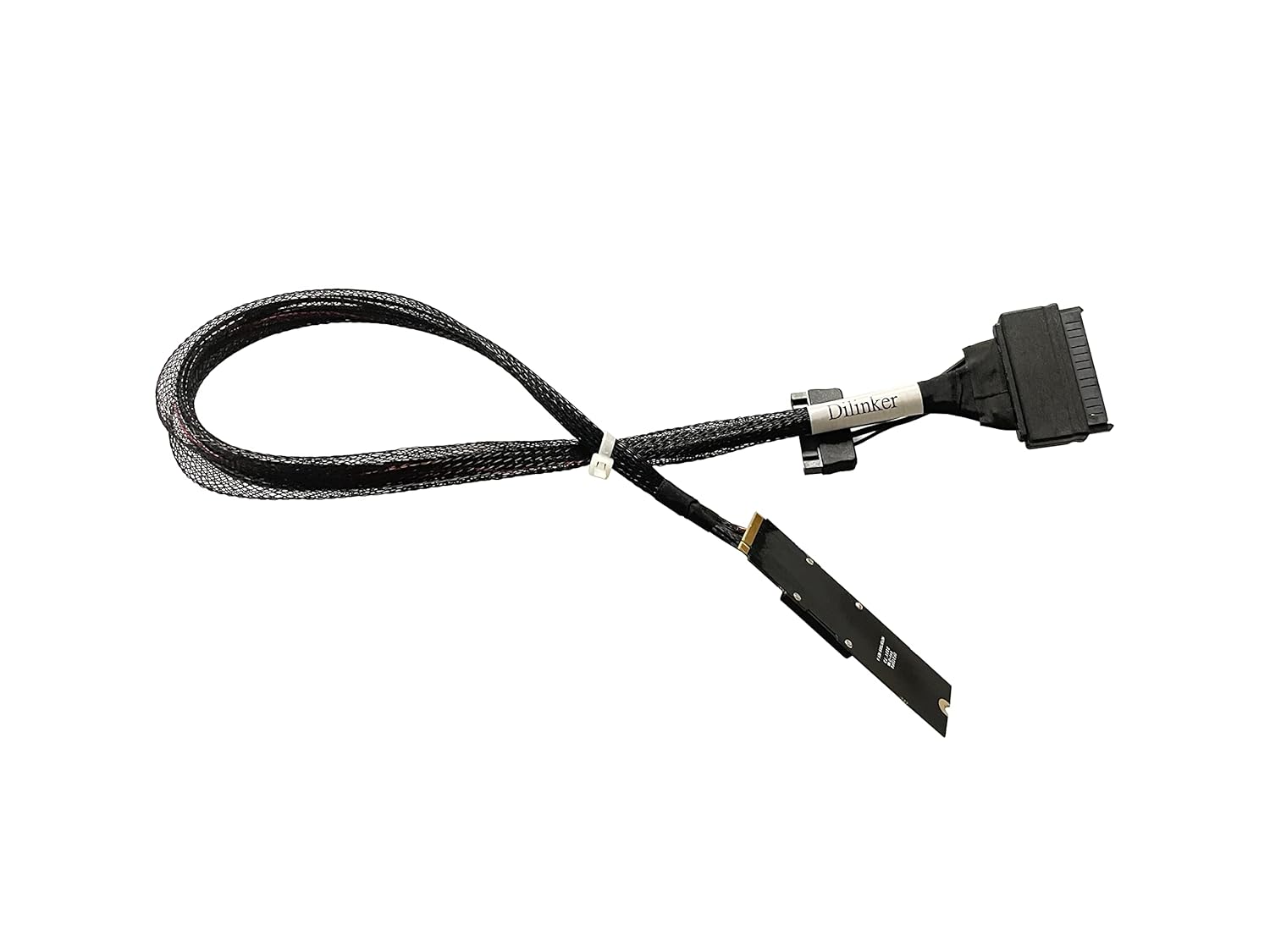

I don’t know if they are the same, but the first one I tried was this one, also a Dilinker cable, and it looks the same from the picture, and it did not work at all with my p5800x.
i remember someone mentioned here previously that this particular gen 4 rated one works , spoke with a friend of mine , he confirmed the same . there are 2 models in their official store , one is gen 4 and other is gen 3 (not rated ) .

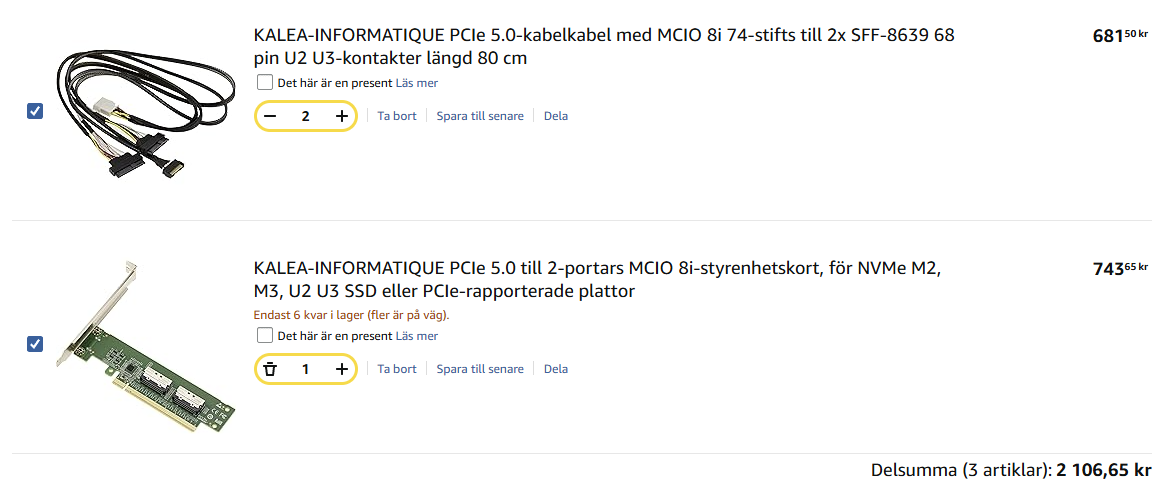

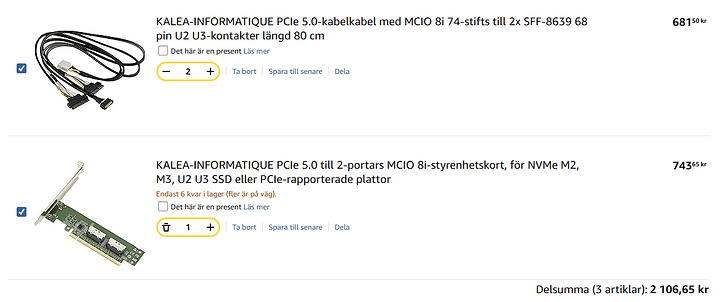

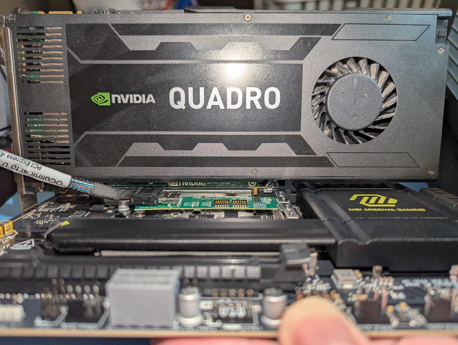

I ran a disk benchmark using that Kalea-Informatique 2x MCIO adapter (and a Supermicro cable) at Gen3 speeds and that went fine: A Neverending Story: PCIe 3.0/4.0/5.0 Bifurcation, Adapters, Switches, HBAs, Cables, NVMe Backplanes, Risers & Extensions - The Good, the Bad & the Ugly - #739 by homeserver78

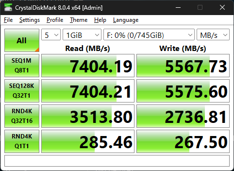

For what it is worth, I just ran a standard (non NVME, non crazy custom test like I did before).
After having the drive powered on in my system but not used for a good long while, the initial standard test results seem to be back where they were at over 7400MB/s
So it seems letting the firmware do its thing in the background regained the lost performance from repeatedly running performance tests.
I left the drive powered on but unused for a good long time. No idea how much of that time was actually necessary. Probably only a very small amount of it. I just didn’t get back around to testing it again as quickly as I thought I would.
