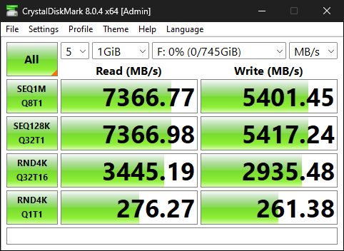

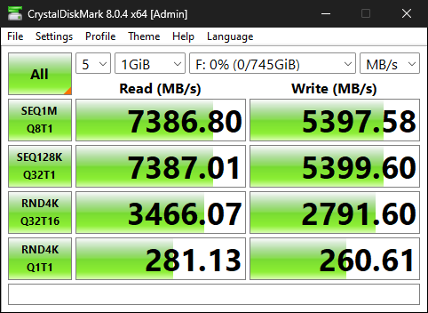

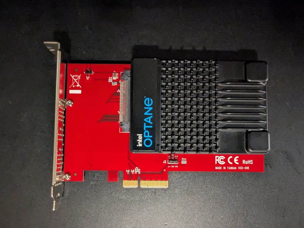

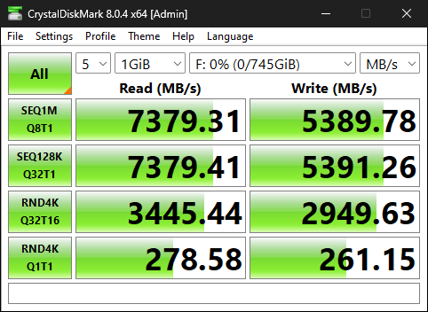

First I decided to do a “before” benchmark, using my passive (I think?) Startech PCIe adapter I’ve been using until now. Slot is made up of CPU lanes, on a Threadripper 3960x:
I decided to do a few tests in a row, to minimize the risk of a spurious result:
These are all standard “Nvme” tests in the settings menu.
PCIe Adapter NVME Test 01
PCIe Adapter NVME Test 02
PCIe Adapter NVME Test 03

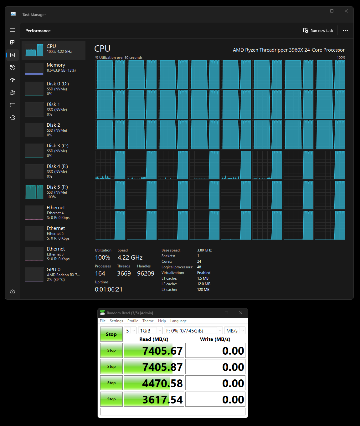

Then I realized, wow, these tests are really CPU intensive. The Seq1M Q8T1 loads up one core of my Threadripper to just above 50%. The Seq128K Q32T1 loads it up to something like 85%.
The RND4k results are where it really gets crazy. The NVME test uses 16 threads by default, and on my Threadripper all 16 of those are pinned. The Q1T1 - of course - uses only one thread, and that one is also obviously pinned.

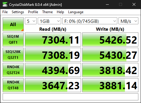

My bright idea was that I should alter these that seem to be CPU limited so that when I do my “after” test, my CPU limitation on this machine is not masking any potential issues.

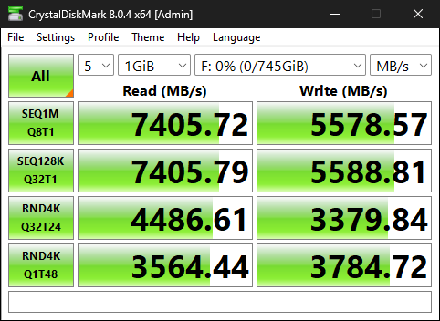

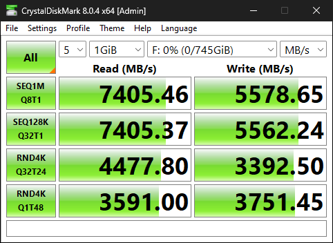

So I upped the RND4k Q32T16 to Q32T24 (one thread per core. If I went above that and started using SMT, it appeared to perform worse)
I also upped the Q1T1, this time to 48T, as it didn’t seem to mind the logical SMT cores and performed better with them:
PCIe Adapter Custom Test 01
PCIe Adapter Custom Test 02
PCIe Adapter Custom Test 03
So far so good. To illustrate how these things can really load up the CPU, I took this screen shot:
I ran a few more experimental benchmarks after taking this screenshot, and I noticed something odd. The drive seemed to be getting a little bit slower with each run. I did notice that Windows Update was trying to install something, and while the OS is on a completely different drive, I thought maybe it is consuming CPU and slowing things down.

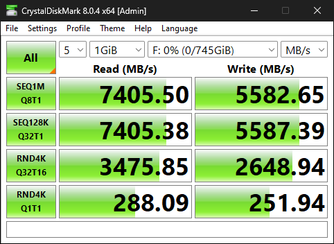

First I did three of the NVME tests:
Redriver NVME Test 01
My thoughts: Hmm. It’s a little slower than the PCIe card, but it’s only very slightly so. Maybe the cable length is at play here. (mine is the silly needlessly long one) More tests.
Redriver NVME Test 02
Wait a minute, it’s still getting a little slower.
Redriver NVME Test 03
And slower…
Uh, oh. Do we have a problem?

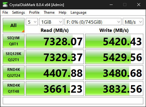

On to the custom tests.
Redriver Custom Test 01
Redriver Custom Test 02
Redriver Custom Test 03
Alright, so it keeps getting slower with every test. Something is very odd here, and I don’t think it is the redriver. I think it might be the drive itself.
