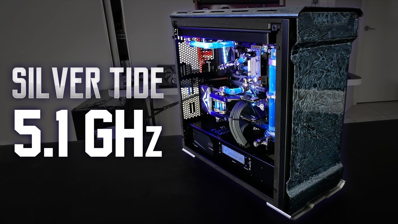

It can be done. jayz2cents has issues with his… but…

Yeah im waiting on the part when he shows the actual mods to the top, i assume he made laser cuts on the TOP cover.

I have not watched it yet but unless he specifically stated he did modify the top I can 100% guarantee he has not modded the case. He just does not get into that stuff on any build that is not completely necessary, and with a well set up loop it is not necessary.
Thought is was a Jayz2cents video.
Na its from Singularity Computers
When he talks about the clocks he said something about a mod on the Top, but in that part and the stability checking atleast on camera, the Front/Top were off the case.
I just got to that part. I interested to see what he had to do. It really should not be necessary at all.
Edit: but he is putting 2 1080tis in as well so more heat, also water cooled ram for what ever reason.
