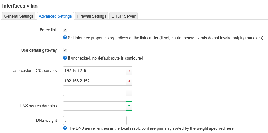

Many software have the ability to define dns servers per interface and dhcp will advertise these addresses on that interface.
In openwrt it looks for example like this…

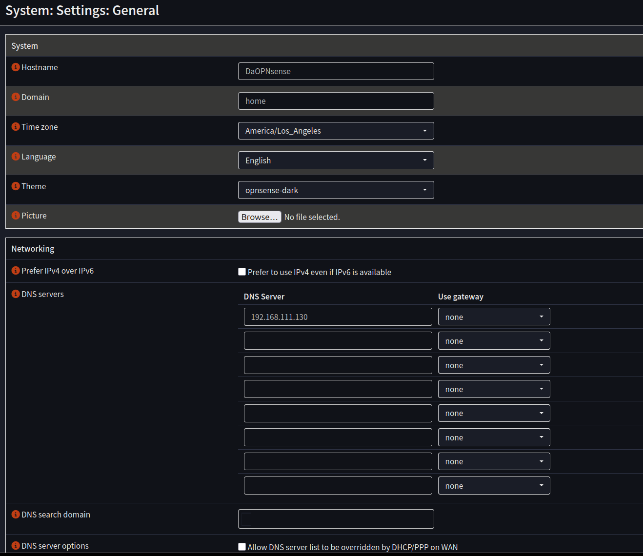

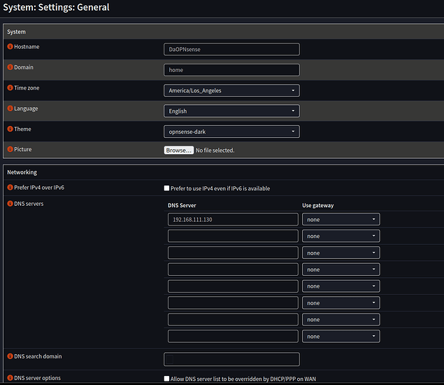

Turns out setting a DNS server in the general settings of OPNsense does vend it via DHCP. But I’ve seen really inconsistent behavior across different clients.
FYI my pihole is 192.168.111.130.

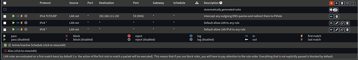

Set DHCP specified DNS IP

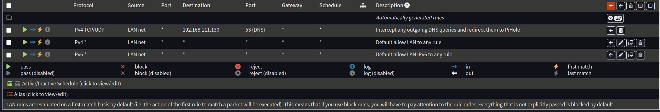

Firewall rules. Top one is generated from Port forwarding NAT. Needed to move it to the top.

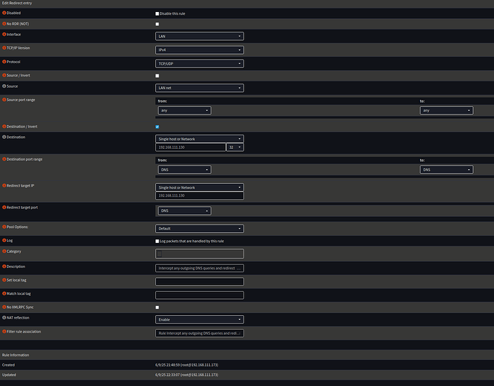

Forward ports rule.

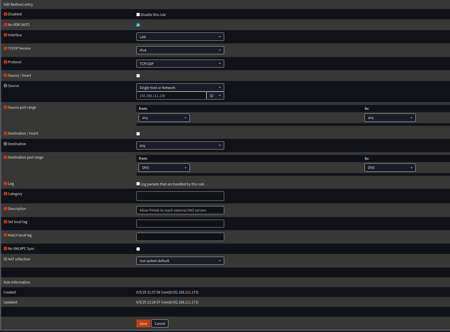

Allow pihole to do DNS querying.

Your Firewall rule says “intercepts any outgoing” but it is only an allow rule.
This is a firewall rule and not a port forward rule! Also you don’t need NAT, how are you mixing NAT into this?

Step 1: Create a rule to reject (use reject and not block internally, that way the clients get informed immediately and don’t wait) all DNS traffic. Put that rule on the top.
Step 2: Then create a second rule that allows pihole to do DNS to our OPNsense (unbound) or whatever.
Step 3: Put that rule above the block rule.

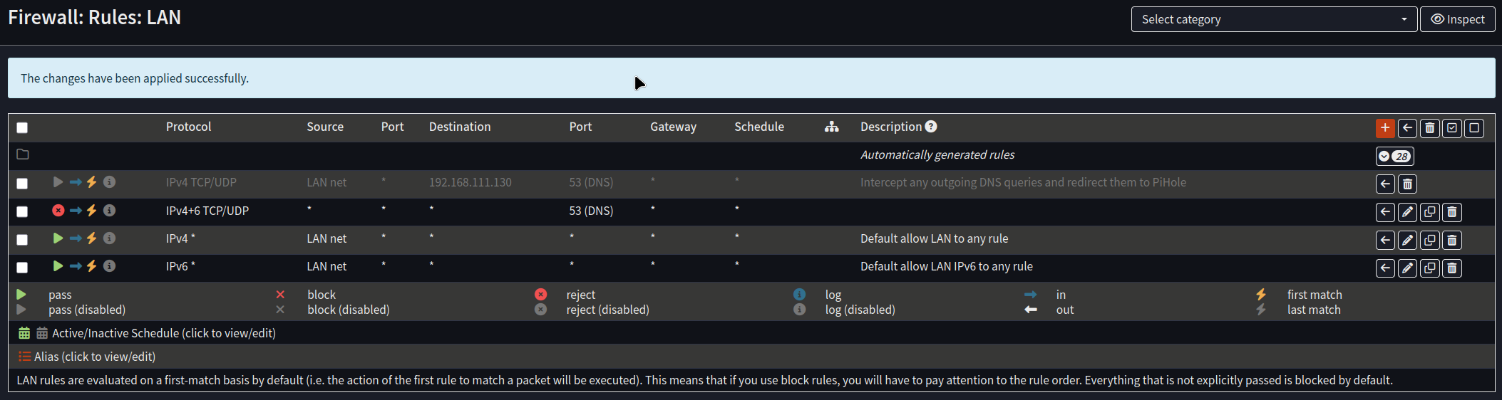

Here’s what I got
No need for rule from pihole to unbound since I have unbound running on non-53 port.
