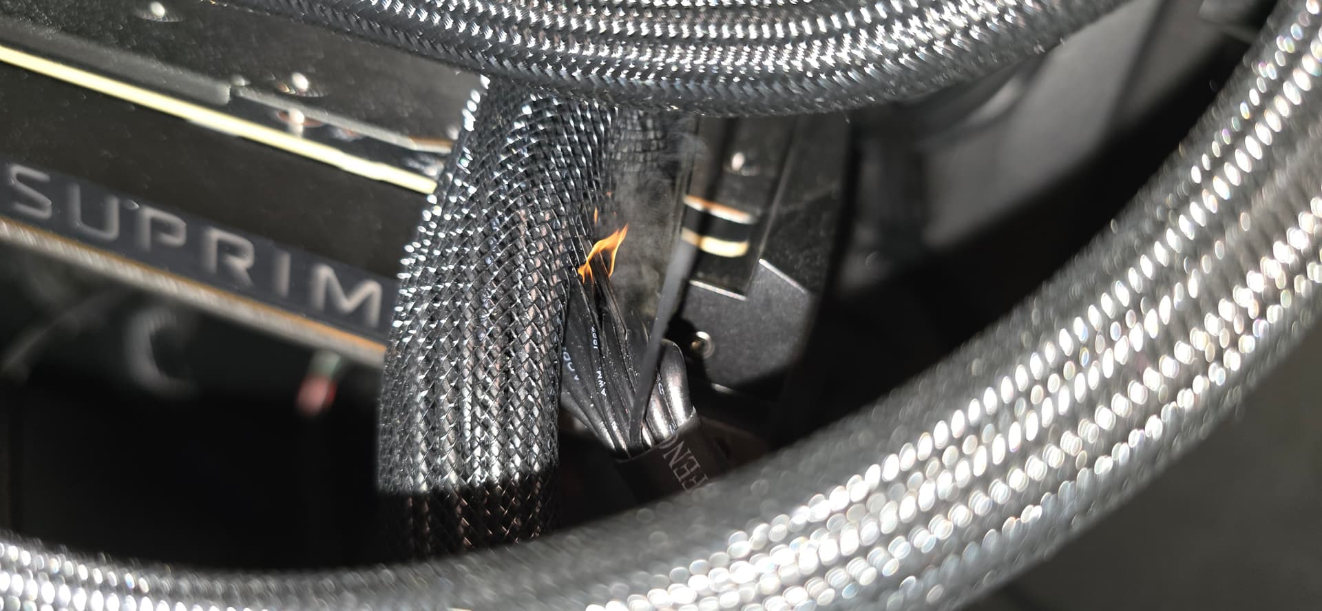

Hi,
So, I noticed this - looks like one “hair” felt out of the power cable(s) powering my 4090. Should I be concerned? Should I rise a warranty inquiry with seller of the PSU (basic bequiet 1200w)?
Cheers:)
that does not look great lmao :sweat_smile:
I’m assuming its not a modular PSU, so just swapping this cable is not an option?
From the wire thickness its probably not carrying a lot of current, but its there for a reason lol.
Considering all the stories about gpu power connectors melting I’d RMA it if you’re still in warranty. Something like this should certainly be covered.
It’s a sense wire from the 12vhpwr connector
If you haven’t noticed that the 4090 is running at ~80% power usage, it won’t make a difference.
You should still contact be-quiet and ask for a replacement.
So there us a sensing wire, you can short it/close it and you’ll get 100% power

dude, replace the cable, amazon has so many to pick from now and you’ll have probably it by tomorrow :wink:

I know that 4090 keep melting at the connector, and I know I should do an RMA - just wondered, what da hell is that and why it happens :slight_smile:
Will reach out to the shop and ask them if they can provide another cable, thanks :slight_smile:
Oh, and it is modular, luckily :slight_smile:

Yes. 12VHPWR / 12V-2x12’s rated at 660 W absolute max and 4090s commonly pull 525ish at stock. So even the standard 20% derating for aging potentially puts the card into negative safety margin with a perfect cable assembly and perfect ground flow balance. The sense wires don’t matter to this but, if they’re coming loose, that indicates for heightened risk of hidden defects in the power connections.
If Nvidia was held to the same standard as PCIe 8-pin, EPS, and IEC the max GPU that’d be supported from a single 12+4 connector would be a 4070 Super to maybe 4080 Super, depending on exact choice of safety factor and how much the manufacturer pushes over TDP.
Having seen a few people mention on social media that this brands High Wattage (1000W+) PSU’s are crap after they had two identical PSU’s fail during normal usage I would recommend personally that you return the entire PSU to wherever you purchased it from and get one from another vendor that offers better quality control and has a reputation to uphold that if damaged would seriously effect their sales.

You could of course try other brands, but having seen numerous complaints about the declining quality of Corsairs more recent High Wattage PSU’s I would be more cautious buying from them.
You could give Enermax a try, they have skin in the game for a long period of time and a reputation to uphold in regards to their ATX PSU’s, but I haven’t seen much feedback about their recent offerings so you’ll want to research that yourself.
Either way, ACT IMMEDIATELY!
Do not wait to get this resolved, and personally if I owned this setup I wouldn’t risk using the PC because of the higher chance that anotger cable may come loose.
Personally I would also just send the PSU back to where I got it from for a full refund because it is faulty and I don’t trust that brand of PSU’s & I would instead invest in something better from another more trustworthy brand.
BeQuiet’s other products don’t seem to be plauged with issues like their High Wattage PSU’s are, so whoever they’ve got to manufacturer them, and whatever budget they are built to it is clearly too cheap.
Hopefully after enough complaints and people returning them for full refunds BeQuiet’s lack of store stock refills will make them realise they’ve fudged up.
Good luck getting this resolved.
Whatever you end up doing, do it now, do NOT wait.
First of all, thank you for such an extensive reply, much appreciated!
Second: the shop told me that the Vendor told me that they dont care and wont fix it! Furthermore, Vendor didn’t even tell me which cable to get to replace it.
The shop tries to help me out though, but they want the whole PSU back. I was quite reluctant, but you are correct - why should I wonder if another thing fails in this PSU? I have some hard to track instabilities in the PC, now I start to think it’s a fault of the PSU. TBH I assumed that if I take 1,2 KW powerplant, I wont have to worry about power delivery - but it looks like I was wrong :slight_smile:
I’ll order a new one, switch one unit to another, and next let the shop handled it. Little downtime, less headache.
My shop has good reputation, also I buy most of my electronics there, so one can hope for good results.
I wish you all the best in getting a satisfactory result.
It sounds like the shop that you have purchased your parts from is trying it’s very best to provide you with an adequate solution to resolve the matter.
Whatever you end up with do not put another PSU that is the small model as the model that has failed, because as I indicated previously it is likely you’ll have similar problems again.
And now that you have indicated you were having other power related issues that does suggest that perhaps not all is right with your PSU in other regards.
One thing I forgot to.mention in my original reply is that those new 16-Pin Power Cables need to have sufficient space around them before bending the cable on itself to hide it at the back of your computer behind the motherboard tray.
When installing that cable the first inch of the cable itself past the back of the connector should be absolutely straight with no bend in it, this is actually mentioned in the newer standards for that connector type, because it is seen as reducing the risk of a fire occuring.
So when you get a new PSU I highly recommend that you read up the latest guidance on the HPWR12V / 12V-2x12 Connector. It may stop you from having this pin slip-out problem again, and at the very least it massively reduces the risk of accidental fire occuring.

What do you mean by “small model”? It’s a regular size, I would say.
pretty sure their comment about “small psu” was referring to the 1200w rateing. 1200w doesn’t seem small until you take into account things like transients and surges and all the other fun things nvidia’s last gen was known for.
