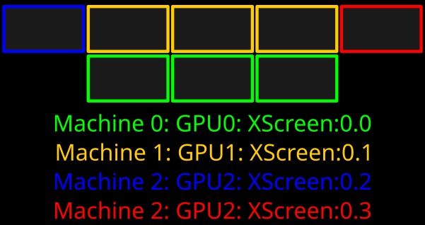

Correct me if I’m wrong, I’ve been reading and watching videos and frankly the info on each KVM is very disjointed. So am I to take it Mouse roaming on the KM can’t be used on Multi Monitor machine much less on Linux. To see Win/Mac the only two supported platforms…
If I’m wrong and you can use on Multi-Monitor Linux systems can you use more than one USB connection to the same machine for separation? I have 3 machines but in their current setup that equates to 4 XScreens. Machine 3 XScreen 0.0 is to the left of machine 2 XScreen 0.0 while Machine 3 XScreen 0.1 is to the right of Machine 2 0.0. Which is to say I’d want the mouse to naturally pass from Machine 3 to machine 2 to machine 3 if moving left to right or vice versa.
XScreens-triple-machine

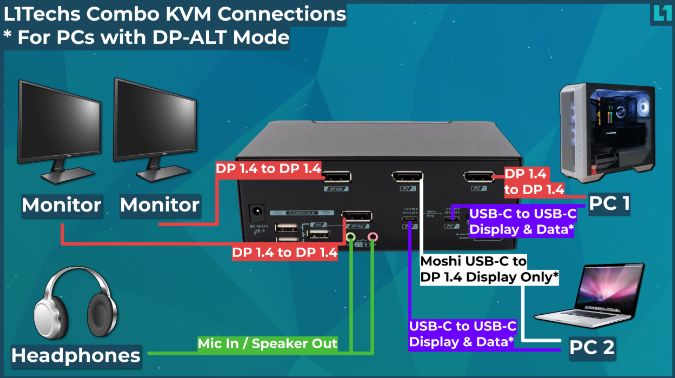

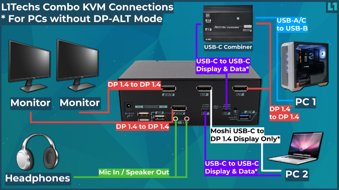

That’s probably your problem then. I’ll post the diagrams from the store page:
dp alt no
dp alt yes
I’ve seen the diagram but still have questions. In 1st setup (no DP-Alt)
OK so we need 2x outputs from PC Desktop GPU:
  • one DP cable to go from GPU DP out port directly to KVM PC 1 DP In port
  • one DP cable and one USB-C cable to go to USB-C combiner and this goes to KVM PC 1 USB-c In
On second setup (with DP-Alt)
  • one USB-C cable from Motherboard USB-C to KVM PC 1 USB-C in
Is that correct ?
Motherboard or GPU, some GPUs have a USBC out like the reference 7900 XT / XTX.
But otherwise, yes.
