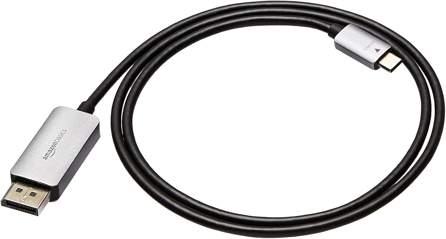

I ordered this monitor recently and will have pretty much the same setup. Did the new cable work and are you able to get 240hz (with or without the combiner) ?
