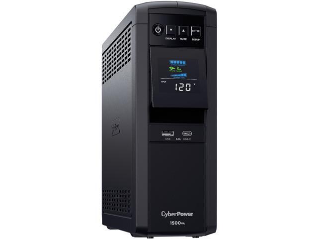

Figure I will use this I bought it for $125 on sale..
I get micro outages here anywhere from a few seconds to 20 minutes at worst a few hours..Was tired of the BS outages so this fixed that problem..
