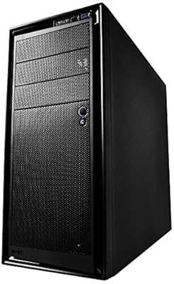

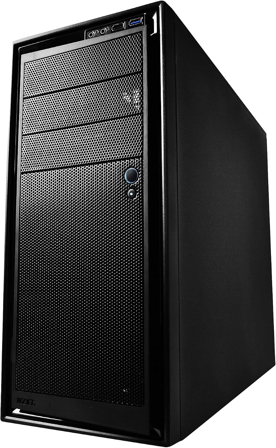

You should have bought this case instead. Some actual venting to allow cool air in.

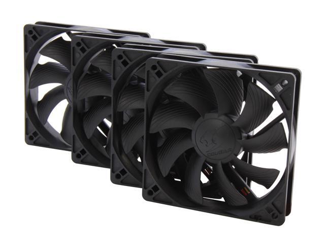

140's tend to be pricey ?
http://www.newegg.com/Product/Product.aspx?Item=N82E16835553009
I use these as stock fans for all my builds. Sometimes find deals in the low 23 24 25 worth it.
