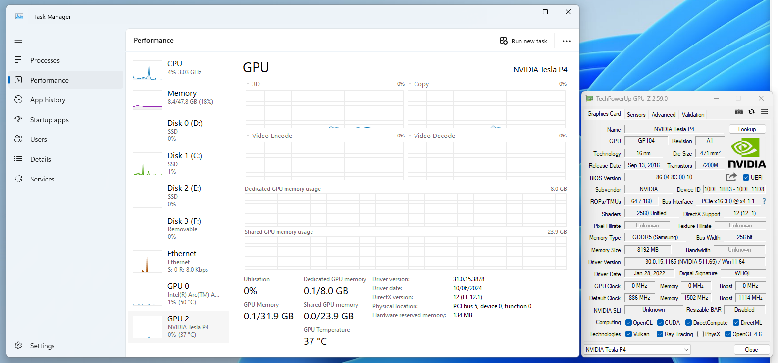

I am trying to install an Nvidia P4 in my computer for a low powered datacenter graphics card (for AI). The installation process is fine. However, after when looking in device manager I get the “This device cannot start. (Code 10) - Insufficient system resources exist to complete the API”

I used to run a Tesla P4 in one of my lab machines. Had it working both on Windows and Linux. For Windows, you need to use a fairly old NVidia set of drivers, I think 419.67 international desktop was the version that worked. I believe I also tried 472.39 Grid which worked, but not for games.

I was using Windows 11. I had a OLD NVS card for display and used the P4 for rendering or other jobs. Set that through the GPU properties on the app. Usually the error yiu are getting is due to the wrong driver being installed. Nvidias latest did not work on it if i recall.

I had to get the grid drivers off gcp. Trial an error got me to version 538.78

Rebar is still saying it is disabled in gpuz but I am glad it is atleast working.
