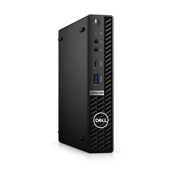

I ended up buying
Edit: I’m hoping I can get a 2.5G nic to put in that modular port on the back. If not, it’s not a huge deal - I’m using a USB A to 2.5G adapter currently. Plus I think I can swap my NUC’s current memory, NvME drive, and 2.5" SATA drive over to this machine as well.
So it arrived today, and I just wanted to share my preliminary thoughts and impressions.
First, I was surprised to see that Dell had included their usual cheap keyboard and mouse in the box given this thing’s nature as “refurbished”. But, I have seen worse included peripherals from Dell equipment at work.
I figured out how to open it up. I was on my lunch break so I didn’t have time to look it up. Immediately, I was met with a rather nice 2.5" drive tray. Yay. I took it out and set it aside.
I was disappointed to see a 2230 NVMe because I wanted to replace it with my old NUC’s 2280. Immediately, I found a little fuzzball inside. Nice refurbishment job, Dell.
It took me a little while to find the SODIMM slots, but eventually I spied them under the blower style CPU cooler. Initially, I started taking off what I would later discover was the heatsink before I noticed some little clips for the fan. This thing is really nice to work in given its tiny footprint.
I took out the single 8Gb Kingston stick, got my old NUC, took it apart, and pulled out its 32Gb kit, and put that in the Dell.
I decided to finish what I’d previously started on the heatsink, and take it fully apart on a hunch that Dell forgot to refurbish the thermal interface material.
I was right. It was solid rubber. Also, I was surprised to see a socketed chip rather than a BGA chip. I honestly do not know what CPU socket this is. It’s better than LGA 1700, honestly. After cleaning everything up, I reapplied some fresh thermal paste, and reinstalled the CPU heatsink.
One last thing before I cinched it all up, I wanted to see if I could use the WWLAN slot as a secondary storage slot, so I took out the WD NVMe, and that’s when I noticed that there was room for 2280. Yay!

What could be causing this thing to only read each SODIMM as being 1/2 the size of what they are in reality? I looked up the specifications on Dell’s website and this thing looks like it supports up to 64Gb of memory.
