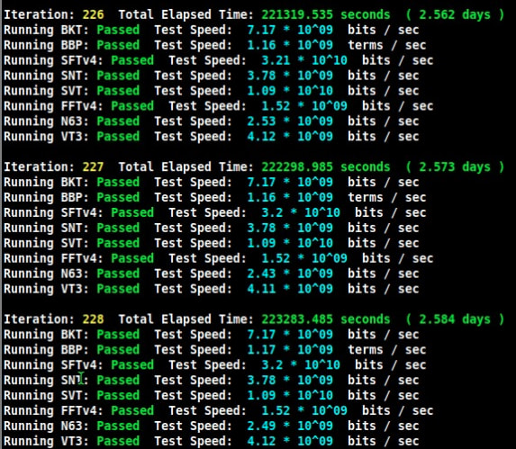

Just to close-loop on this, after many weeks/months, the issue appears to have been “Seating” of the memory sticks in the actual machine.. Nothing has changed in BIOS/OS/tests, kept trying testing one, and after validating memtest86 for 4+ cycles, added the second, and in some cases it was failing, other times it held just fine, even days of y-cruncher!
I guess i never realized just how “fragile” this is.. the fact it shows “96gb” or whatever number, doesn’t mean a lot.. if contacts are not good for high-load, such failures can take your time :slight_smile:
here is a screenshot from same exact machine with 96GB running y-cruncher for days!!
After it worked, cleaned all contacts with electrical cleaner and it appears to hold fine, but not taking these for a while now :slight_smile: after replacement , suggest to run memtest or y-cruncher to validate and avoid stray/sporadic errors which can corrupt rom builds, or AI workload.
