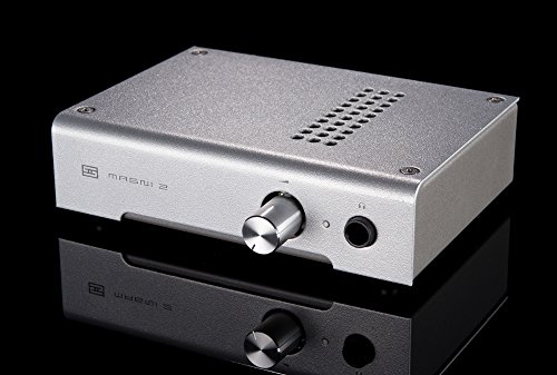

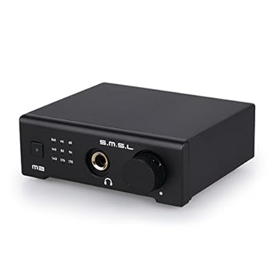

If all you are looking fore is to push the headphone volume then what you want is a headphone amplifier. These may fit the bill the only draw back being you wont be able to plug a microphone in.
