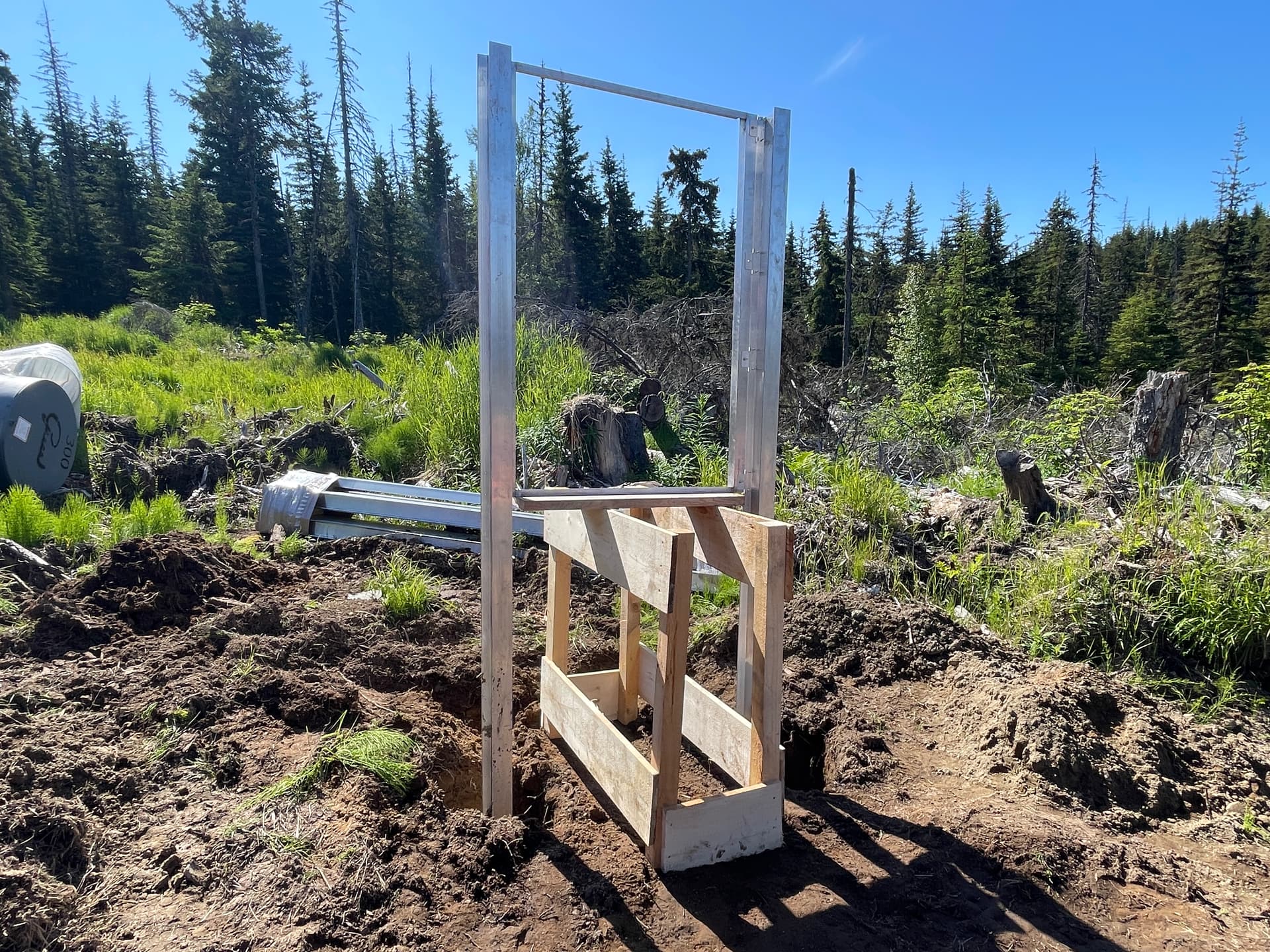

Got tons of those same brackets we’re screwing onto our aluminum beams. Just picked up rebar rings for the concrete and some panel placeholders we had fabricated to connect the beams and ensure distances are correct while they cure in the concrete.
40 aluminum I-breams, 30 beams each with 8 z brackets and 10 beams with just 4 brackets. 40 holes to dig in the ground and each to be filled with 16 bags of concrete. Then we have to install the 35 panels and start the trenching.

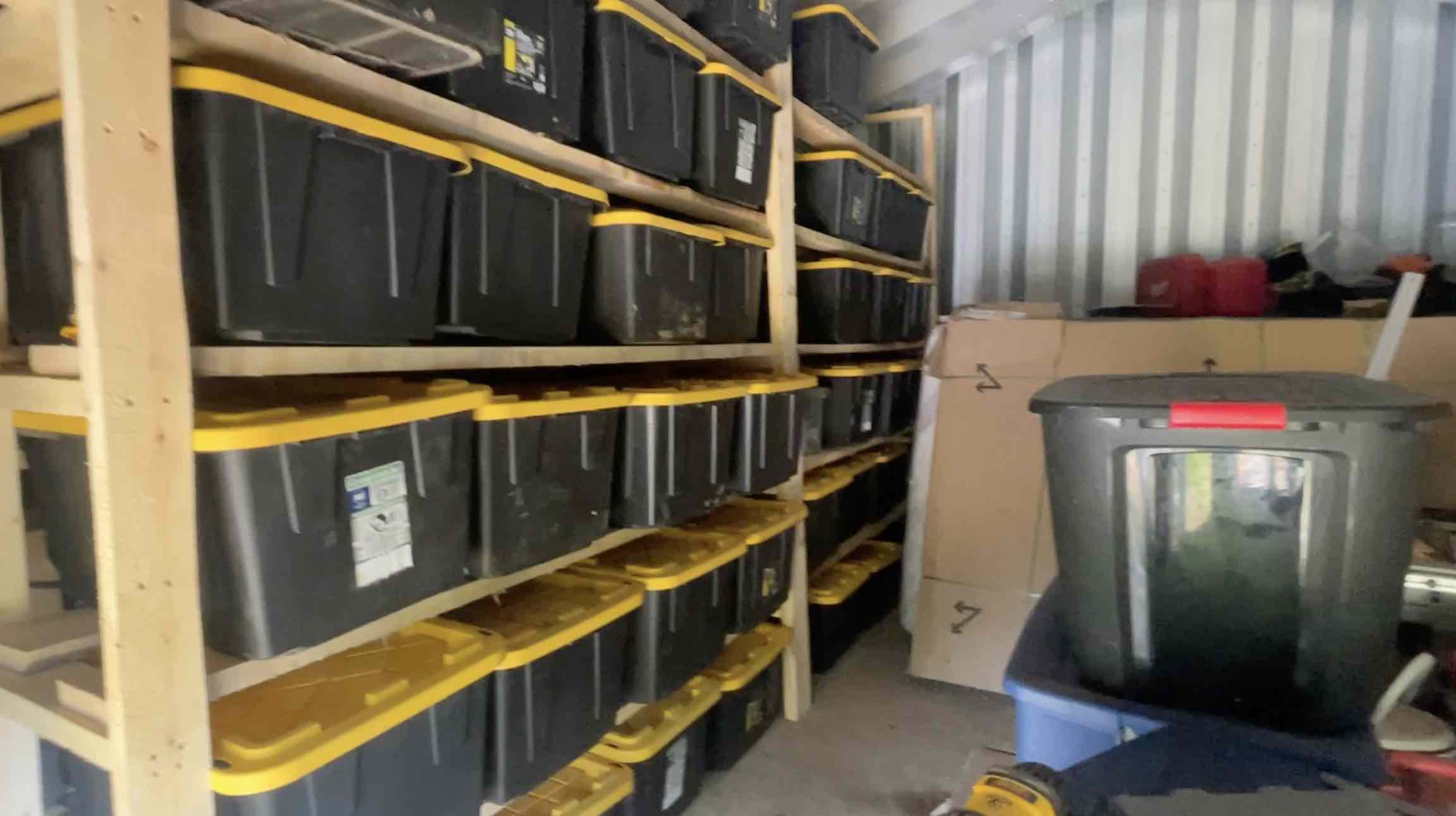

Just for reference on the space freeze dried food takes, this shelf full of these bins (so in this picture imagine the three or four empty spots are filled with bins for a total of 48 bins) – this is literally over a TON of food (which many people can fit in a garage).
These bins hold:
500 eggs
239 pounds of cheddar cheese
132 pounds of mozzarella
219 pounds of bell peppers
919 cups of tomatoes
95 pounds of onions
105 pounds of zucchini
209 pounds of green beans
246 pounds of broccoli
231 pounds of corn
3080 ounces of Rotel
102 pounds of cream cheese
358 cups of spaghetti sauce
303 cans (10.5 ounce) of various soups
24 avocados
35 pounds of ham
124 pounds of thin cut pork chops
24 pounds of rotisserie chicken and roast turkey
10 pounds of potatoes
236 pounds of peas
33 bananas
71 pounds of okra
36 x “ready made” meals (4 taco bake, 2 chicken pasta, 16 gumbo and 14 tuna noodle)
By taking the water out you can store an enormous amount of food efficiently. This is more than a ton of food but it doesn’t weigh a ton without the water.

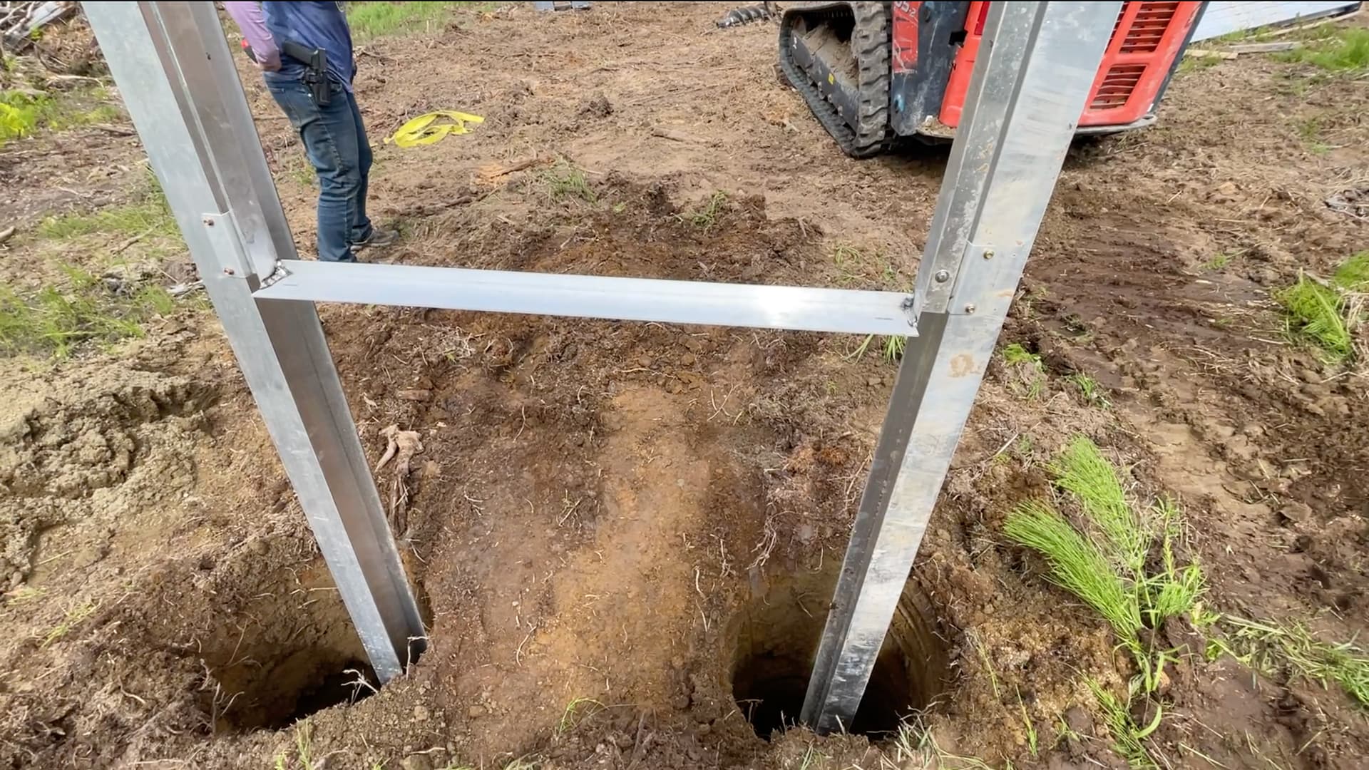

We had five placeholders welded (I still need to learn to weld so that I can do this kind of thing myself in the future) that ensure our I-beams are spaced properly for the solar panels. Got the first set of beams in a couple test holes (four foot deep, 18" diameter). Now we’ll build a box that will fit between the two holes for the placeholder to sit on to help us ensure beams are plumb and such. Then we’ll pour concrete and replace the placeholder with a solar panel. And then do that 48 more times. Then the trenching begins. Fixed vertical and optimized for winter production.

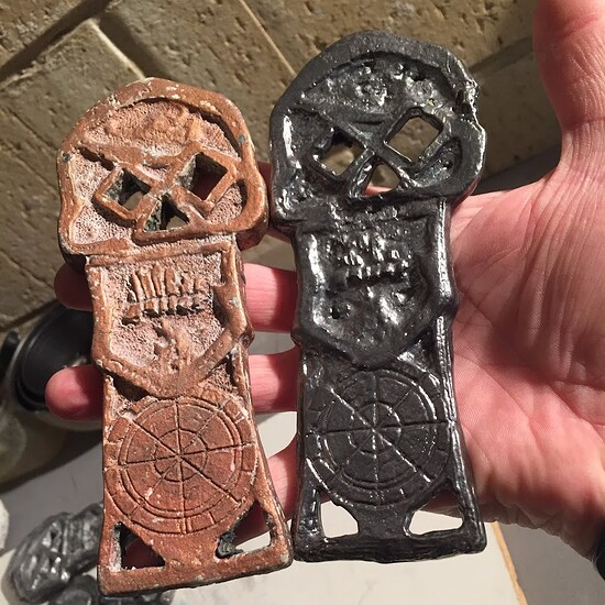

Might be an interesting youtuber for your interest.
also dumpster diving for metals to melt.
I’ve seen a few of his videos, will definitely check out more. Would be a fun hobby. I think I need to learn how to cast metal next so I can make something useful out of it.

Keeps the I-beams suspended 6" from the bottom of the holes and allows us to ensure it’s plumb and level while curing in concrete. These are just test holes, but soon after I do a bit of dirt work, we’ll be putting in 35 more such panels all fixed vertical for winter.

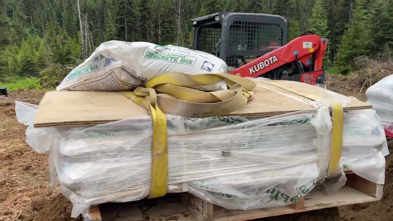

Almost ready for the real work. Just have to make three more sand tables to hold a total of six pallets of concrete, so that we can mix that concrete (26 x 60# bags per pallets for a total of 156 bags) to fill the first batch of holes. Then we can wash out the mixer, switch to forks, and load up six more pallets before going onto the next batch of holes (40 holes to be filled with concrete total). Elevating the pallets should make it easier to dump each bag into the mixer and save some back pain.

On your solar panel upright assembly photo it looks like you are using sink plated screws. That will probably become one of the weak points of the assembly. I would recommend using stainless steel pop rivets instead. While there are hand tools for pop rivet fastener, you can also get battery powered, or air powered. I know harbor freight has an air tool.
Aluminum is close to wood in its pull out strength, and pop rivets have a flange which greatly increases the strength.
The only screws on the assembly are a) the self tapping screws that came with the Renogy Z-brackets to hold the brackets into the beams and b) the screws that hold the placeholders (and later the panels) into the Renogy Z-brackets.
Which screws are you referring to? I am wondering about the first screws, the self tapping screws, that mount the brackets into the beams. They are snug when drilling them into the beam but there isn’t much for them to hold onto since the beam flange is fairly thin and they don’t come with nuts so we’re probably going to get some nuts to put on there.
We’re planning on using M8 and M6 screws with washers and lock nuts to hold the panels into the Renogy Z-brackets.

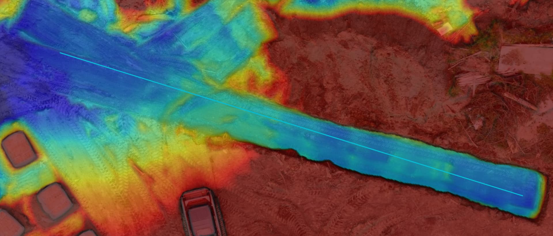

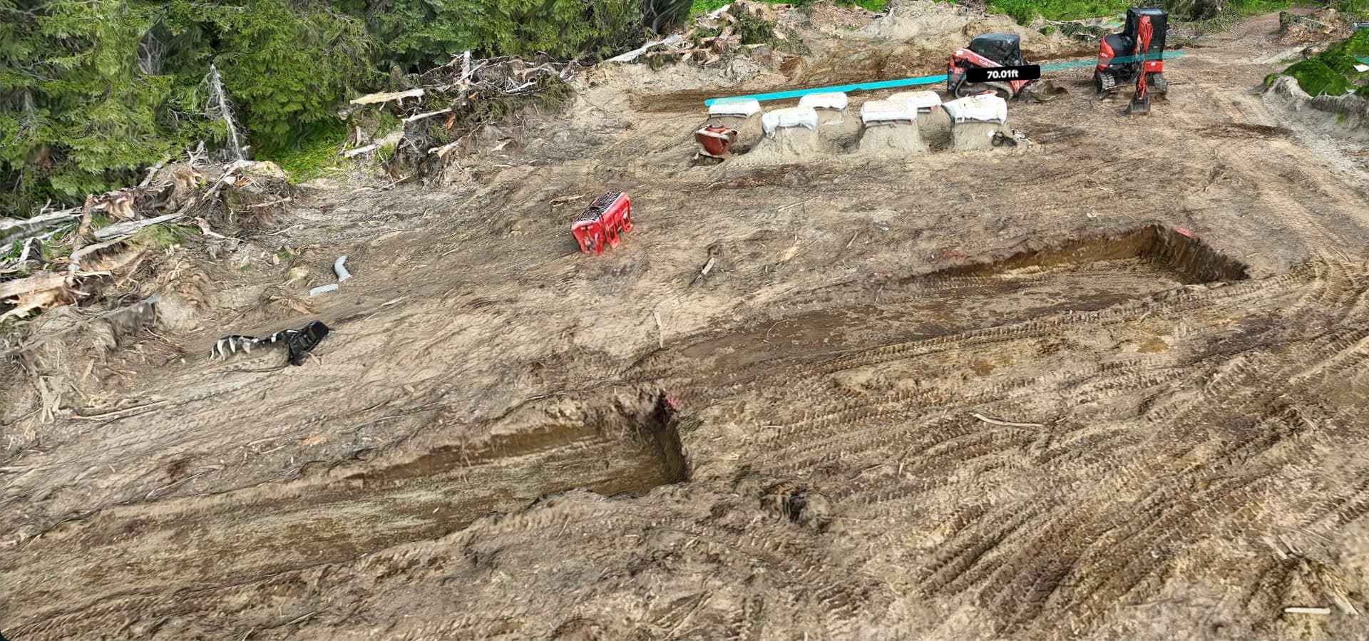

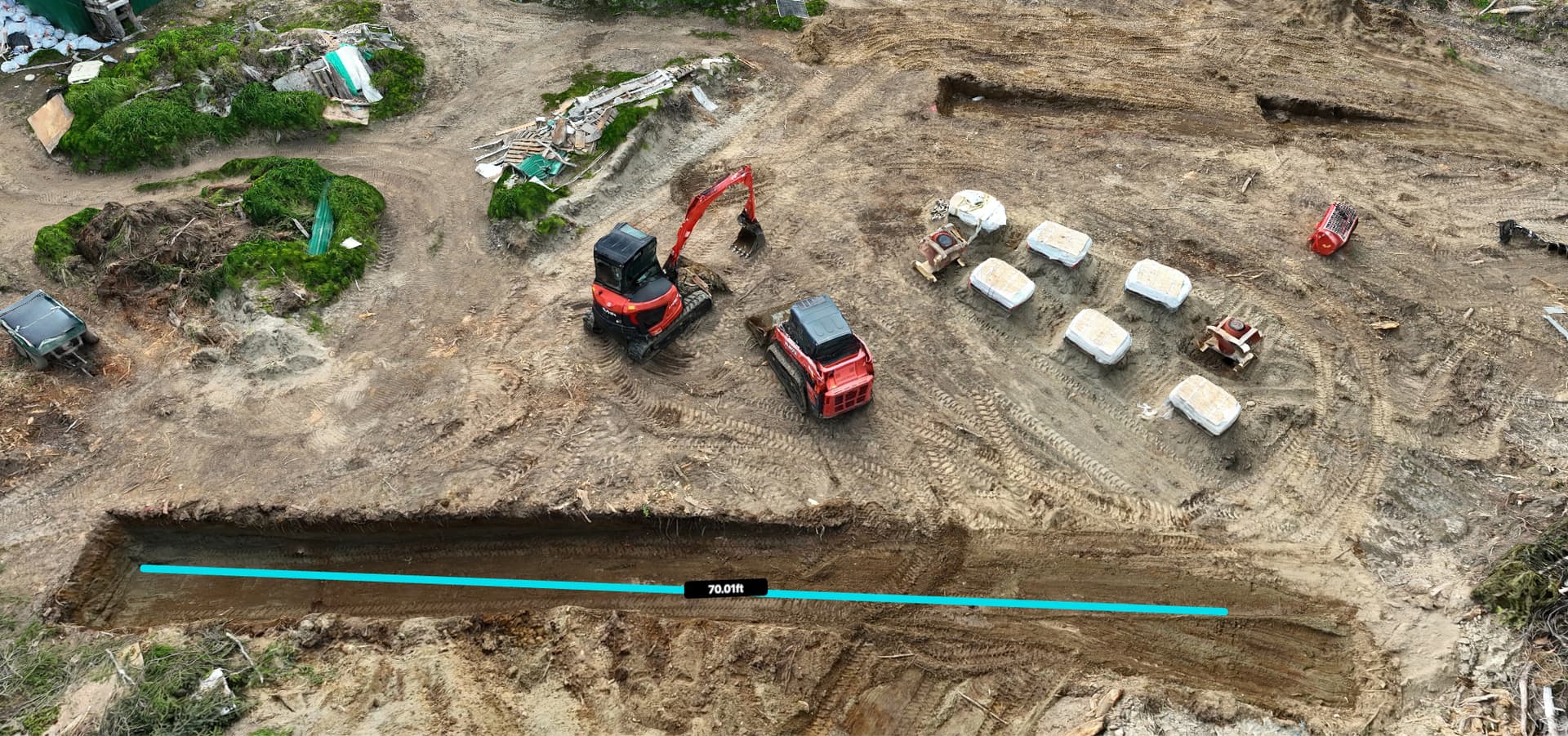

Used the laser level for the first time and did the dirt work for the five new arrays. Dug two small trenches for two arrays, and one nearly 80 foot trench for three other arrays. Sloped property but the trenches are level within about 6 inches. Next we’ll put up a string line and auger the holes, brace up the beams, and pour the concrete. Once the arrays are in we’ll then grade the dirt a bit to use the slope to our advantage to keep snow from blocking the panels.
The larger three array trench is pretty level but could use a little bit more leveling.
Next summer we’ll terrace the space between the arrays and add a bunch of garden grow beds.
These five new arrays will take our solar production up to 30KW. So on a nice April day with snow on the ground, we could produce the average American household usage over 24 hours…in a single hour.
