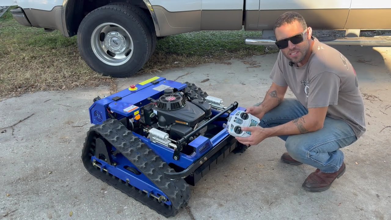

Look up a remote control lawn mower on alibaba. They are tracked vehicles about 3 feet square and designed to traverse a 60% slope. You could probably order one without the lawnmower in it for cheaper. The tracked portion is electric with a gas engine for the mower.
They are about $600 before tariffs and shipping.

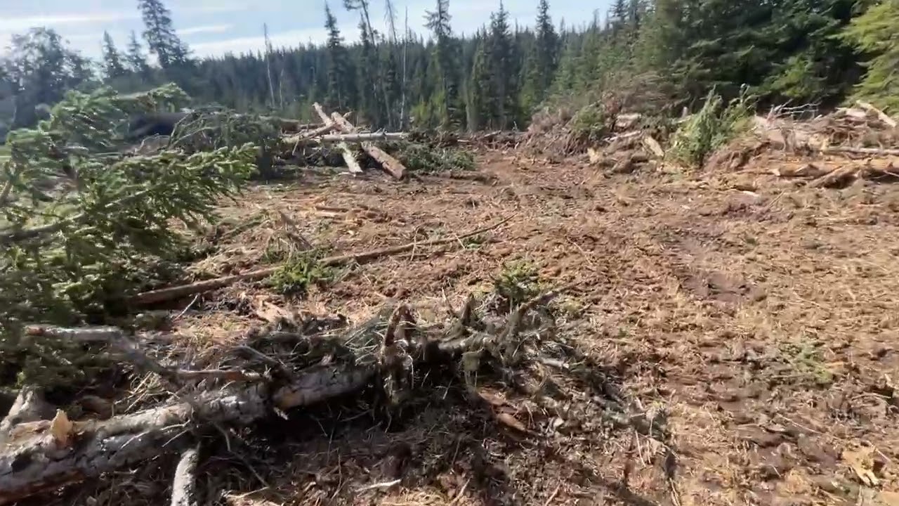

And I cleared out more area for the five new solar arrays we’re installing this summer, since we’ll need all that power to produce the fire in the cables to the 5090 GPUs we’ll hopefully be buying soon…

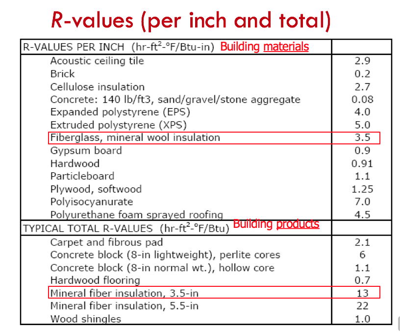

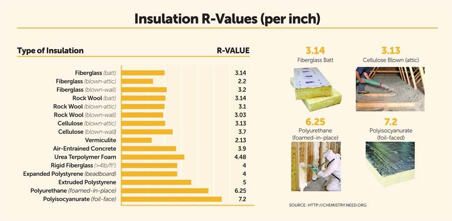

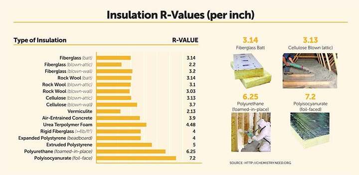

three inches of foam board for insulation is interesting to me, what is the r-value of the foam at that thickness? does it perform better than rockwool or similar?

But those R-values will trick you a bit. Polyiso performs worse at low temperatures…
It’s R-6 per inch during the summer, but only R-4.5 per inch on a cold day in winter. The insulating performance of polyisocyanurate insulation is significantly degraded at cold temperatures.
Cold-Weather Performance of Polyisocyanurate - GreenBuildingAdvisor
