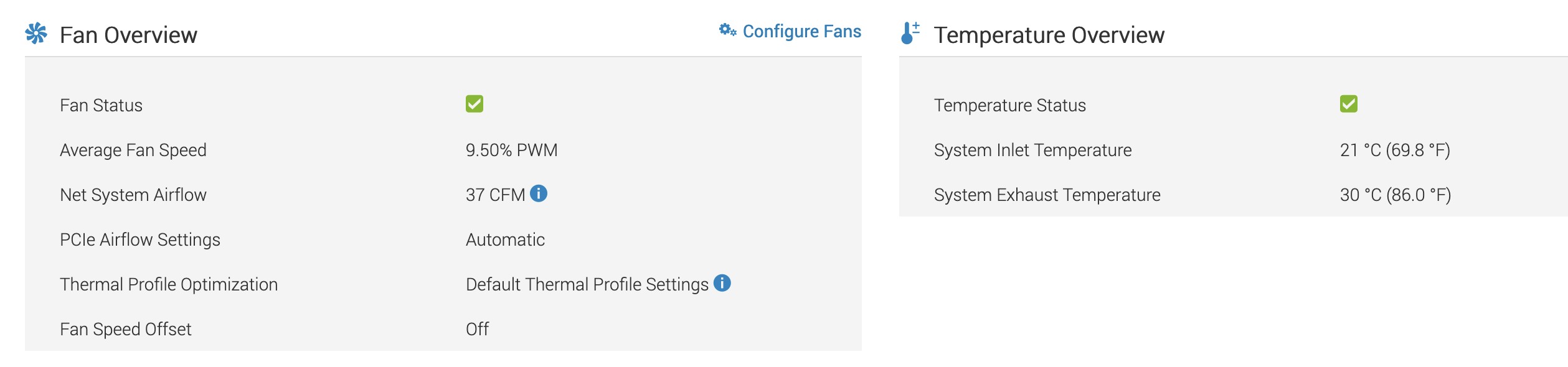

I did some testing against R740xd and R440 in terms of noise (because believe it or not those two monsters are in my bedroom) and turns out the iDRAC firmware version makes a large difference
On version 3.36.36.36 the fans would always hover at around 12% with approx 200w power usage
On versions 4.00.00.00 and higher the fans would always hover at around 30%
This is 3.36.36.36 on R740xd with default thermal profile (aka no minimal fan speed set)

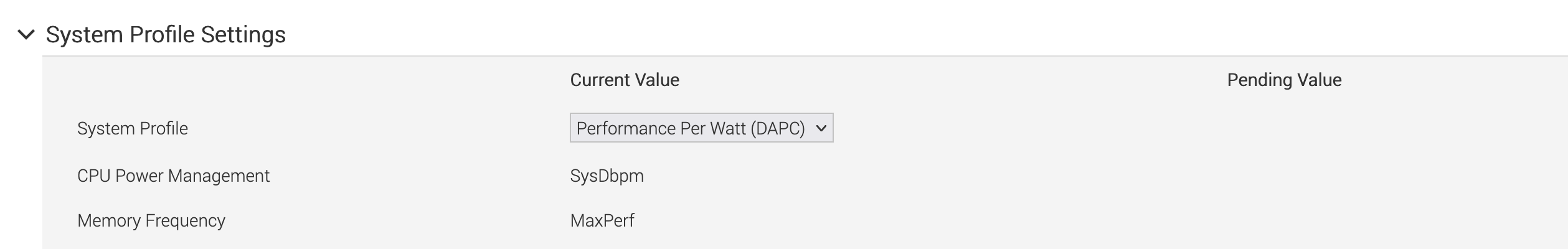

You want to set your performance profile to Performance Per Watt
Configuration > BIOS Settings
On some OSes the non-DAPC setting does weird things so I like to have it sitting at DAPC

I have set the System Profile to Performance Per Watt (DAPC)
