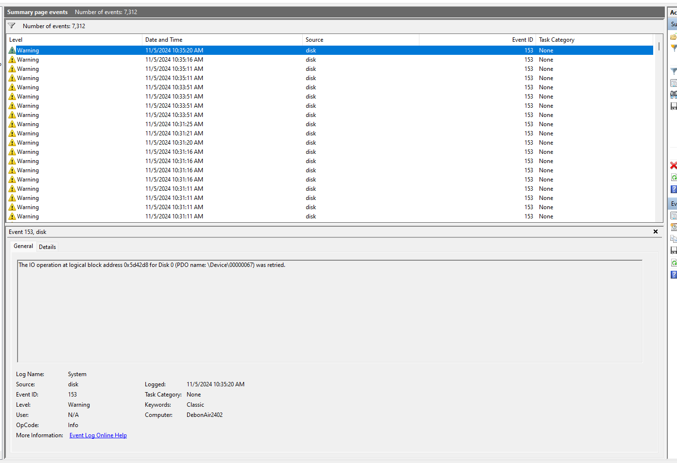

Hi All. I was wondering if someone might have some suggestions on dealing with some odd disk entries in the event viewer in windows.
We bought a new supermicro threadripper rackmount workstation and we’re going to use it as a server for our db. It is running Windows 11 since that is the only offering for threadripper and we don’t have anything in it other than the m.2s and one u.2 nvme drive in the front.
The drive is a single Intel P5800x and we were planning on putting the db on it for its high IO and performance.
The issue we’re having is that we’re getting event id 153 disk in event viewer a few times every couple of minutes. We have a small powershell script just writing 2k random once every few seconds. Sometimes the event continues to happen for as long as the script runs (overnight sometimes) and sometimes it doesn’t show up at all.
We tried moving the drive to a different bay and that didn’t fix the issue.
153 is a warning that says that the IO operation was retried.
Does anyone have any suggestions on the error and what might be causing it? I know that u.2 can be touchy but I thought for sure that a new supermicro machine would support this drive.
Any help you can give would be greatly appreciated!

I found the MS article on 153 and the SRB status byte is set to 0x04 which is SRB_STATUS_ERROR (0x04) and means the miniport driver wasn’t able to communicate with the storage device properly. I’ve noticed the backplane light going off and on for 20seconds or so at a time and not like its reading drive activity. The light will just go off and stay off then come back solid for a time.
Perhaps something is wrong with the backplane. I guess if no one has any experience or knowledge with this then I’m going to have to reach out to SuperMicro.
