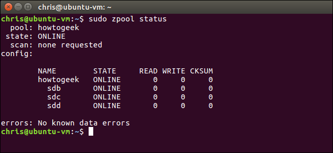

Here is a guide on installing Ubuntu onto a ZFS pool.
Installing Ubuntu onto ZFS is a little complicated, but you will notice that merely getting ZFS to work was easy. So, you could install Ubuntu to a USB (no ZFS, like how FreeBSD installs) and install ZFS on Ubuntu for managing only your storage drives rather than your boot drive.
Setting up storage and shares in ZFS is extremely easy. It is a dreamy file system to be sure. Well, you could have a little trouble if you are not familiar with addressing storage devices in Linux, but itt is not too bad. I don’t know how easy setting up the Plex server would be, though.
EDIT: Oops, that link is to a guide on installing and using ZFS on Ubuntu, not on Installing Ubuntu onto ZFS. This is the link that I meant to post, but the first link may be closer to what you want.
