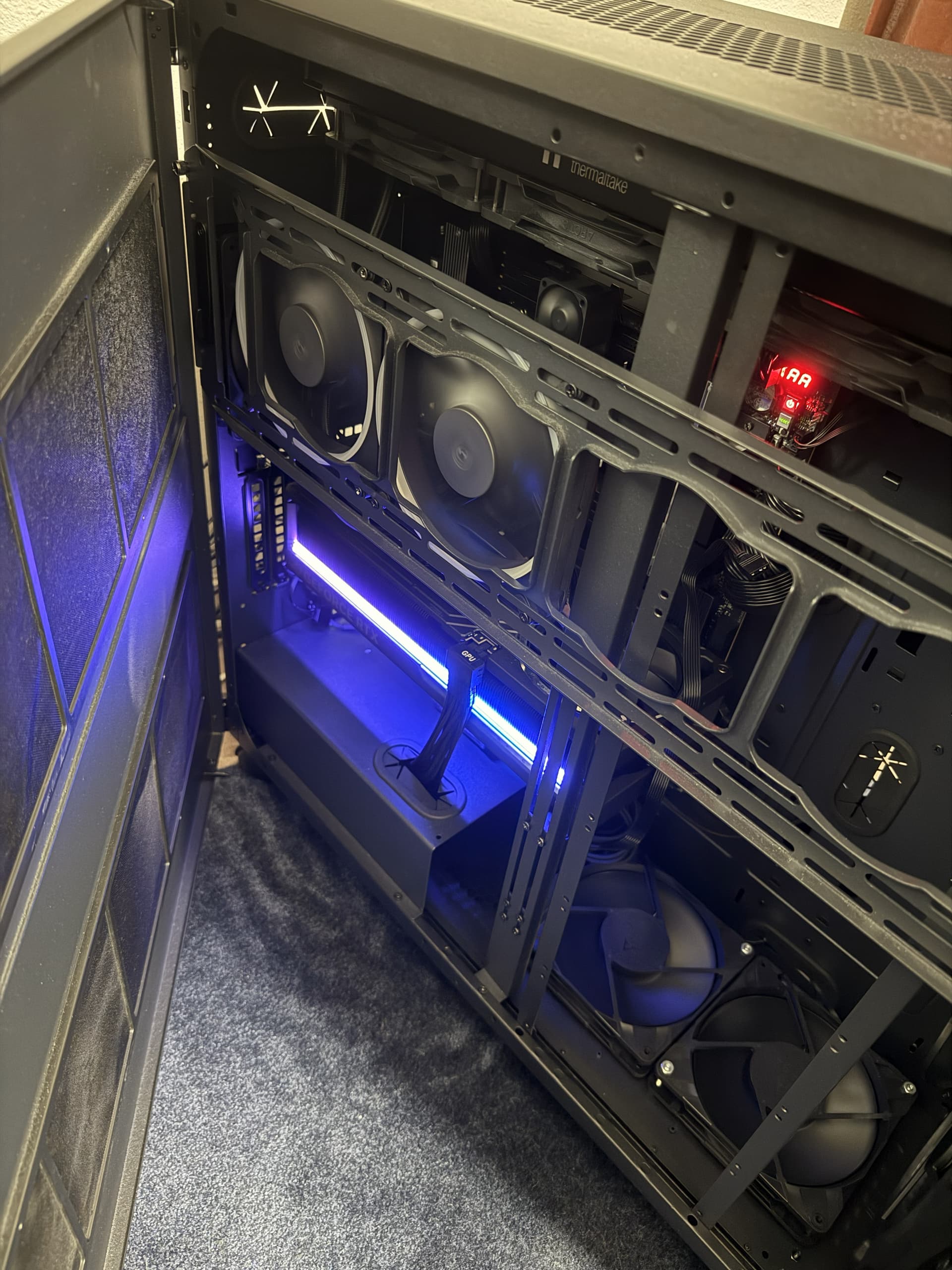

  1. I haven’t met any of those issues. My doors have latches, and I removed all the drive cages.

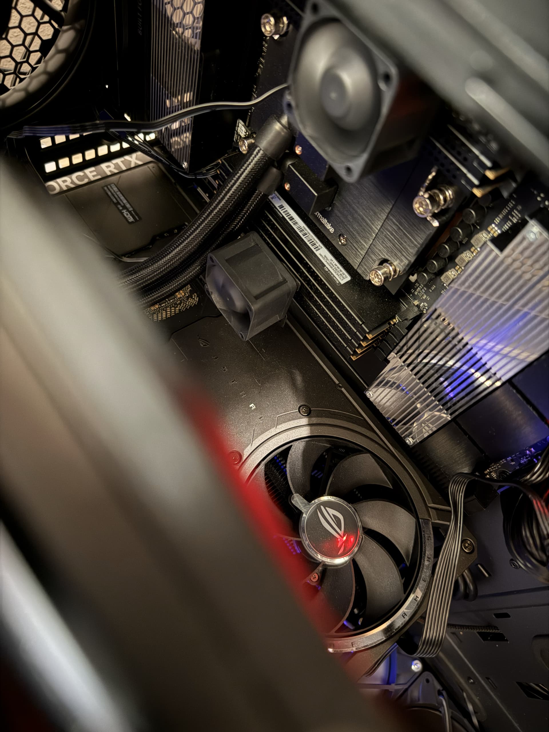

  1. Intake. I ended up adding 2x40mm 15000 RPM fans (on the Asus motherboard brackets), and the upper RAM was the hottest, so I replaced the vertical 2x140mm with 2x140mm horizontal (Fractal Design Momentum, which are the best across a grid, and are completely silent). Therefore, I removed the bottom fan support I added and only kept the top one.
FYI, the latest ZenTimings beta works with Shimada Peak.
CoreTemp as well, but the numbers are buggy under load.
The Arctic fans allowed me to build Chromium at 50C max, vs 70C before, so I can keep 65535 tREFI.
That was the old RAM, the new RAM is even colder, since it has no heatsink, so better air circulation between the sticks.
It’s in the 20es at idle.
