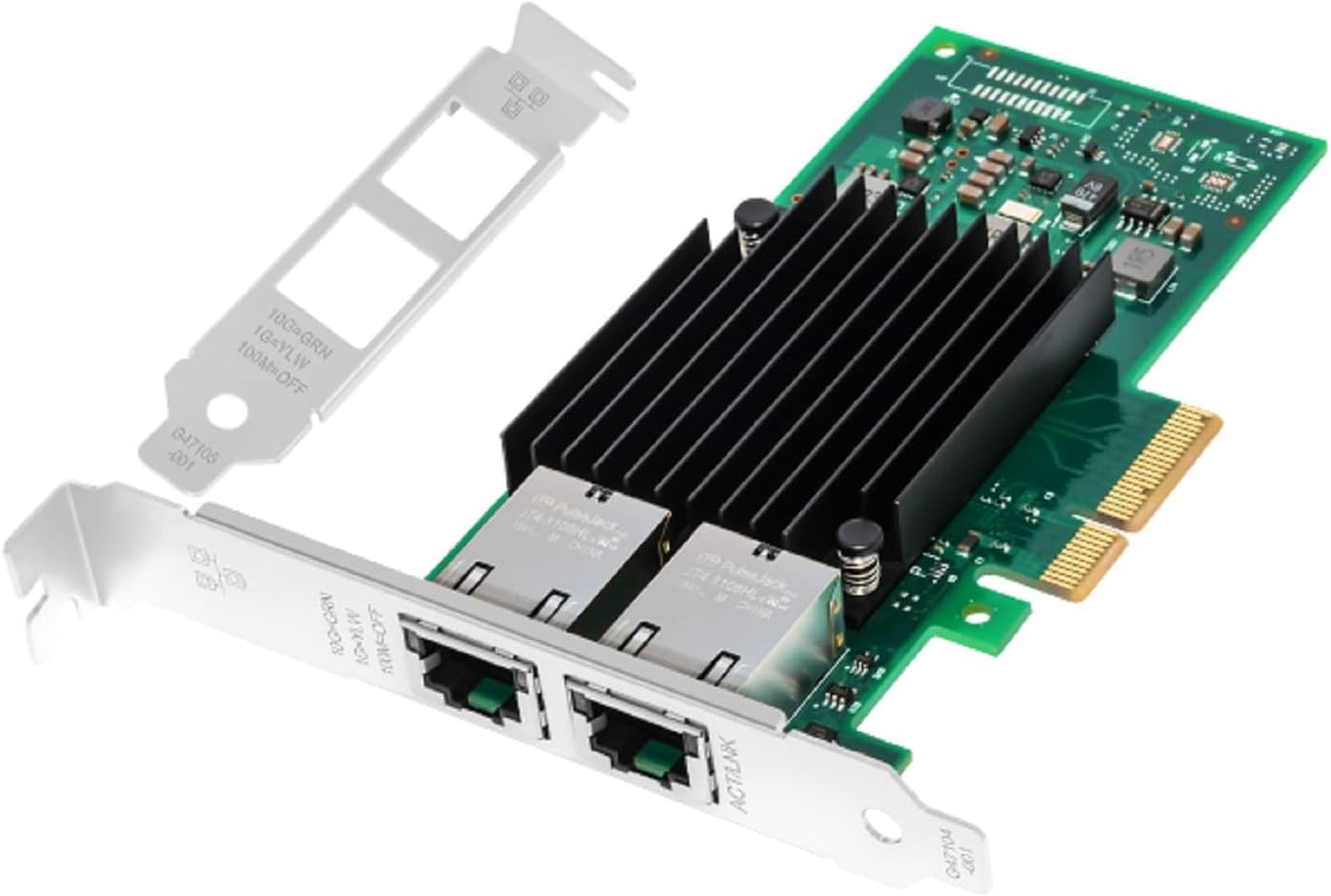

The openwrt router that i have been using was working perfectly but then it suddently just stopped functioning.I am using an Optiplex Turns out the Dual 10G nic I got off amazon for around 160 was no bueno. It literally just happend. I was working on my stuff while streaming and just like that the router went offline.
Openwrt is pretty rocksolid and kinda just works…makes sense considering so many routers use it…needless to say avoid this amazon nic at all cost.
It worked pefectly while it worked but for it to just die like that is shocking to me. It never was hot to the touch or anything. I wasn’t even hammering the card with 10g speeds. It literally just gave up… I am newer to netowrking but jeez…unreal.

Hardware failures are just part of life, the question is it worth the RMA process to you? In my case I’d say no. Also here is the 10G NIC that has been running well in my NAS for the last couple months:
How was the airflow? Typically nics like that require pretty good airflow as they are designed for rack mount servers in mind. You’ll see TechTubers strap little tiny fans on server type cards in their whitebox builds.

The airflow is pretty good. I have a literal fan just sitting in there at the moment lol .

I mean, if a BGA solder contact fails, it can just fail outright. Good one second, dead the next. If it’s not under warranty it could be interesting to pop the heatsink off and carefully inspect & research both the PCB and chip for authenticity.
Could be entirely unrelated. But for many years now there’s been videos documenting the salvaged chip industry where e-waste cards are processed, boards and chips are both salvaged and recombined into fake and/or authentic but salvaged parts that were then sold back into various online markets. Intel’s 10Gb NICs were a popular fake/salvage item given the sheer numbers and models used in servers and enterprise for 1-2 decades, as they were gradually sold used at attractive prices in the consumer markets as they were phased out. Made it real easy to pass salvaged and/or fake cards as regular used gear. Some years ago I was in the market for a 10G NIC for my NAS, and Intel’s old used cards were some of the cheapest that were compatible with Synology boxes. Then while researching them I discovered just how popular they were as fake and/or salvaged parts. Quickly found videos comparing fake Intel 10Gb PCBs to real ones, as well as fake chips on real PCBs. Still others were fully authentic but using salvaged components.

Very good information. I can look into this further. In general this phenomenon exist in many industries. That said if this was a “fake” nic it still was reaching all the necessary speeds and performing accordingly until it didn’t.
I think it failing out from solder joints or something is more likely.

Still, since you had mentioned ebay I figured it was worth mentioning. If you look at the cheapest ones on ebay you’ll probably start finding cards where the heatsink or PCB shape or components don’t match up with others of the same model. Was something I noticed when when I was trying to confirm authenticity to buy one. Finally got to the point I just waited a few months until someone put a used Synology 10G nic on ebay cheap and bought that instead.

Pop the heatsink off and reapply thermal paste. The heatsinks with only 2 diagonal pins tend to rock on the chip and dried out old thermal paste isn’t helping.
Well I already returned it but i will remember this for future reference!
