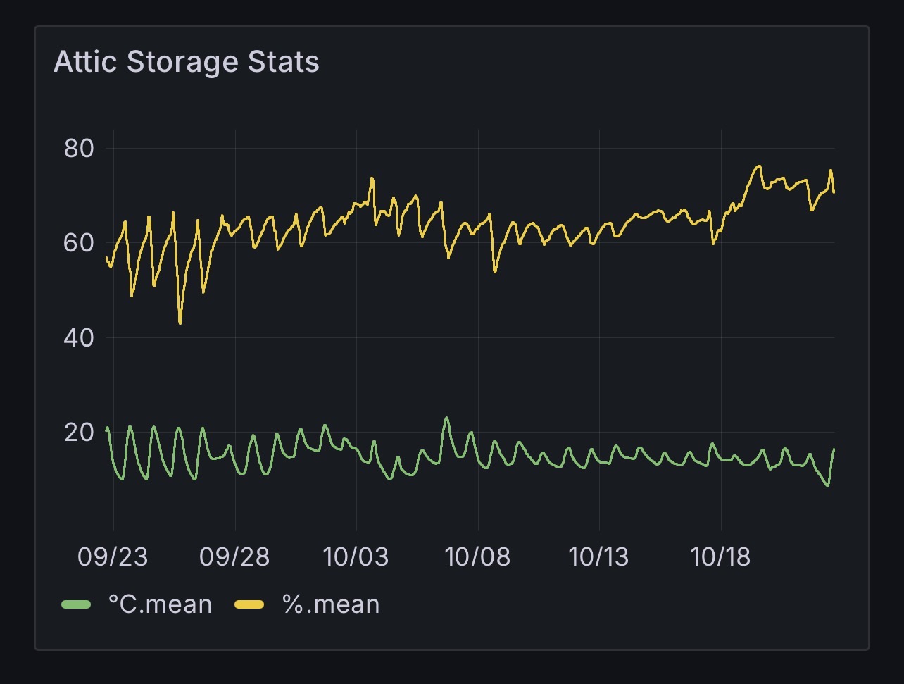

I put a temp probe into the attic and during autumn the temps swing between 11c to 20c on a sunny day, which is within archival temperature range, but the humidity is too high due to living in Ireland.

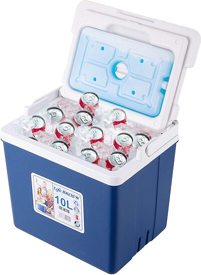

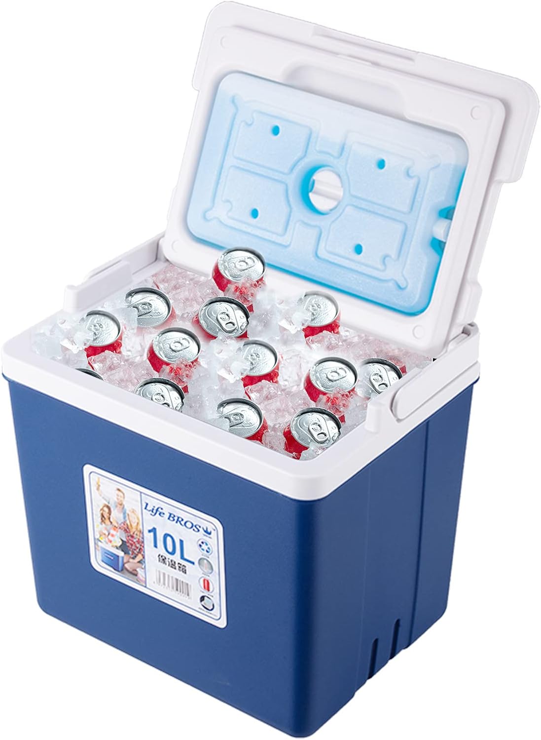

Wouldn’t a cooling box work?
Something along the lines like this?:
Considering they are meant to be sealed and insulated, thereby keeping the inside rather isolated from the outside?

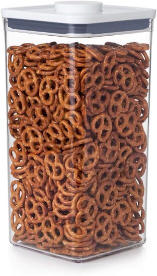

If you’re really determined to go guerrilla with your important data storage… Try sugar storage containers which seal tight, and don’t skimp on the silica:

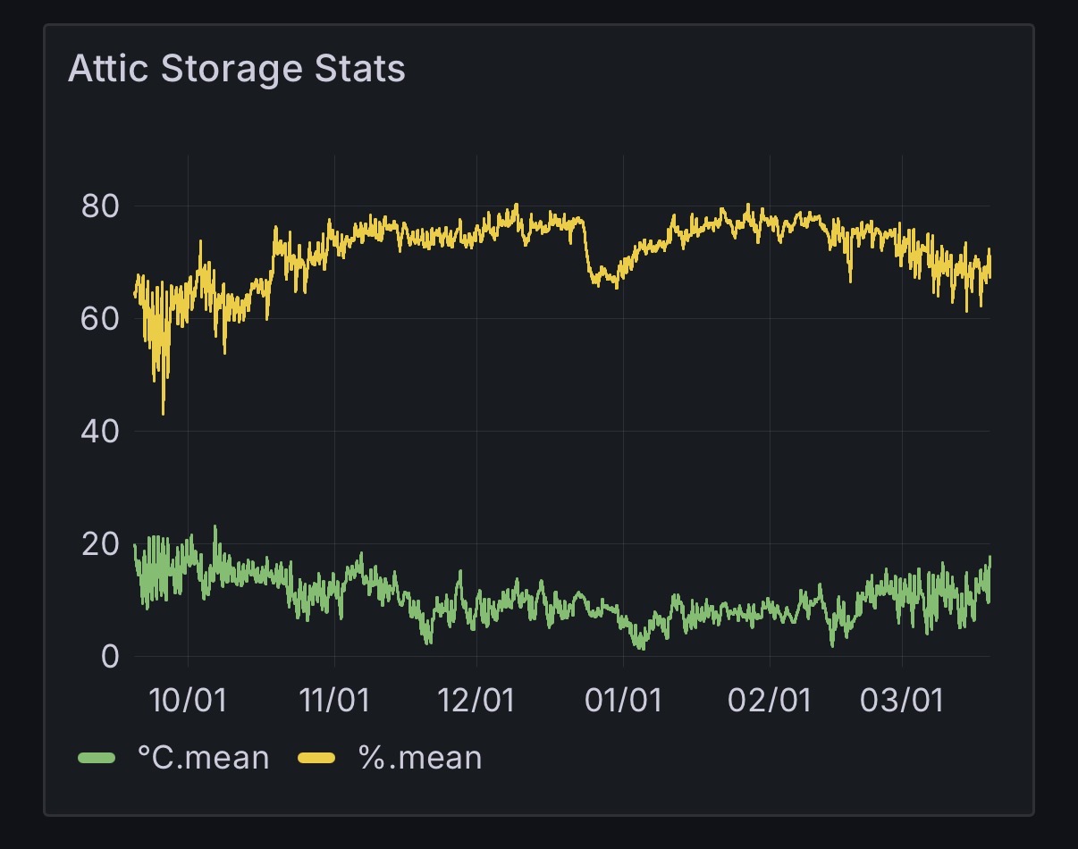

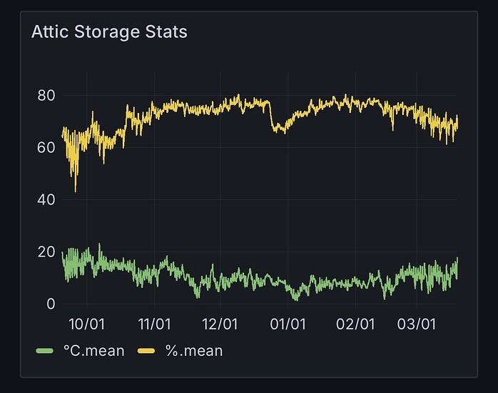

Now with the winter season approaching the end, I’ve got data on the experiment and the tl;dr is “Don’t.”
I grabbed an empty LTO case, put a zigbee thermal probe into it and put it in a vacuum seal bag used for printer filament with a large desiccant bag and then put it in a plastic container in the attic.
Looks like the seal either broke one month in due to the sharp corners on the case or the desiccant lasted for only one month from the graph. There was a hole in the bag and loss of vacuum seal.
So storing LTO tapes in the attic is a bad idea based on this data (if you live in an Irish/British like weather) and would eventually kill any tapes stored there.
