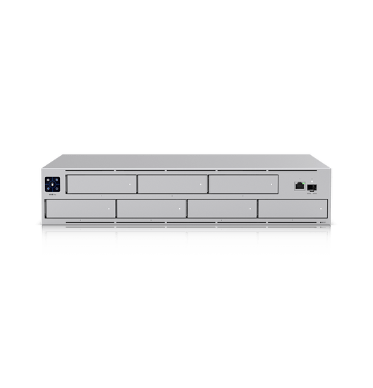

50 cameras is a lot. I would urge that you seriously look into the hardware requirements for running an NVR capable of handling that many cameras another option might be just using the UniFi NVR. I believe it supports a ton of cameras and if you need to run a windows machine for other software, you can just interface whatever you need to do with that windows machine and leave the actual NVR operation to the UniFi system.
