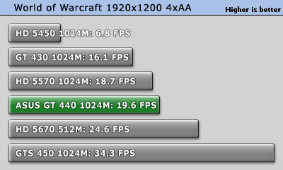

why do you need the 440gt?
you can get a cpu that has emmbeded graphics that will outperform a 440gt
http://www.techpowerup.com/reviews/ASUS/GeForce_GT_440/20.html
I need the 440GT because the hardware and software we are using requires a standalone graphics card thats DX11 capable. The 440GT is low power consumption and tiny so it fits our needs.

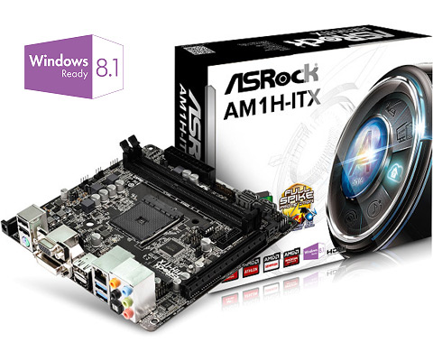

http://www.newegg.com/Product/Product.aspx?Item=N82E16813157491
This motherboard is available with support for either ATX or DC-In power supplies. DC-In jack can wisely replace a traditional power supply place, and thus easily PClizes any multimedia entertainments! Plus a 24-pin ATX power connector that meets any power supply and fits your PC requirement!

AWESOME THANKS! that's beautiful. Now I just have to find a case that can house it and the graphics card and be as small as possible. Any suggestions there?
