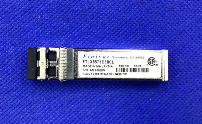

wish you’d asked this a few days earlier (or that I’d had the presence of mind to ask). just finished ordering parts for my own point-to-point fiber connection (desktop ←→ NAS):
seems EVERYONE recommends Mellanox ConnectX-2. Qain recommended the Finisar transceivers. Got the wall jacks only because… i’m running the fiber through the wall
hints (things i wish i’d figured out sooner than i did):
transceivers: look for 10GBE SFP+ “SR” or “SR/SW”. there are “XFP” transceivers that looked (to me, anyway) like they’d work, and were cheaper, but i was advised against risking it. (…after i’d ordered them.)
fiber: look for “LC” (connection type), “duplex” (two fibers), “multimode OM3 (or OM4)” (capable of 10GB). they’re aqua colored (orange cables are no good).

XFP are a larger module, they won’t fit in SFP slots, not to mention that they’re not electrically compatible either.

You don’t “NEED” matching transceivers. Just matching modes. (Single Mode or Multimode) it’s gets a little more complicated than that, but as long as the transceivers are the same mode and configuration you should be good. (getting a matching pair is easy)
I currently have a 1gb/10gb intel SFP+ transceiver connected to a 10Gb off brand. They work just fine.
