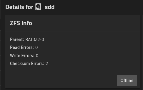

Need some help with zfs errors in truenas
Hi all, trying to figure out these ZFS errors I’m seeing in truenas and wanted to ask for advice here. I have 5 4TB ST4000NM0033-9ZM170 plugged into a HBA off aliexpress (INSPUR 9300-8I). These drives are… well used, they have about 8 years of power on time. They all pass SMART, at least I read it that way. The HBA is plugged into a Lenovo m920q with the riser card option. At first I thought it was a power problem since I have 4 on one external 12v PSU and the other 4 on another PSU, one does 10a and one does 8a (slightly overloaded in terms of spec for 4 drives). An example of this was sdc and sdd both said they faulted, but when I switched the power cable to the more beefy psu, the faults went away entirely on one drive, the other drive had 2 checksum errors. The image below shows what it looks like now after being on the properly spec’d PSU, before it had Write errors.

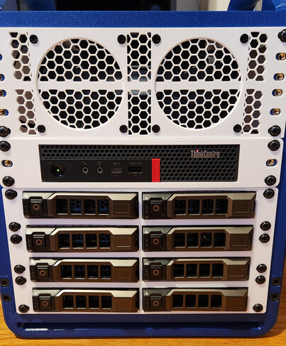

The current drive array looks like this where each side has its own PSU:
Left Right
HDD SSD
HDD SSD
HDD
HDD HDD
The drive that has the checksum errors is on the left.

I would love some ideas on if the drives are usable or what the issue may be.

All, thank you for the input. This is a new install on these drives, so no data is lost luckily. The plan is for this to be a NVR with frigate.
Here is the zpool status. My next plan it to grab a higher rater PSU so that both are 10a and continue testing. As suggested below, I will clear errors and see if it reappears after writing some junk data to it.
errors: No known data errors
  pool: nvr-pool
 state: ONLINE
status: One or more devices has experienced an unrecoverable error.  An
        attempt was made to correct the error.  Applications are unaffected.
action: Determine if the device needs to be replaced, and clear the errors
        using 'zpool clear' or replace the device with 'zpool replace'.
   see: https://openzfs.github.io/openzfs-docs/msg/ZFS-8000-9P
  scan: resilvered 17.9M in 00:00:01 with 0 errors on Sun Sep 27 13:16:00 2026
expand: expanded raidz2-0 copied 3.88G in 00:00:25, on Sun Sep 20 04:41:19 2026
config:
        NAME                                      STATE     READ WRITE CKSUM
        nvr-pool                                  ONLINE       0     0     0
          raidz2-0                                ONLINE       0     0     0
            03c9269c-12d9-482e-885c-e1860cdaee48  ONLINE       0     0     0
            306eef6f-0b2a-4c04-8cab-80e8ba2727d6  ONLINE       0     0     0
            b173596c-0e64-41c9-8890-05ee4b18343b  ONLINE       0     0     2
            e2b25ffa-0b37-4e70-b7b0-c1bf01b28b79  ONLINE       0     0     0
            14022598-fd4b-49b0-a487-4522029b5618  ONLINE       0     0     0
all fine. I’d go for the zpool clear option. Error was self-healed by ZFS thanks to your redundancy (Z2)
e.g. zpool clear nvr-pool
